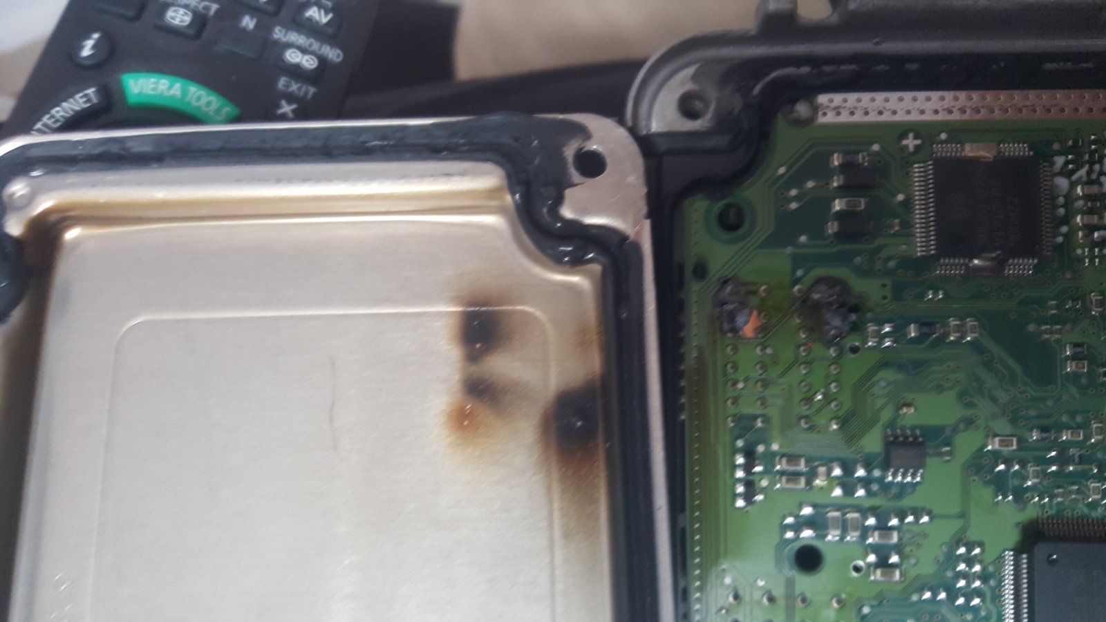

Took ecu apart , was cooked !!
On hunt for matched set of..... me745 ecu/bsi and keys .
Thanks wheeler for your input, got there in end,

Oh dear, any signs of any arcing on the outside casing?
I thought when you originally said you inspected the ECU with a magnifying glass you meant the PCB??

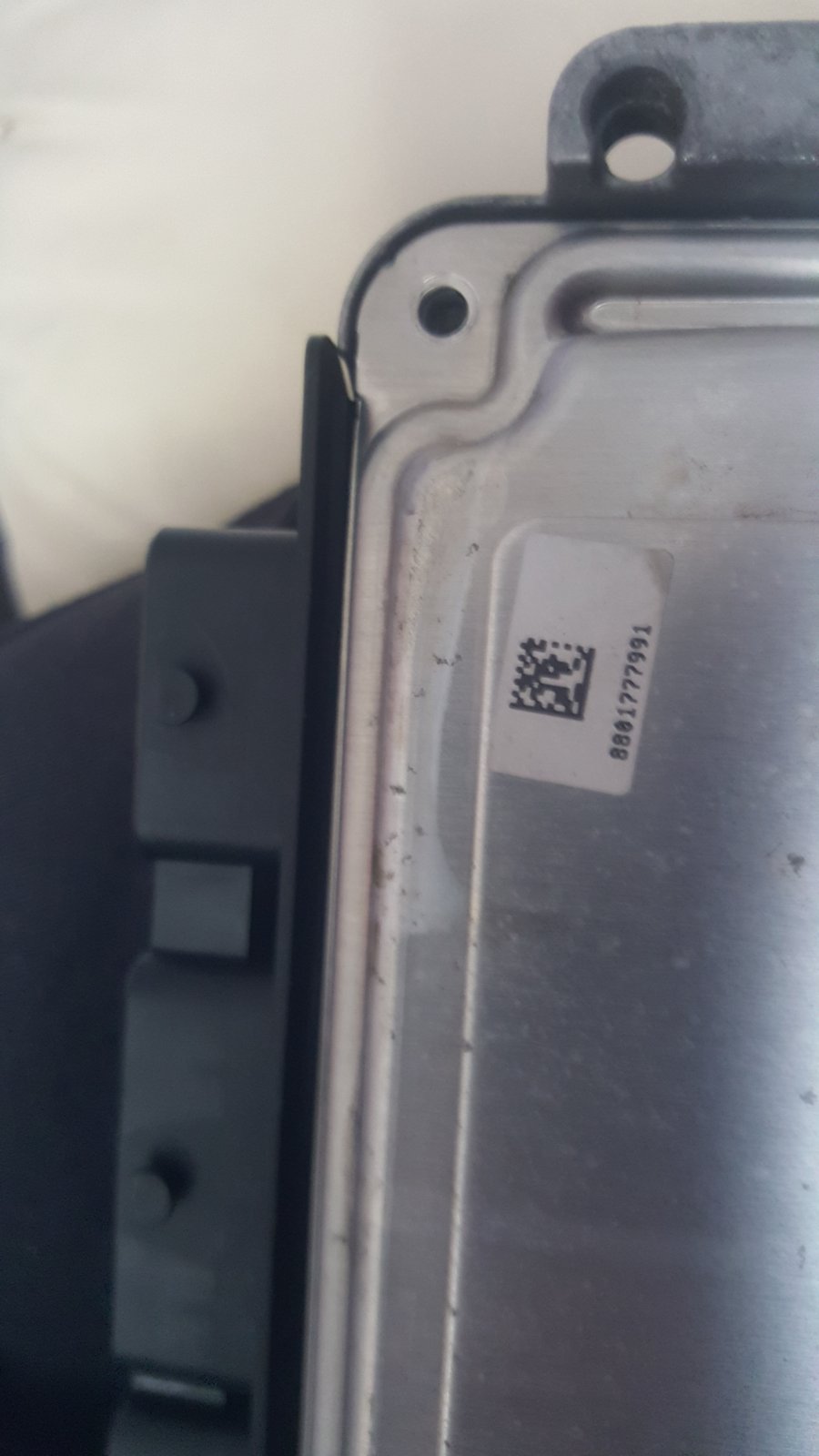

The outer casing on first appearance , to me ,seemed fine..
After i opened casing and saw damage inside i relooked at case, and there was a slight change of colour , slightly lighter grey, in area adjacent to inside damage,which was not what i was looking for on arcing damage, i am suprised at the lack of clearly visual damage outside the caseing compared to the carnage inside !
But this car was bought as a project/ learning exercise to learn more about electrickery on petrol engines, and Ive learnt a lot already and am enjoying the challenge !

Re: bought a 2008 xsara picasso 1.6vtx 16v non starter cheap
When the ecu is plugged in does the marks on the outer casing line up perfectly with the positive jump post nut by any chance if you stretch it over??
The mark on the cover is near the post but there would be a gap between this cover and the bolted on support mount, there is no mark on the mounting bracket which would be the part that hits the positive post ? Maybe it earths through the mounting plate via the holding bolts and into the ecu and blows out wards , hence the burn marks inside the back ecu cover
