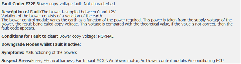

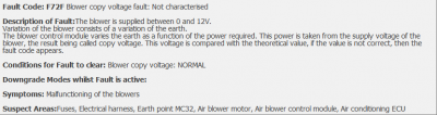

Hi All,
Looking for somebody to correct me if I am wrong about how the speed is varied on the air blower.
This is done by varying the signal from the switch through the module to air blower.
Looking at the wiring the signal is sent via the signal wire no 2 on the module through the earth no 3 to the blower depending on signal strength determines the speed of the motor.
Sorry guys but don't know how to cut the wiring diagram and paste the appropriate portion to this post.
If any moderator can assist I would be grateful.
All thoughts and replies please
Kenny
Kenny

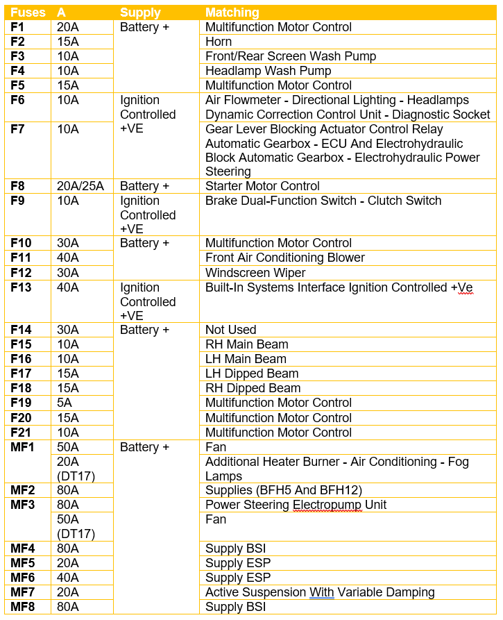

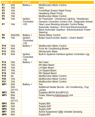

Looking for up to date diagram for the engine compartment fuse box (PSF1). I believe the one I am using is an earlier version
Interesting update, this morning when defrosting C5 I put the A/C ,front and rear demisters on, the blower ran for approx 1-2 seconds full blast then dropped back to a lower setting.
I found an older post re problems with fan running on high speed and Marc posted about 2 fuses in PSF1 fuse 10 and 11 , multifunction motor control and A/C.
What purpose does fuse 10 have ?
In my handbook it lists this as Actuator motor also listed F19,F20,F21 Actuator motors.
Could F10 be my problem and where is it in the wiring diagram.
Kenny
Kenny
C3 1.4 petrol (SWMBO)
- x 6945
Re: No heating/Air conditioning - Baffled
Here you are Kenny:
Click to Zoom
Click to Zoom
KennyW
- Posts: 2615
- Joined: 17 Jan 2006, 21:22
- x 165
Thanks Marc,
Getting more and more perplexed by this issue.
But will keep trying
Kenny
Kenny

- Posts: 12596
- x 1489
Kenny
What voltages / continuity have you measured / checked?
My reading of the wiring diagram is that the switching is on the earth side - there doesn't appear to be a fuse for the main fan supply, F11 controls the relay that pulls in the power supply to the fan / controller - if this was kaput you wouldn't get anything. If you've got an analogue volt meter (or even better a scope!) you should be able to measure:
12V on the fan pin 2, once the engine is running - probably red wire
12V on pin 4 at the controller (this is from the same feed as the fan)
Continuity from pin 1 on the fan to pin 3 on the controller (this is the earth side)
Continuity from pin 1 on controller to earth
If you measure the voltage between pins 4 and 3 on the controller this should vary as the fan speed request is changed - higher voltage for higher speed request. A digitial meter may not show this, hence really needing an analogue meter here. Similarly if you measure the voltage between pin 2 and 1 on the controller it should vary as the speed request is changed, again increasing as the speed is increased - this may only be a 5V signal, not a 12V one.
Update,
If you bridge wires 1 & 3 on module control fan runs at full speed therefore supply and earth working correctly
12 v at supply feed to module control
Continuity at pin 1 to earth module control
Continuity to earth pin 3 module control
But when measuring between pin 3 and pin 4 no voltage variation
Likewise
Pin 1 and 2 random voltage variation, not increasing as switch control is turned up form low to high (temp).
My interpretation is the signal wire would appear to be faulty.
As per the description given in the above.
Next take the block connector off the climate ecu and test for continuity.
Hopefully this will identify the wire as faulty.
Kenny
Likewise
Kenny
