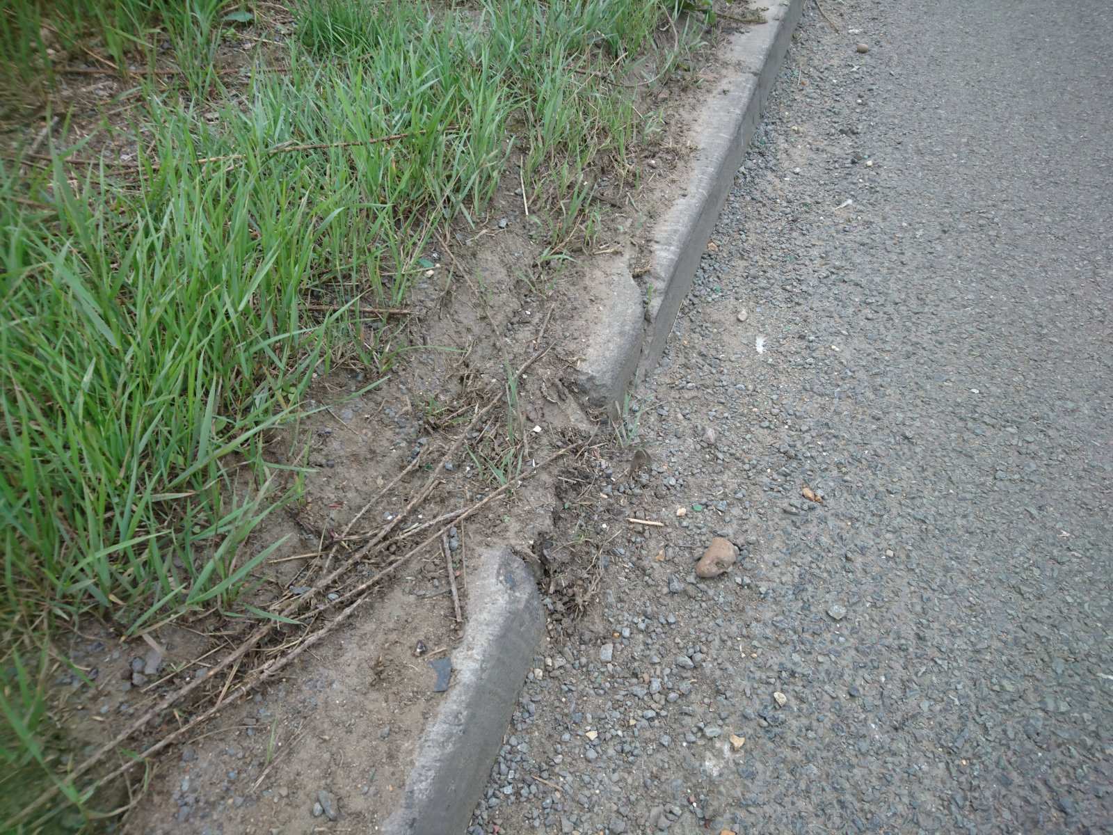

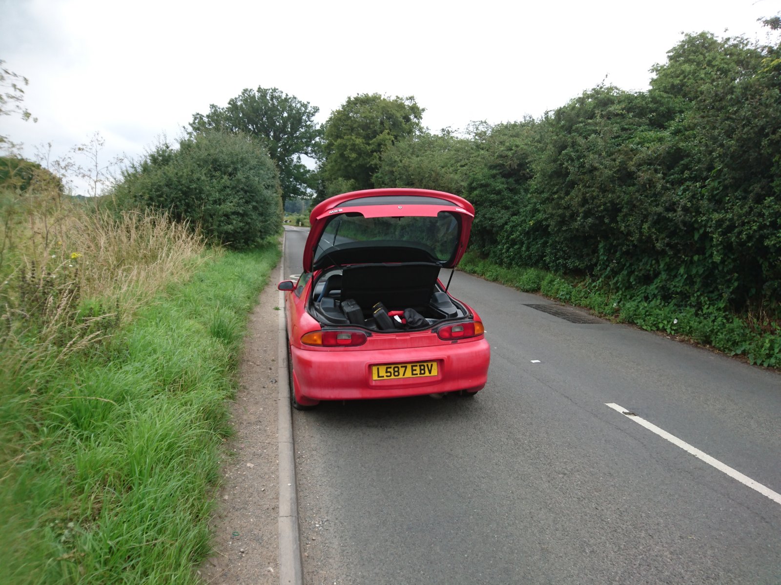

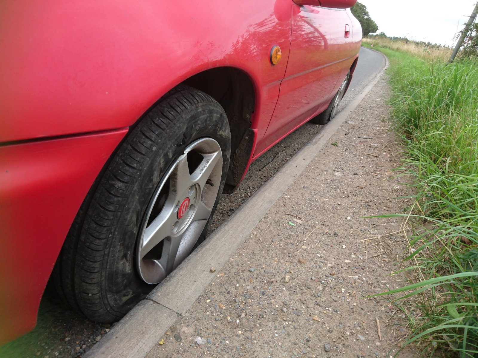

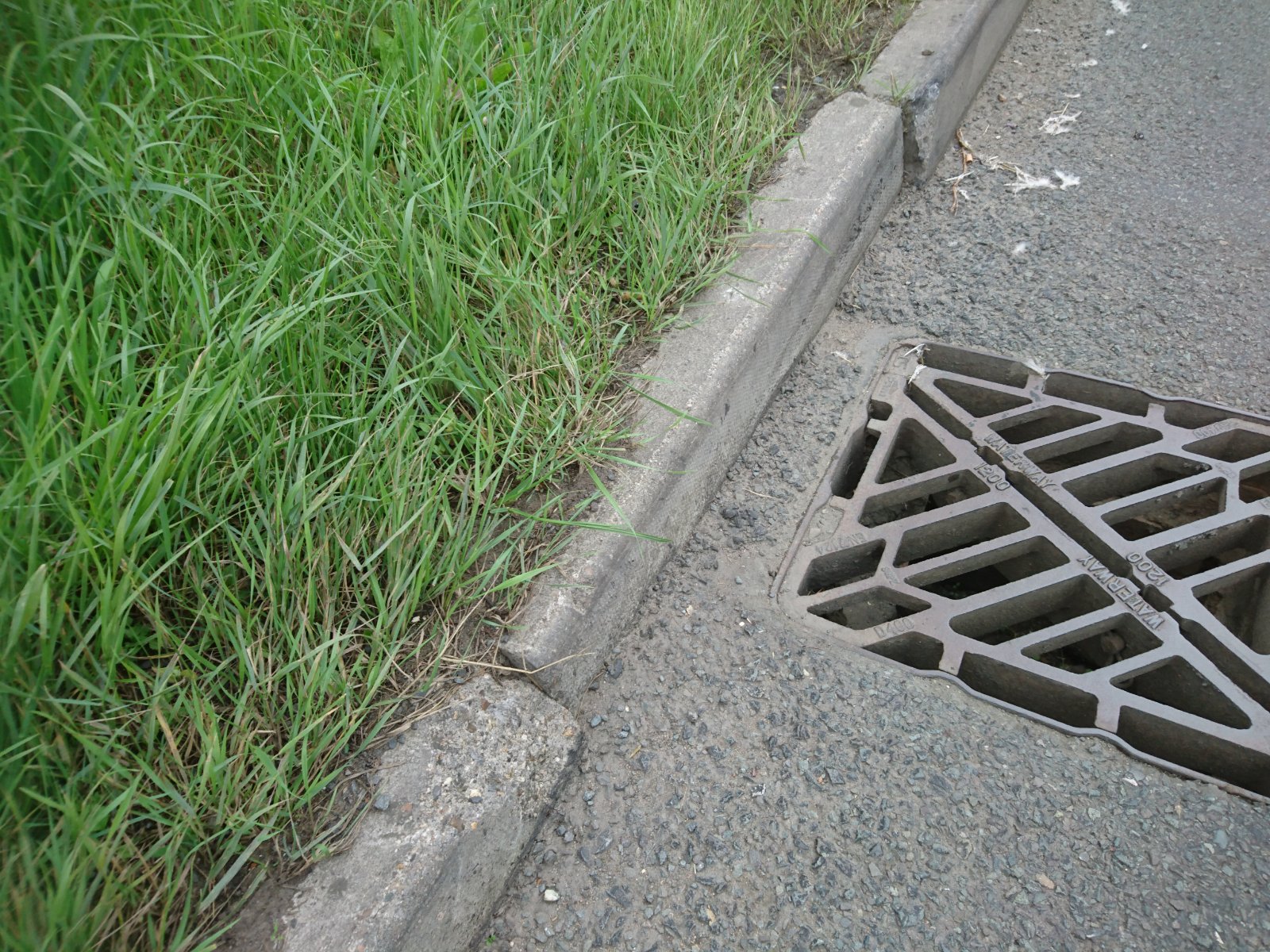

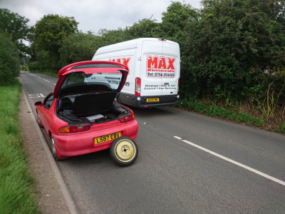

As mentioned on POTD earlier I had a little tyre related mishap today. On my way to Elstree the lane I use has a fairly open left right S bend. As I exited the left part of the bend I was confronted with an Audi in the middle of the road overtaking a cyclist as he came round his left hand (my right hand) section of the bend. I had 3 choices, hit the Audi head on, swerve right and probably take out the cyclist (tempting
) or swerve left into the kerb and field beyond. Unsurprisingly I chose the third option and hauled the wheel left ramming the not insignificant kerb at about 35mph. I will leave the rest of the photos to finish the story!!
So as you can see the MX3 now has two badly damaged wheels which also resulted in cracks in the wheelnuts on 3 nuts and a complete shattering of a fourth. As a result I have decided to cut my losses and source another set of original alloys to replace the current after market ones whose nuts are decidedly questionable. Whether the cracking was a result of the impact or of an over zealous tyre mechanics gun, I honestly don't know but to be safe I have decided to replace all four wheels with new nuts all round. Having had a good result recently with the replacement Subaru wheels I am now on the lookout for a set of 14" alloys with four studs at 70mm centres.!!
I have to say I believe the Audi driver may have been going so fast that he was round the next part of the bend before I had stopped as I effectively struck the kerb then ran down against it hitting the already broken section and wrecking both tyres. Consequently he knew of no reason to stop and may have just assumed that I had run onto the verge to avoid a collision and then carried on my way. As I looked in the mirror I saw the disappearing yellow of the cyclist also going round the bend and I was not exactly happy!! He must have seen and heard the two bangs yet he didn't bother to stop incase there was anything really wrong.
I am afraid to say for the cycling fraternity here that this incident only serves to strengthen my belief that cycling along country roads at rush hours is just not sensible, unless of course they are using the bike for transport rather than for enjoyment!!

Yes thanks Marc, at least having fitted my space saver and a spare from the AA man I drove the car home cautiously and the steering and suspension all felt perfectly normal with no pull or vibration. We inspected the track control arm and trailing arm and they were both straight. The rack felt completely normal and I inspected the seals and no visible leaks anywhere. Hopefully it will all be ok but once I have sourced and fitted a replacement set of wheels and wheel nuts I will take it to our mancave and do a 4 wheel alignment. We have access to the equipment from my mate's neighbour when needed!!GiveMeABreak wrote: 15 Jul 2021, 21:42 I'd also get the suspension geometry checked out Mick - tracking for sure, but an overall check to make sure the rack or other parts aren't suffering from impact damage.
