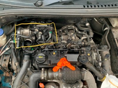

The nut has dropped to the bottom- it seems injector number 4 has made my life more difficult. The other three I could roll the nut back up but this one is obscured by other parts. Don’t want to remove them but I don’t see another way

Looks like these will be coming off tomorrow- this is becoming a right pain!

Back on the road! Thanks all for your help

Excellent news. How did you get round the injector pipe problem?
I'm right behind you doing our 308's injector swap. I've just dived inside to avoid the rain shower otherwise I'd be finishing off.

A magnet underneath to get the nut round the first bend and then it can be removed from the top. Stupid design.
