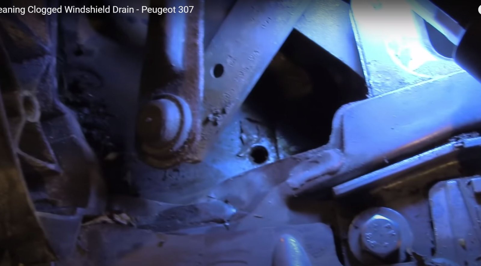

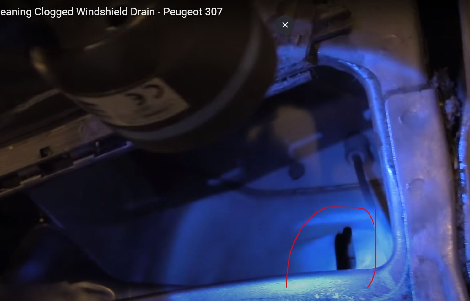

I found a video on a 307 that suggests there may be two drain holes each side, a large one closer to the windscreen and a smaller one under the wipers.
Is this the same on the 407 ?
After a couple of sunny 35 C plus days, seems the air bag warning light is staying off, carpets are dry and so now to check the scuttle drain properly.
- x 6945
Re: Airbag, Dashboard, Seat Belt & Airbag ECU Repairs
You'll have to investigate as this level of detail is not shown on parts

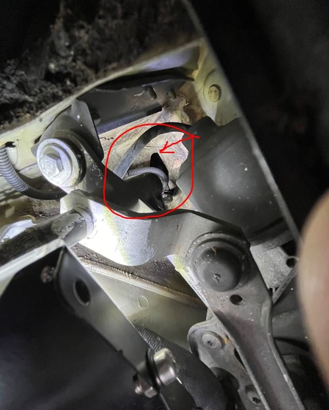

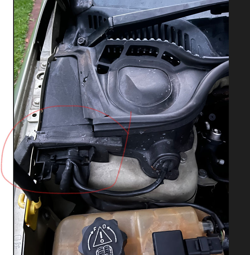

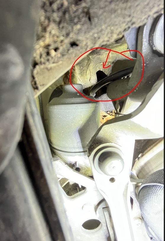

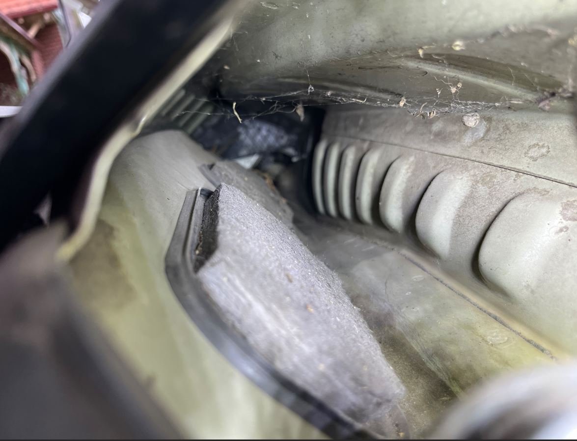

I've pulled the scuttle panel off the 407 and below are the pics. Took around 10 mins but I had removed the wipers before and know they are likely to a problem getting off.
No real debris inside but there were a few leaves but doubt they would cause an issue.
There is only one drain hole that I could see either side.

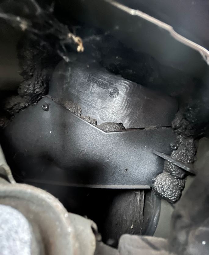

There is a space / chanel that runs under the windscreen and appears to fall / drain towards the driver's side drain. It also has a few oval bits of what looks like insulation but does not look like it gets wet. Can't work out why they are there
Looking at it from the driver side it is sort of blocked off by a black plastic unit - not sure what it is
I ran a hose at full bore into both drains and they did not full up, so assume they are draining under the car (and not into the car ) - lots of water coming out from under the front wheels.
Any other area water might get in ?

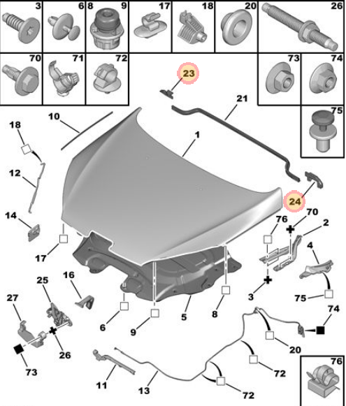

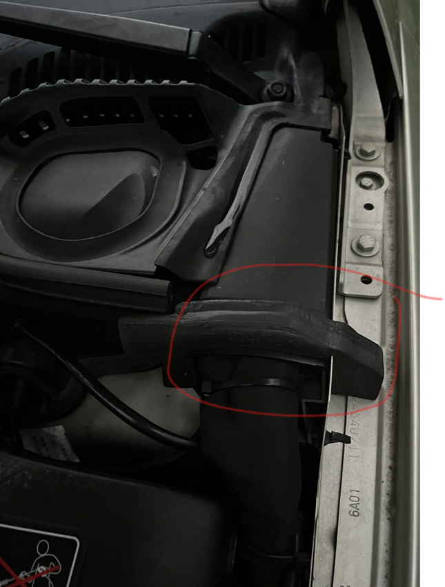

Those bits at the sides are likely, 23 & 24, the bonnet side seals:

I suspect parts 23 and 24 are the foam bits of rubber that are sort of part of #21 on tip of the firewall - see pics
The empty space area I was looking at it under the windscreen and the black part looks like its part of the airconditioner air circuit / fans. It looks dry and there no telltale signs of water

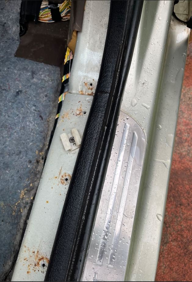

I peeled the front driver carpets back and the underlay was still pretty wet so left it to dry (rained a few days ago).
It did rain overnight (not a lot) and I did notice that the the area you identified seem to be pretty wet and had a build up of grim , suggesting that water is running down the door and then maybe into the car over the furry seal lip - see pics
It maybe that the furry lip seal is working but water is entering higher up past the seal and then damming over the top of the seal and so into the car
No other obvious water drips say from the front firewall area

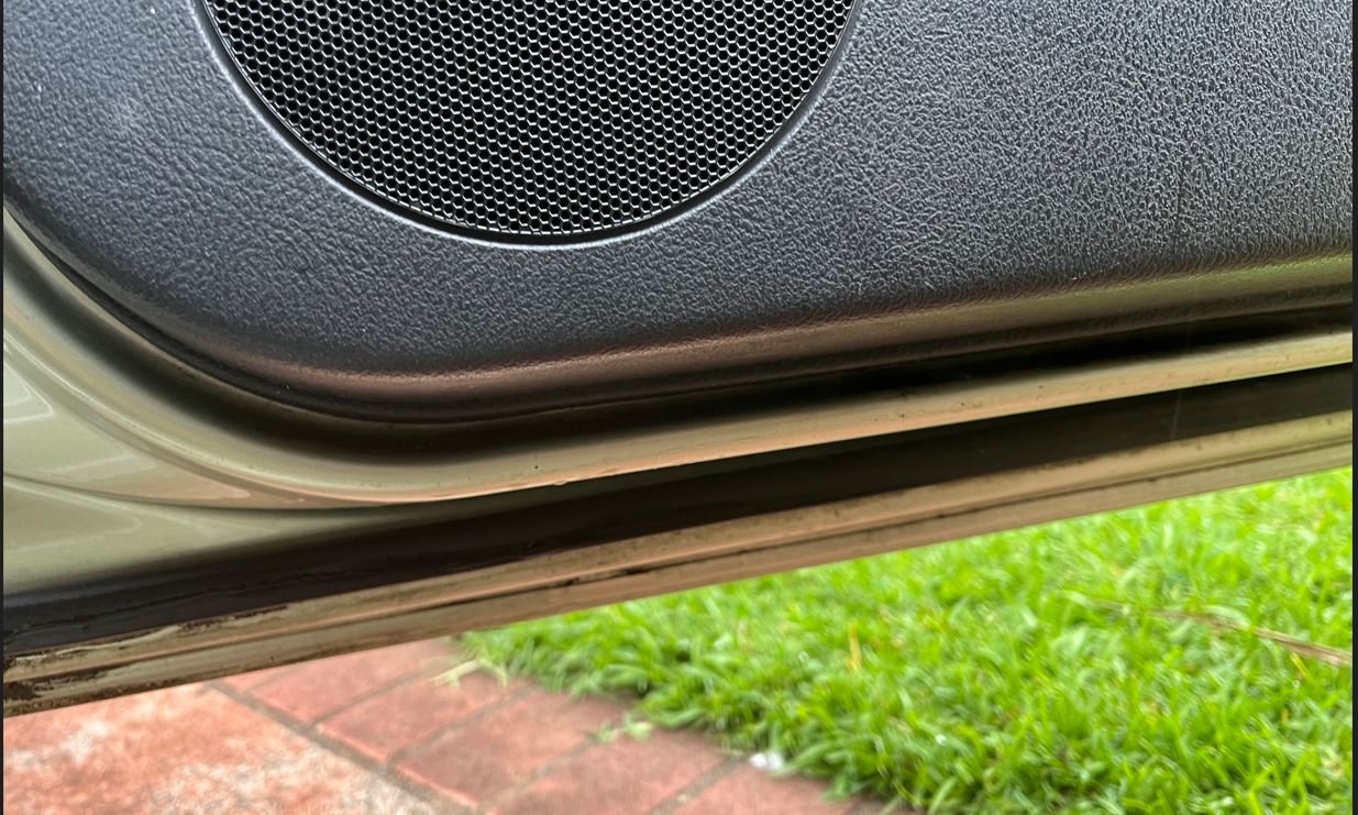

On your solution, I assume pad it out means add something like a self adhesive weather strip under the lip of the rubber seal eg to pad it out.
I also thought about also making a cut somewhere higher and trying to slip / push a round foam bead into it, and the resealing the cut hole with super glue.

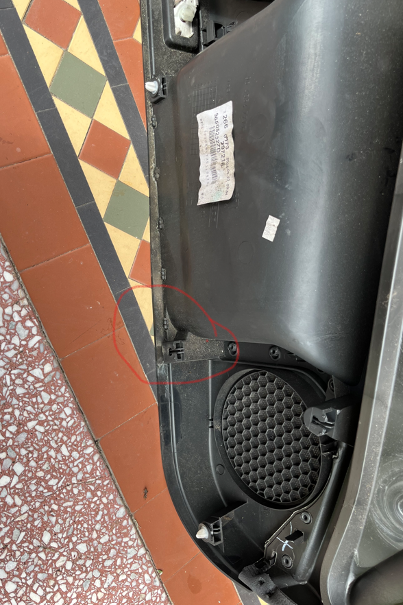

Also maybe using the self adhesive weather strip on the door itself ((see pic with speaker) , but might need to run it almost around the whole door to avoid create a gap somewhere.
Finally, I'm wondering if the water in coming in the car door itself, maybe entering near e tip of the door and running down the inside of the seals ? I may have to pull the door panel off to see if its got any rubbish it in or if the water proofing plastic sheet has a hole or has been removed.
Any other suggestions ?

I did forget to mention the most obvious thing, which is check the drain holes on the underside of the doors. There should be a drain hole on each door, than can get blocked, which leads to an accumulation of water, that, when the door is then closed sloshes out into the footwell. The hole should be clear and unblocked to allow water from rain and washing getting in from the window channels etc to evacuate, but as with everything, tree sap and general debris can also accumulate blocking the holes.
If you can't locate a drain hole, there should be a sill seal running along the underside that can be gently unplgged to allow any water to drain out. See picture for small lugs that pop into the holes int he door to fix it:

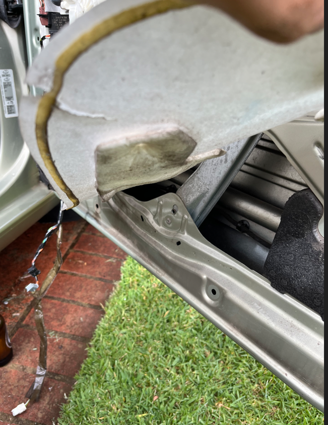

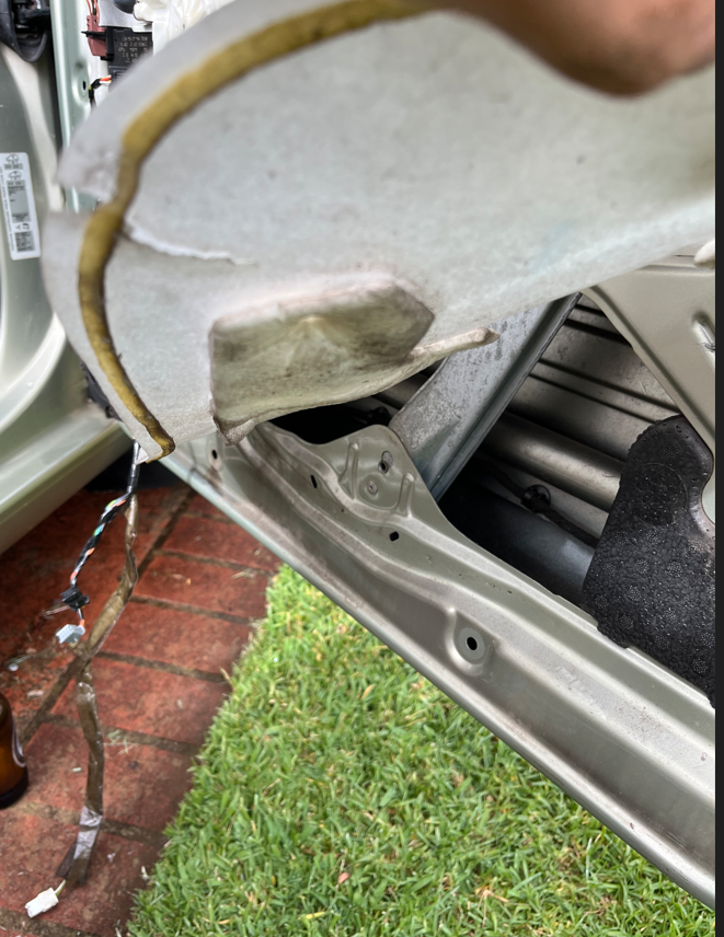

I spent some more time on sourcing the leak and may have found it.

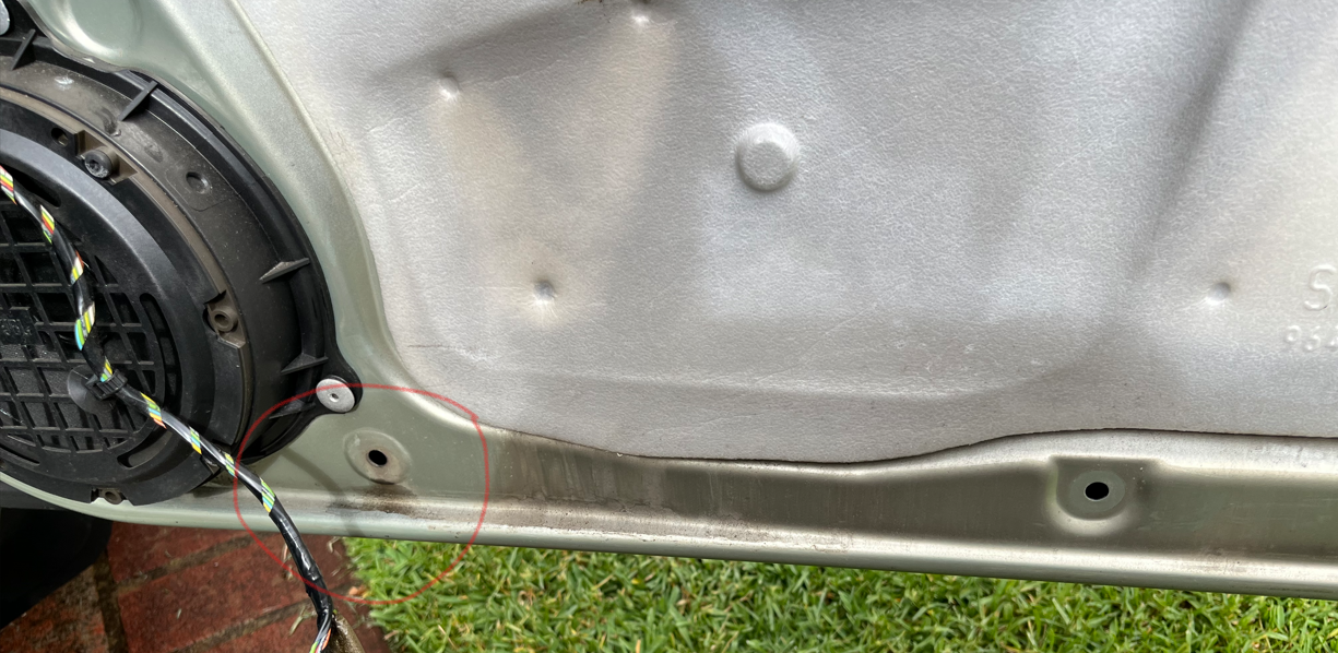

I showered the drivers door window so water would get inside the door (like when it rains) and when I open the door, I found a a few drops of water above the seal on the door itself, around 10 cm from the front of the door.
Drain holes on the bottom of the door were clean and lots of water came out.
When I took the door card off, I noticed
a) it was missing one of the sealed press clips; and
b) the white water proofing foam was loose as the glue had given way.
I had a few spare sealed press clips so replaced all the bottom ones and also siliconed the white foam back to seal the door card from water
I suspect that every time it rains (eg all day/ night most times), the water ran inside the door and pooled thru the missing press clip hole onto the bottom seal, and then spilled into the car as the bottom seal was too good.
I've tested it with a hose and seems dry but we have a few days of rain planned.
Hope this helps someone (and fixes the water leak).
Good, that sounds like you've nailed it now.
