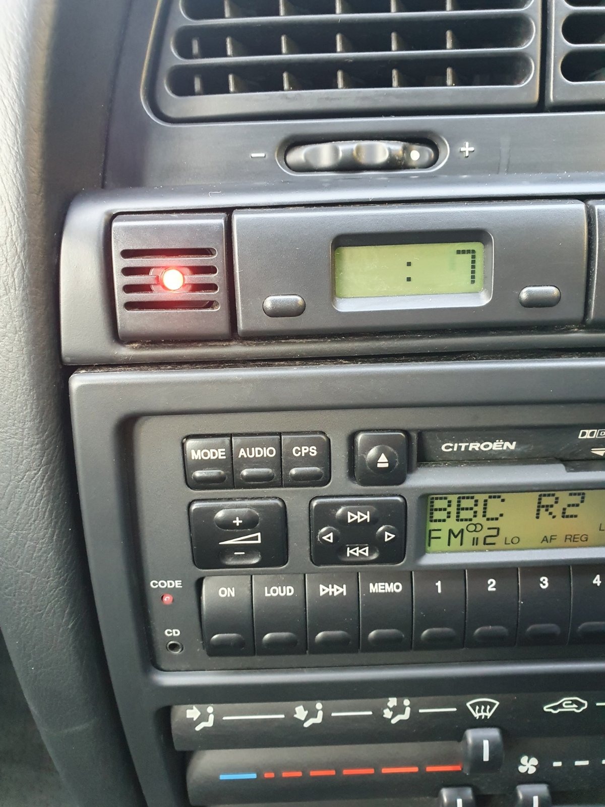

Any ideas why this light is always on?
Has been since I've had the car

I must look for a clock for you Liam... I'm sure I have one...
The alarm light being always on may be connected with why the Central Locking/Alarm module was disconnected... I should know but I'm not cognitively good currently
Did the alarm light only come on when you plugged the Central Locking/Alarm ECU back in?
I may have a spare Central Locking/Alarm ECU here too...
Where do you live? If not too far from me you are welcome to come and see me, have a session of ELIT diagnostics and raid my spares stash for stuff you may need...

The alarm light has been on ever since I've had the car, and probably long before!

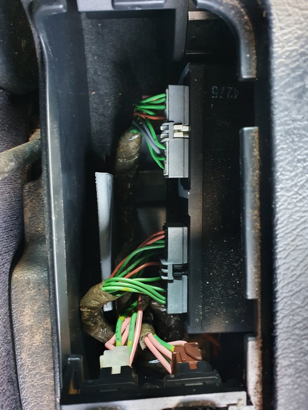

I think I need to get to the alarm module under the seat and see if its been wet. The nsr window wasn't fully closed when I got it which may have been why it was both mouldy and full of leaves
I'm between Ilkley and Bingley in West Yorkshire

Ahh yes, that's tripped my memory! If you look under the passenger footwell carpet you'll find a multi-way connector under a plastic cover in the corner of the footwell near the bottom of the A Pillar... This connector corrodes badly if there's any damp under there and often it's swimming under the footwell carpets due to windscreen scuttle panel leaks... A very common fault - do a search on itCento16v wrote: 04 May 2021, 06:52 I think I need to get to the alarm module under the seat and see if its been wet. The nsr window wasn't fully closed when I got it which may have been why it was both mouldy and full of leaves![]()
If this connector is corroded it'll upset the alarm system and often the central locking too... It carries a lot of wiring for both...
