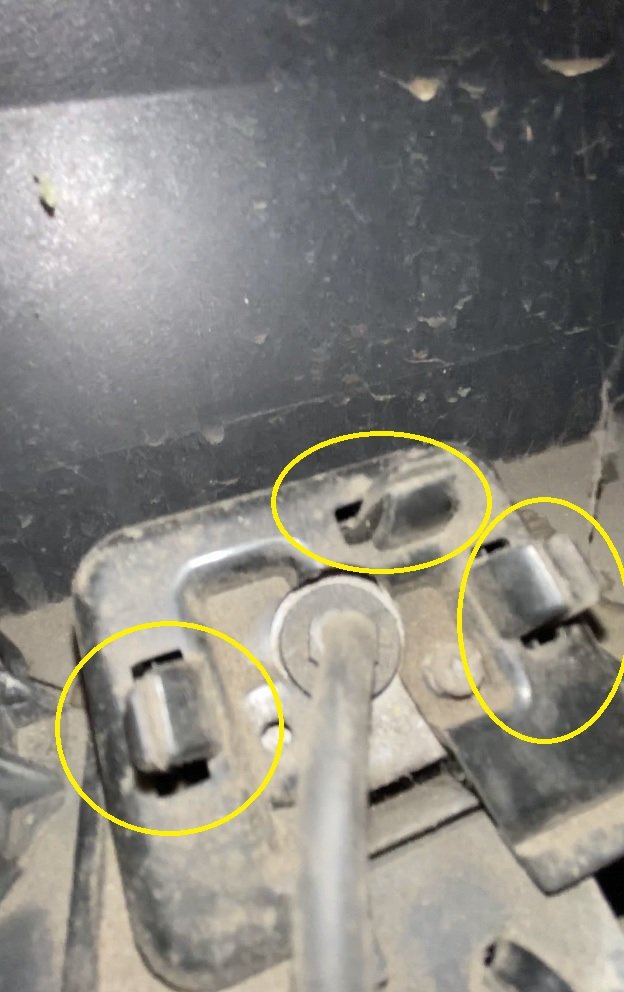

1. You can lay down underneath the rear bumper (if the car is a bit raised up it is easier of course) and access the camera with one hand
2. Once you reached it, it can be easily pushed out only by pressing the 3 clips circled in yellow color on below picture (NO NEED TO REMOVE THE TORX SCREW), the other hand pushing the camera from the outside to the inside of the bumper :

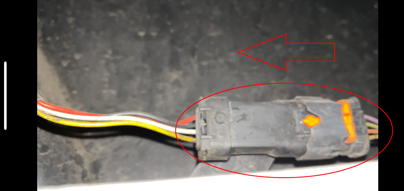

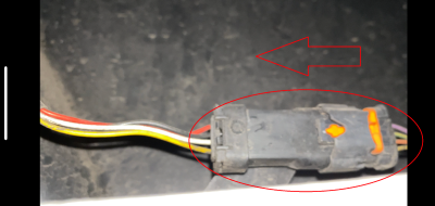

4. Slide the connectors from the right to the left to unattach them from the bumper :

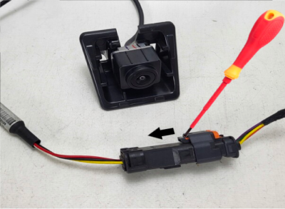

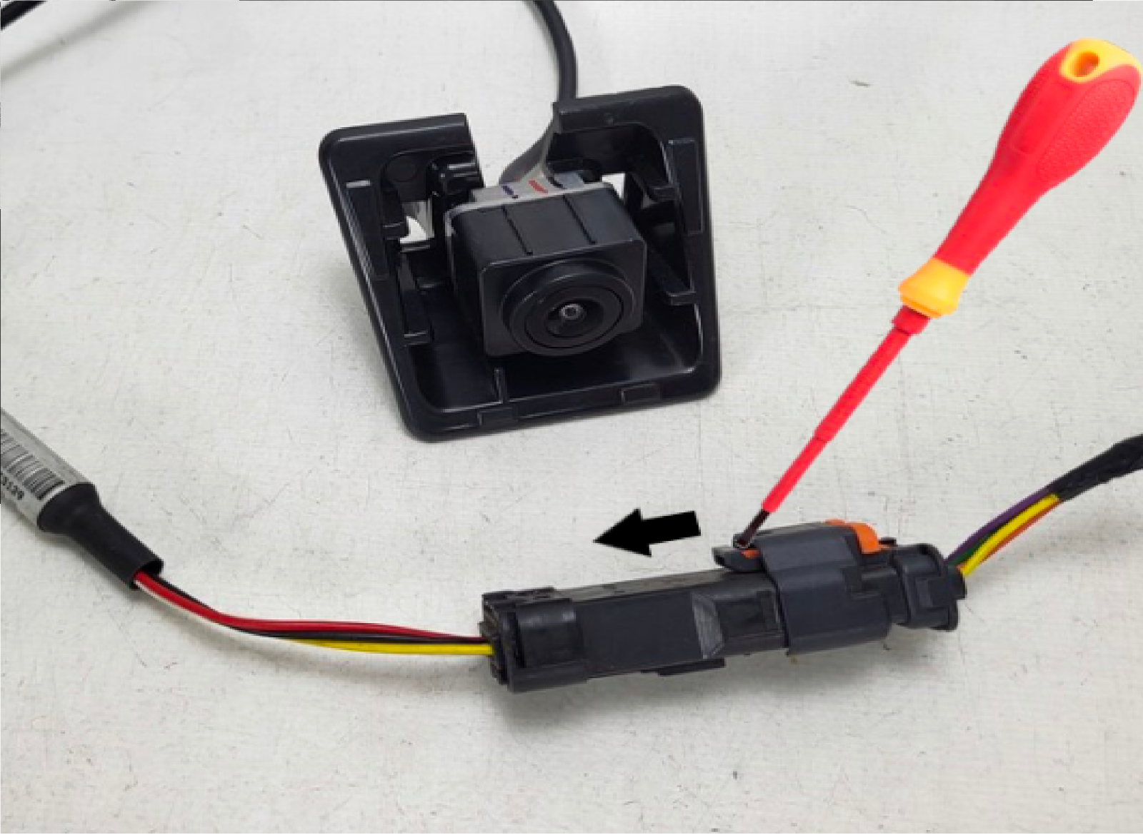

5. Disconnect the connectors with your finger or better with a driver to unlock them :
These connectors were so hard to disconnect, I don't really know how I did it with my driver but I think it was like I described it on above 5. picture.
If anyone can confirm it would be nice.
