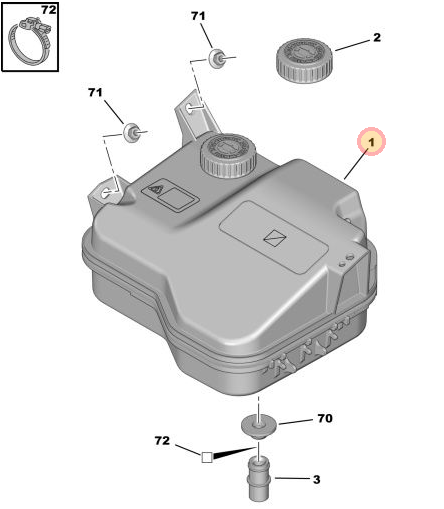

(1) Power Steering - Suspension LDS Tank, part: 4009V8, £97.09

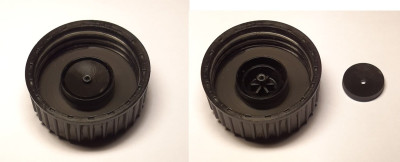

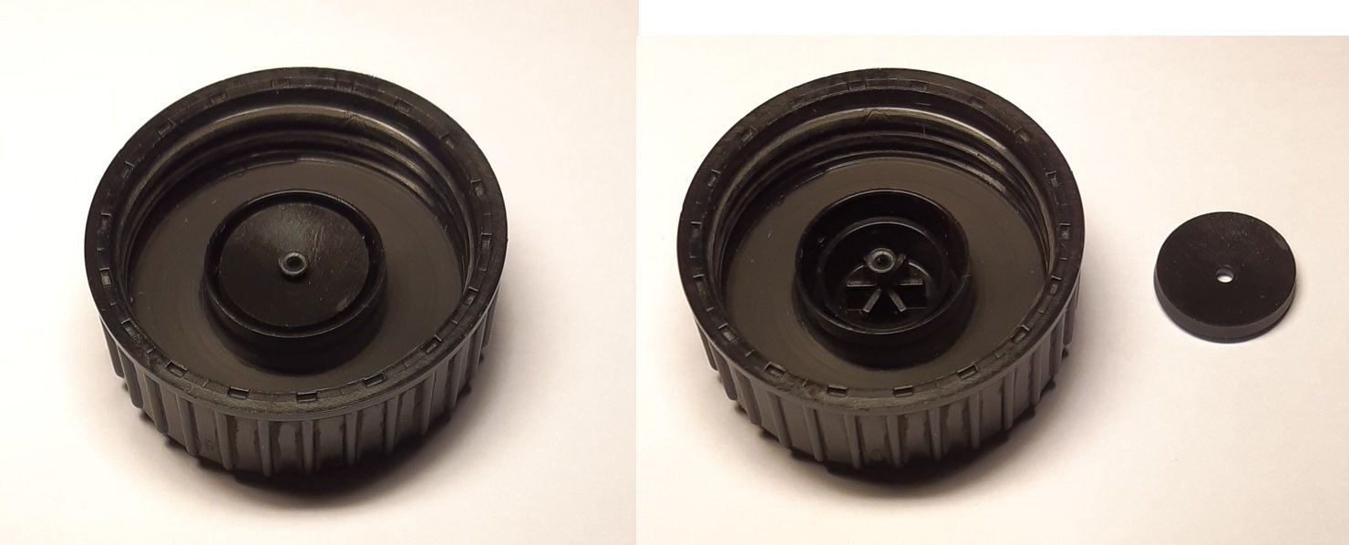

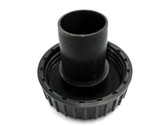

There's a good reason for this - you have the OLD cap!
That one above is the old 4009L6 part reference.
The new one has been redesigned like so:

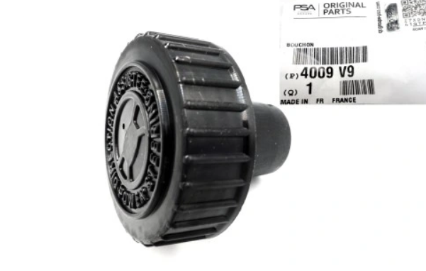

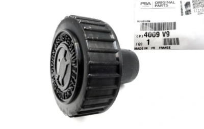

The new one has part number 4009V9

So yes, old cap has also a small hole in it.
But does the new cap still have the rubber flap?
x 6956

Ok, can someone else, who has that updated cap; check if there is still that rubber flap inside the cap?
x 6956

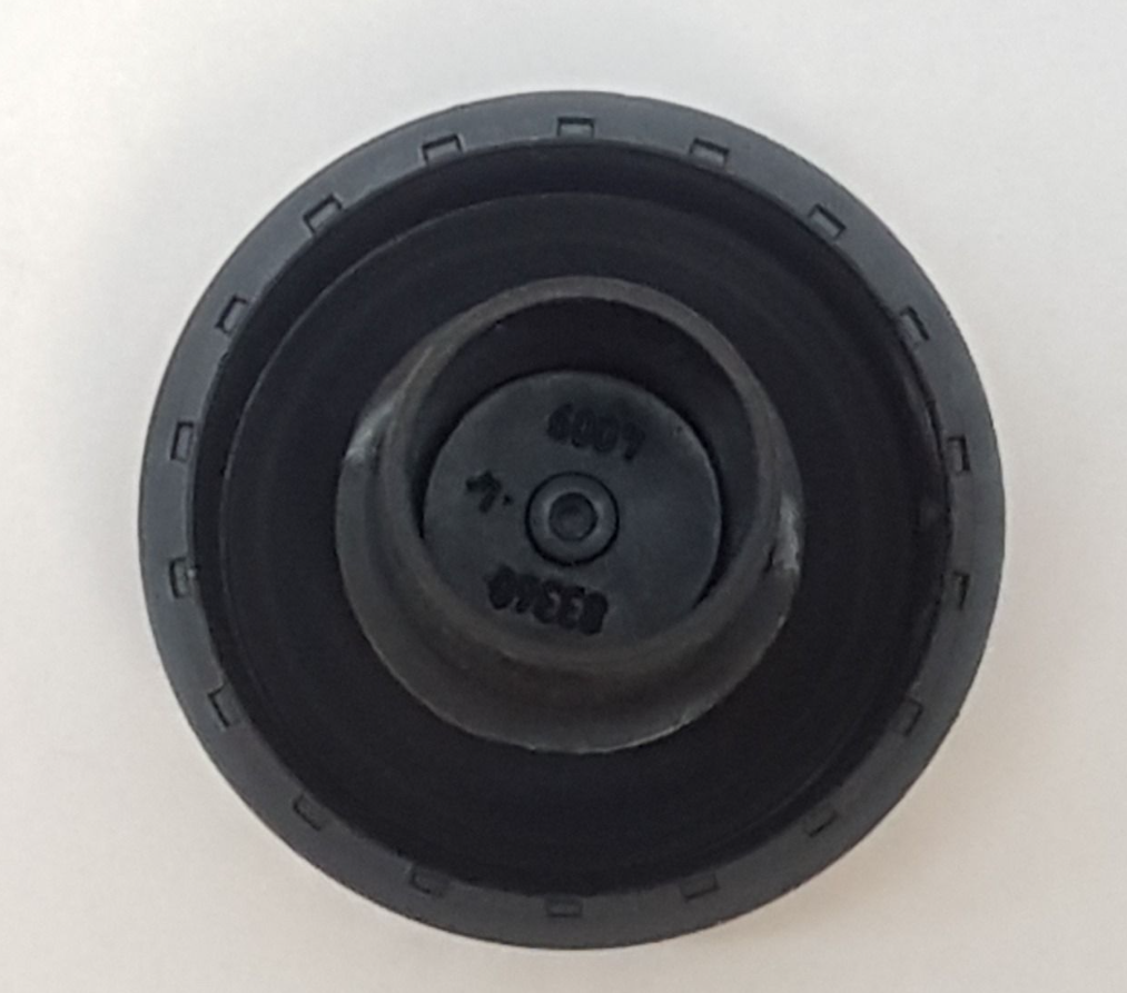

Re: LDS Tank Bursting Warning Labels
This may confirm - the inside of 4009V9:
... and I though my OCD was bad :rofl:
Unread post by Andy_Silk »
To me it seems that there is still that rubber flap which blocks the passage to bleed hole when there is pressure in the reservoir.
What an absolute idiotic design.
