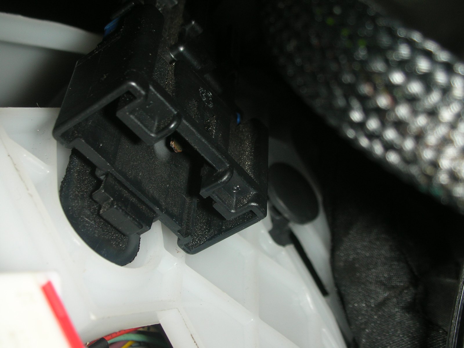

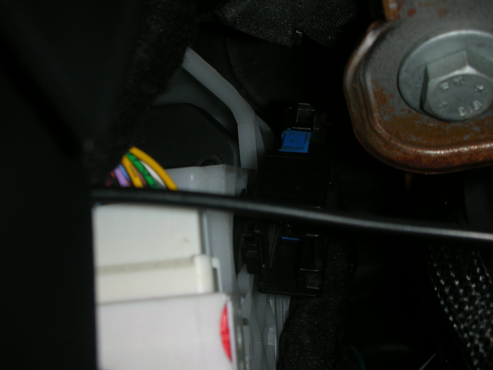

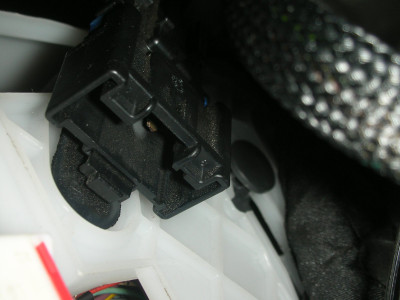

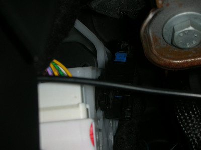

59 CLM is the heating system harness:

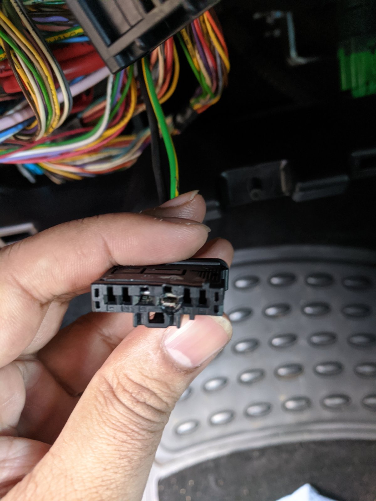

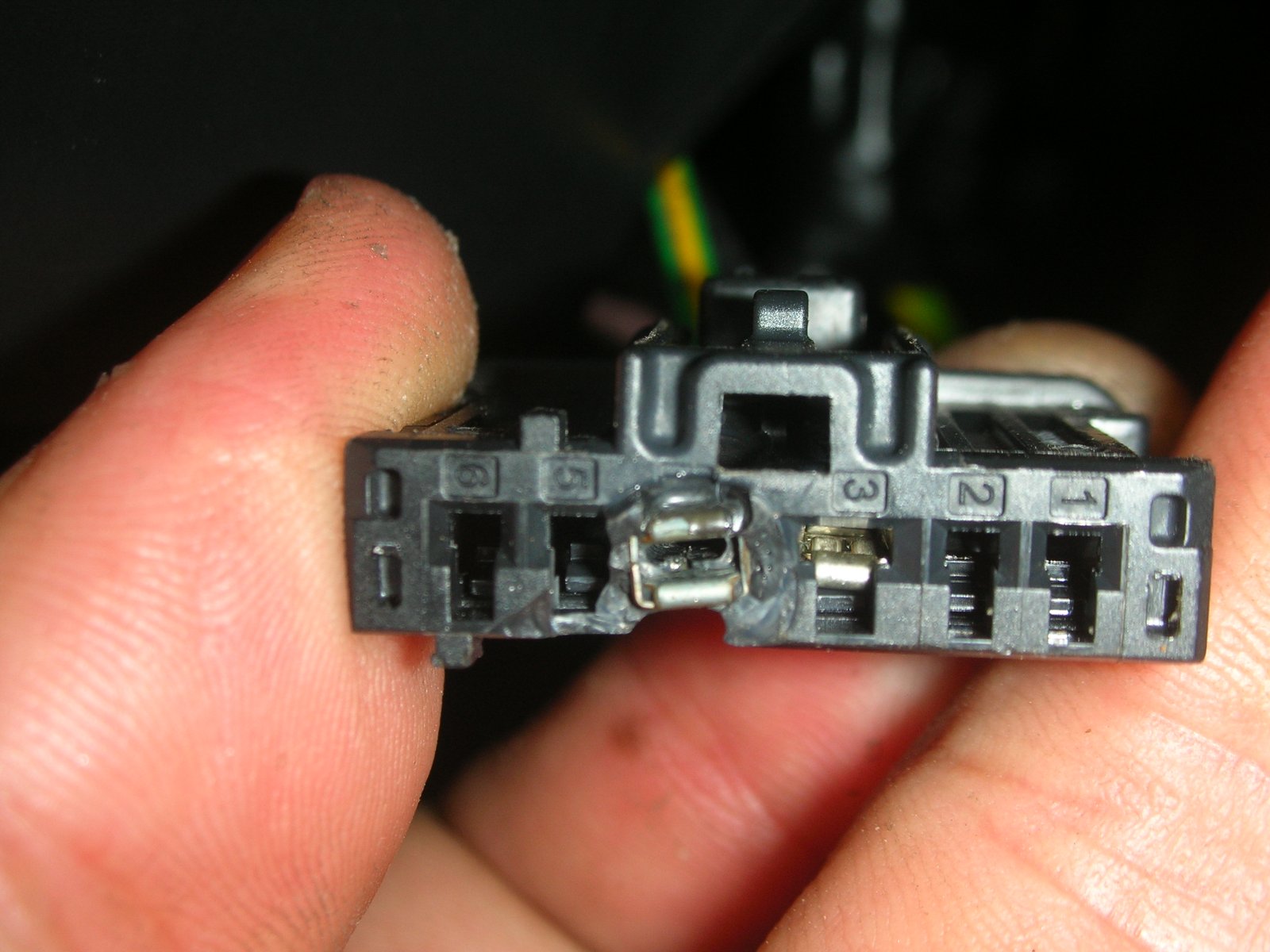

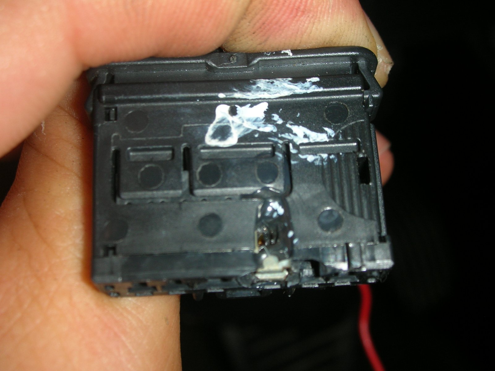

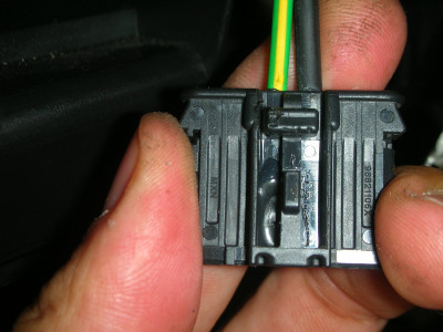

Re: C4 Heater/AC not working

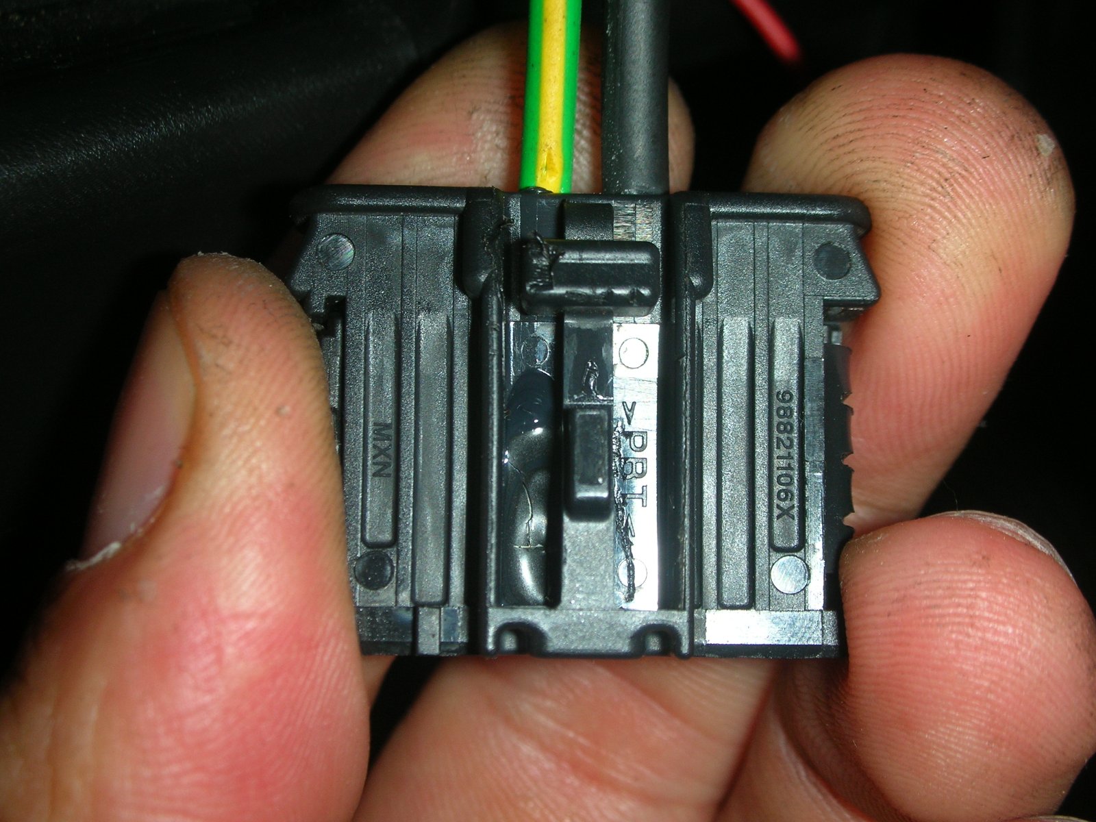

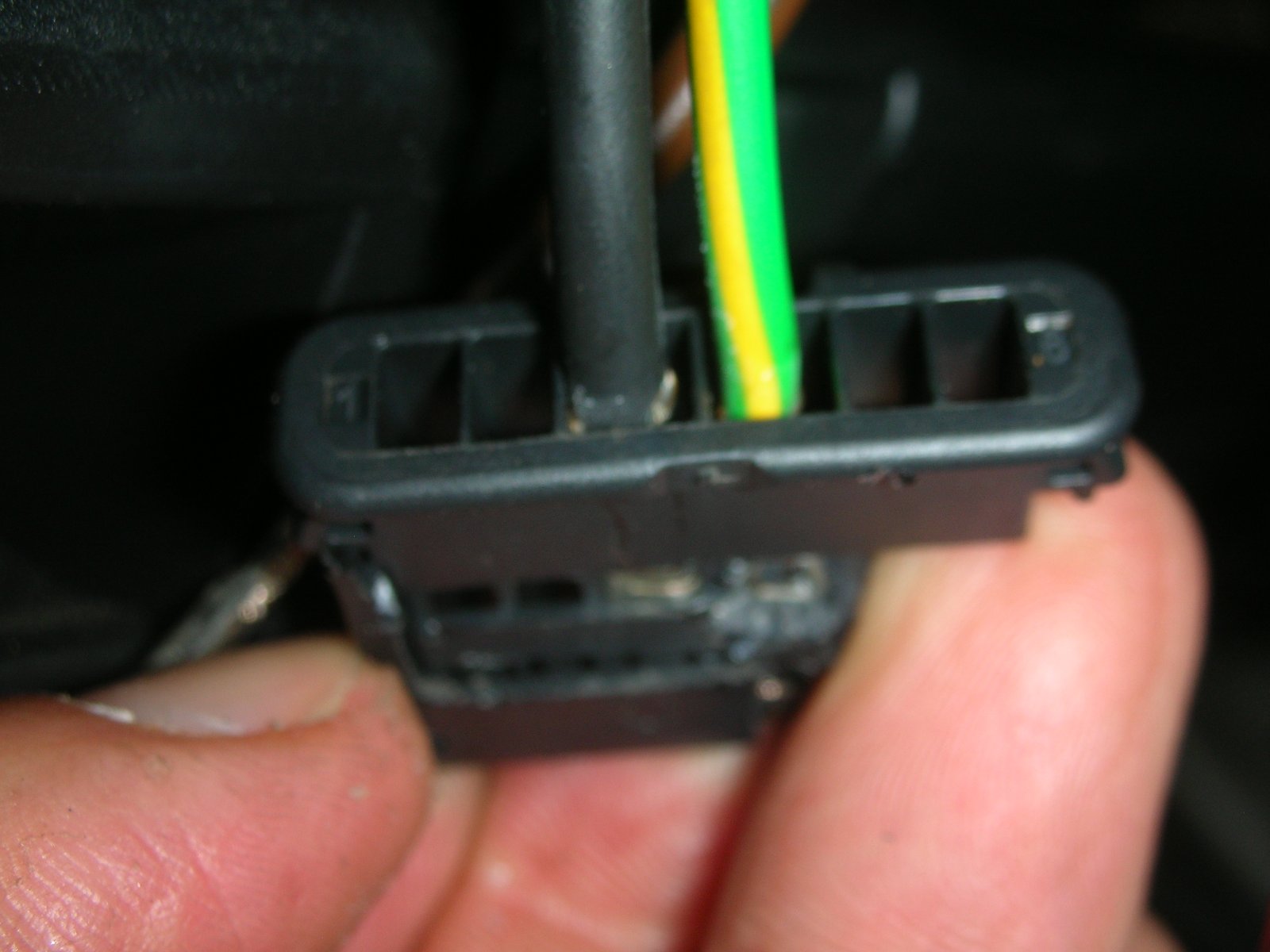

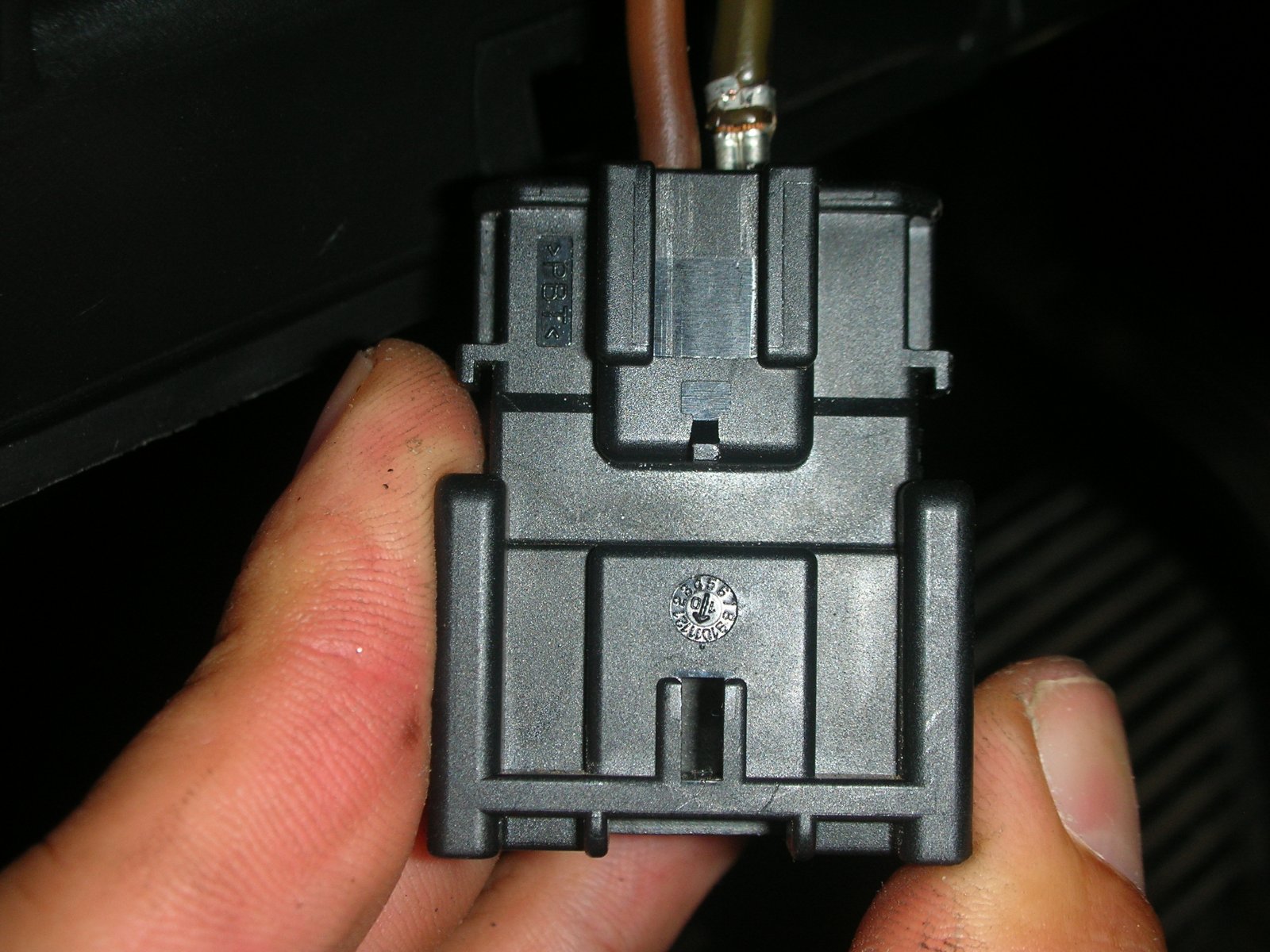

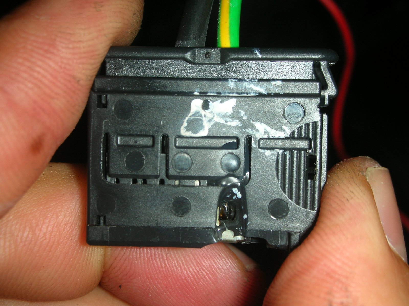

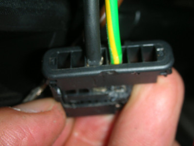

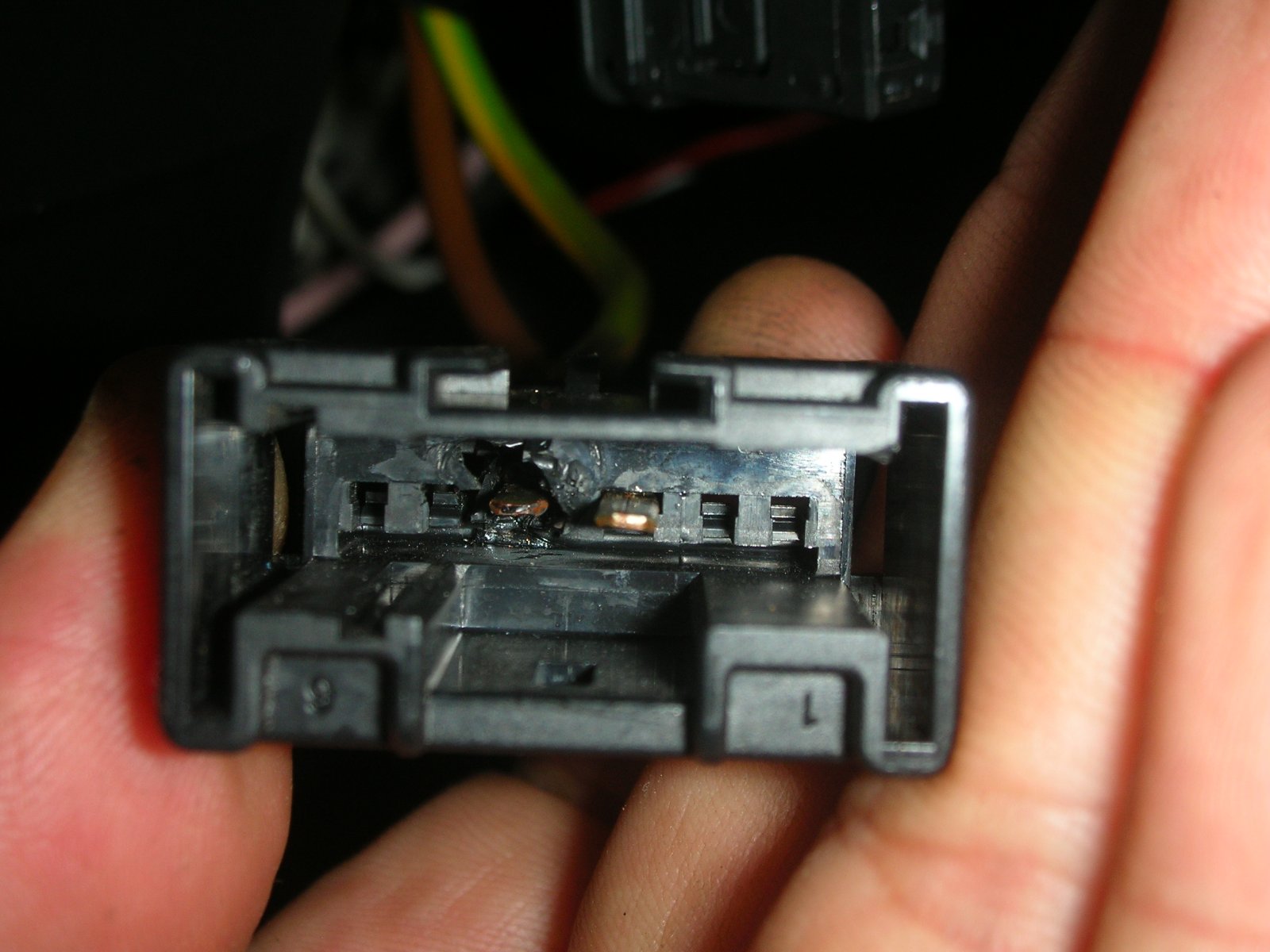

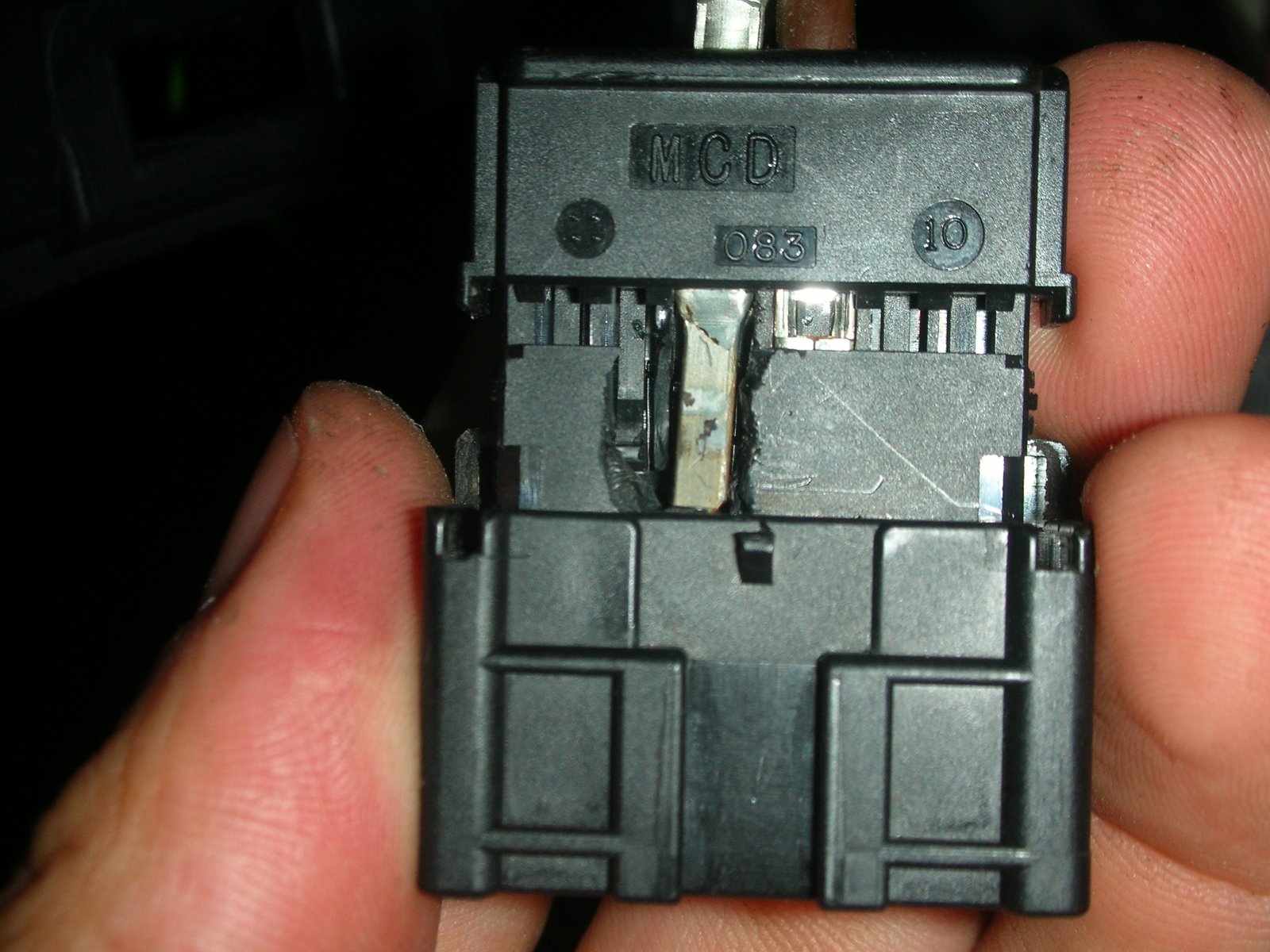

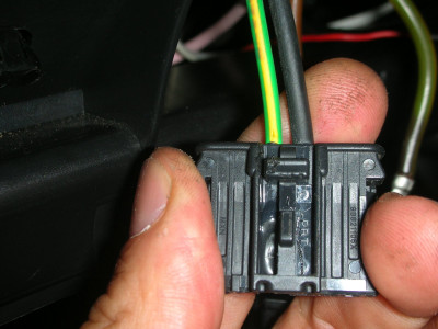

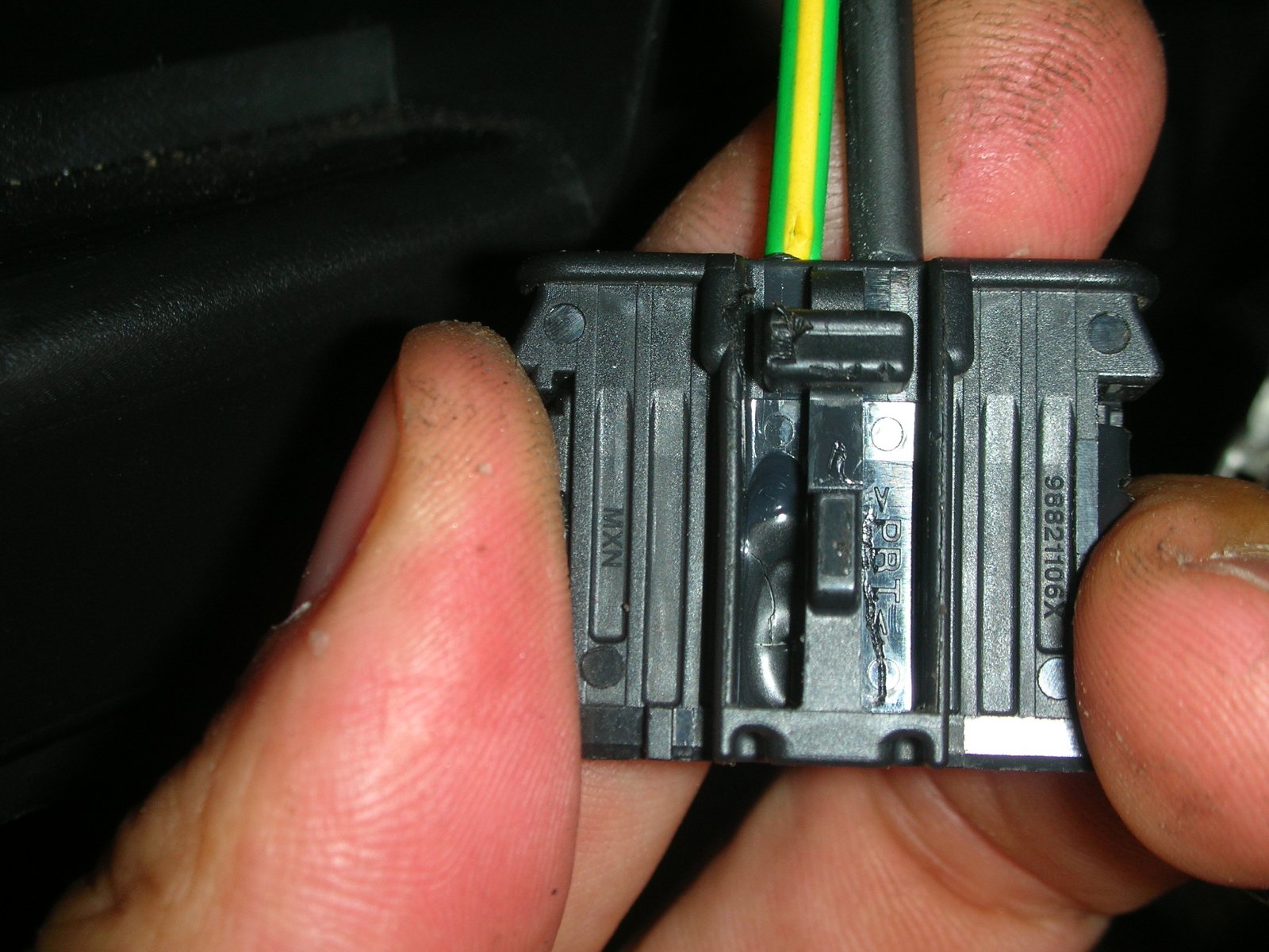

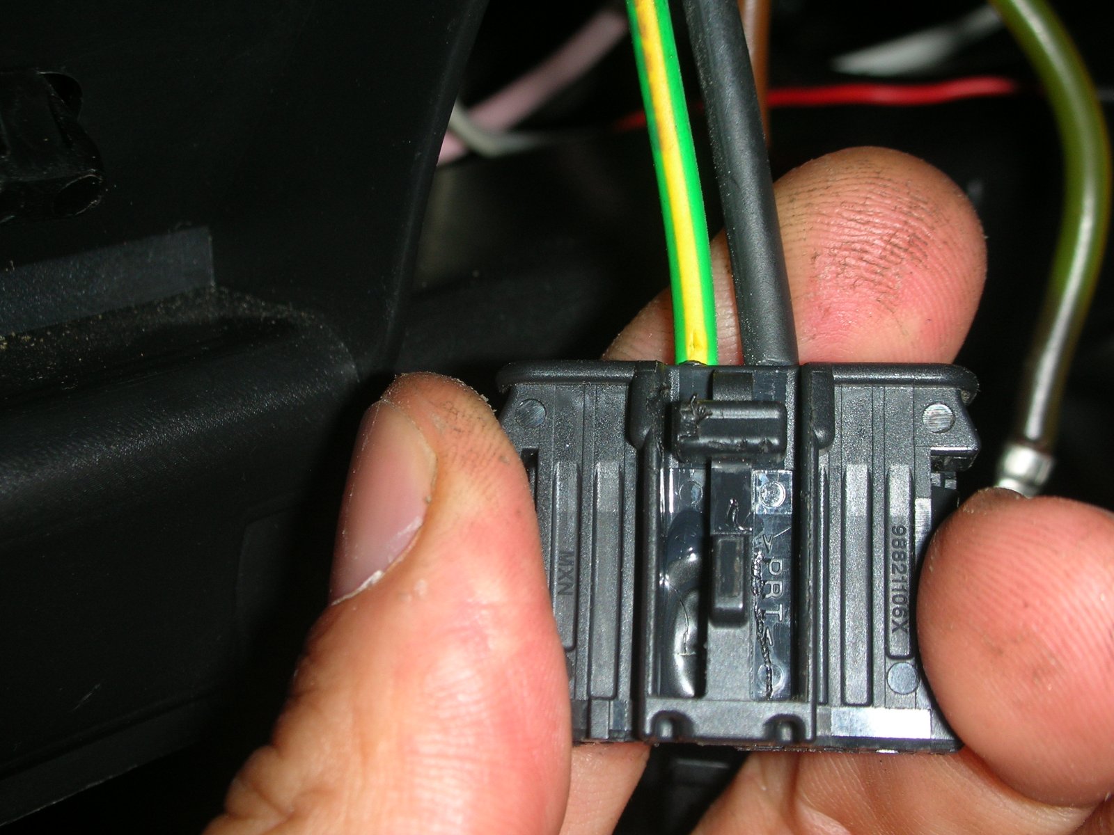

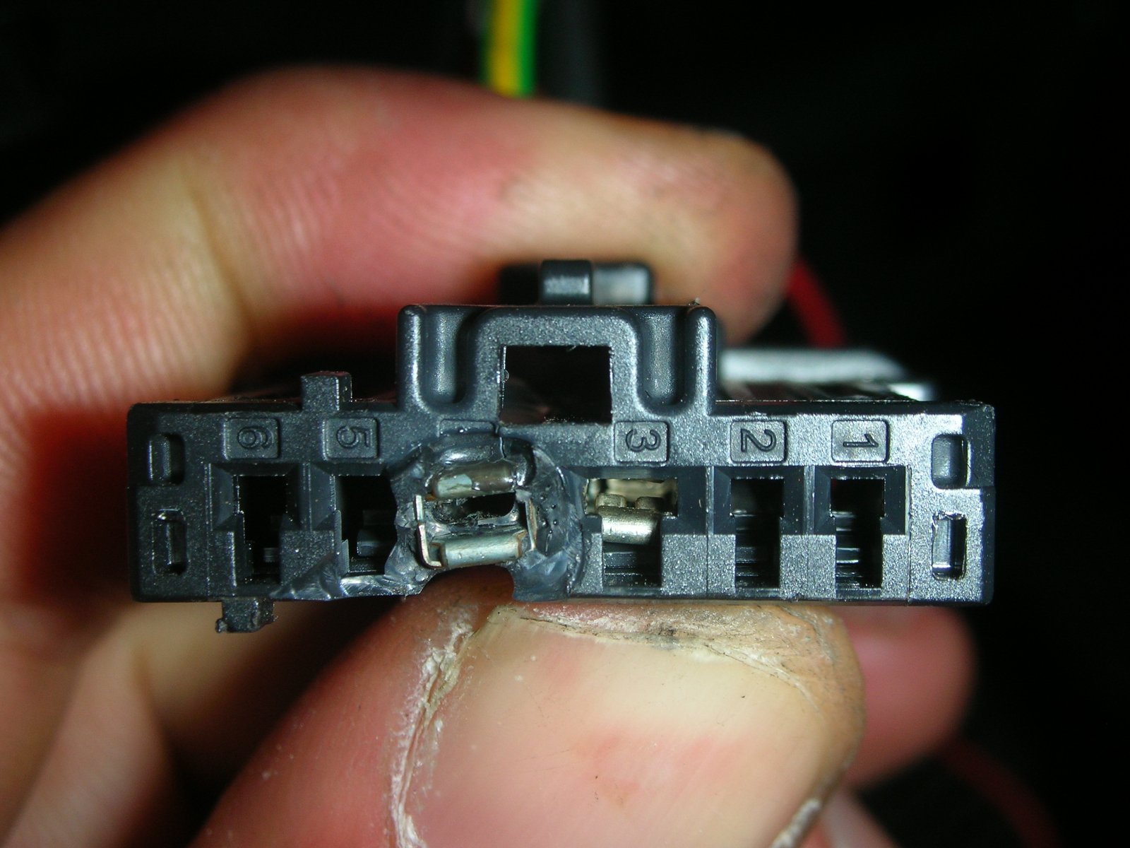

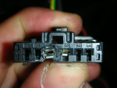

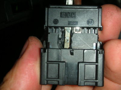

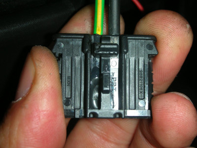

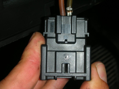

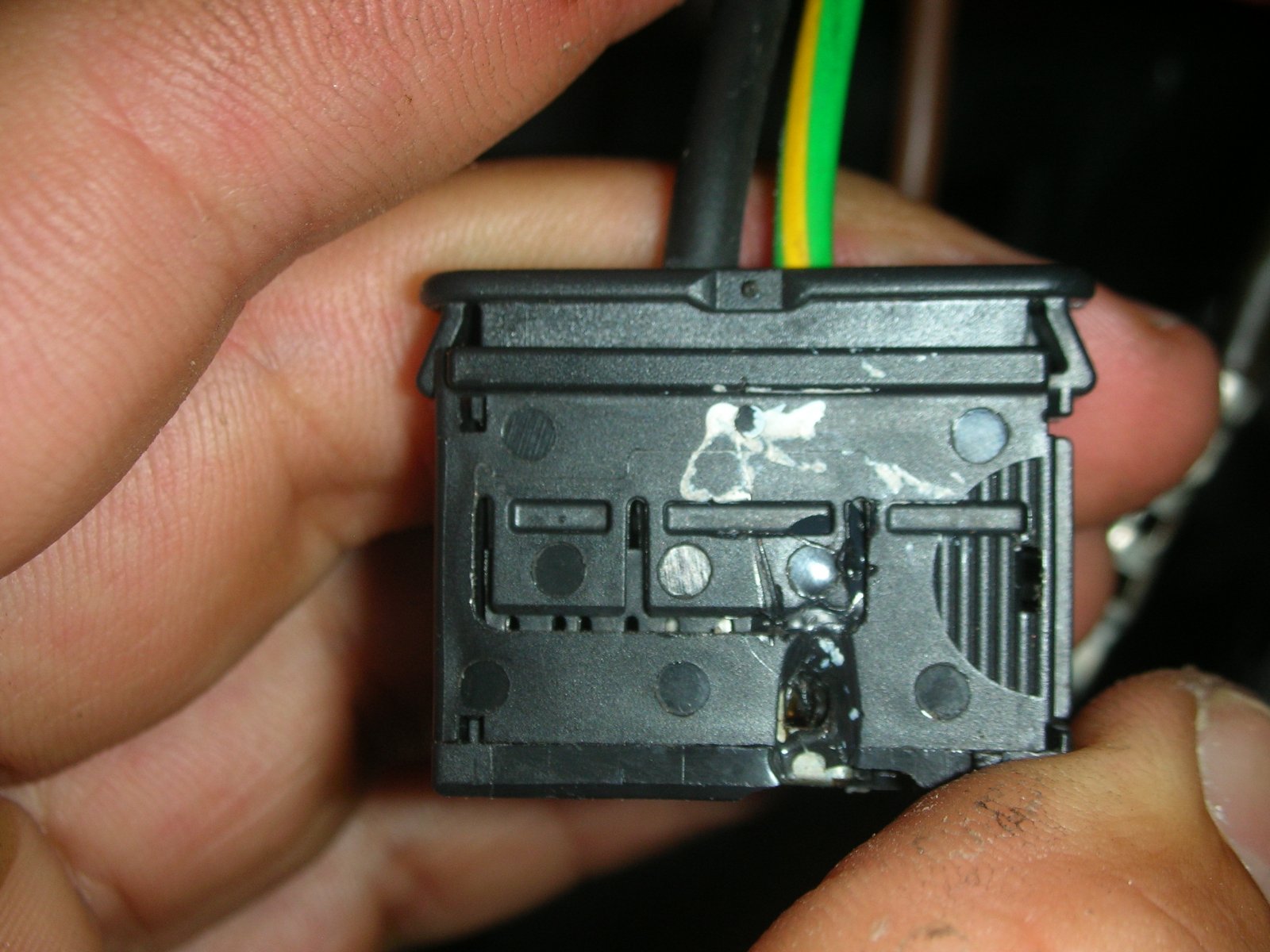

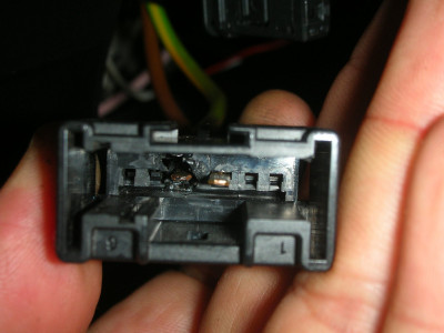

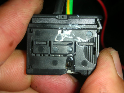

So managed to solve the blower issue but now have new issue
So the problem was the 10PR/59 CLM connector( see pictures) the earth wire had melted the connector not making full contact chasing a lack of earth to the blower control module.
Now have new error on diagbox.....
Code P1AA2- voltage retaining device
Also get message saying ECO deactivated on the screen everytime I start the car.
On Monday, September 14th I was presented with the same defect described by user daran. After having checked all the fuses of all the control units (I'm scrupulous), I checked the voltage coming from the battery at the connection point of the resistor. 8 Volts ... Consequently I checked the ground continuity and 12 volts coming from the battery .. The problem as daran found is the 10PR / 59 CLM connector, which is attached to the structure that supports the BSI.
Thanks

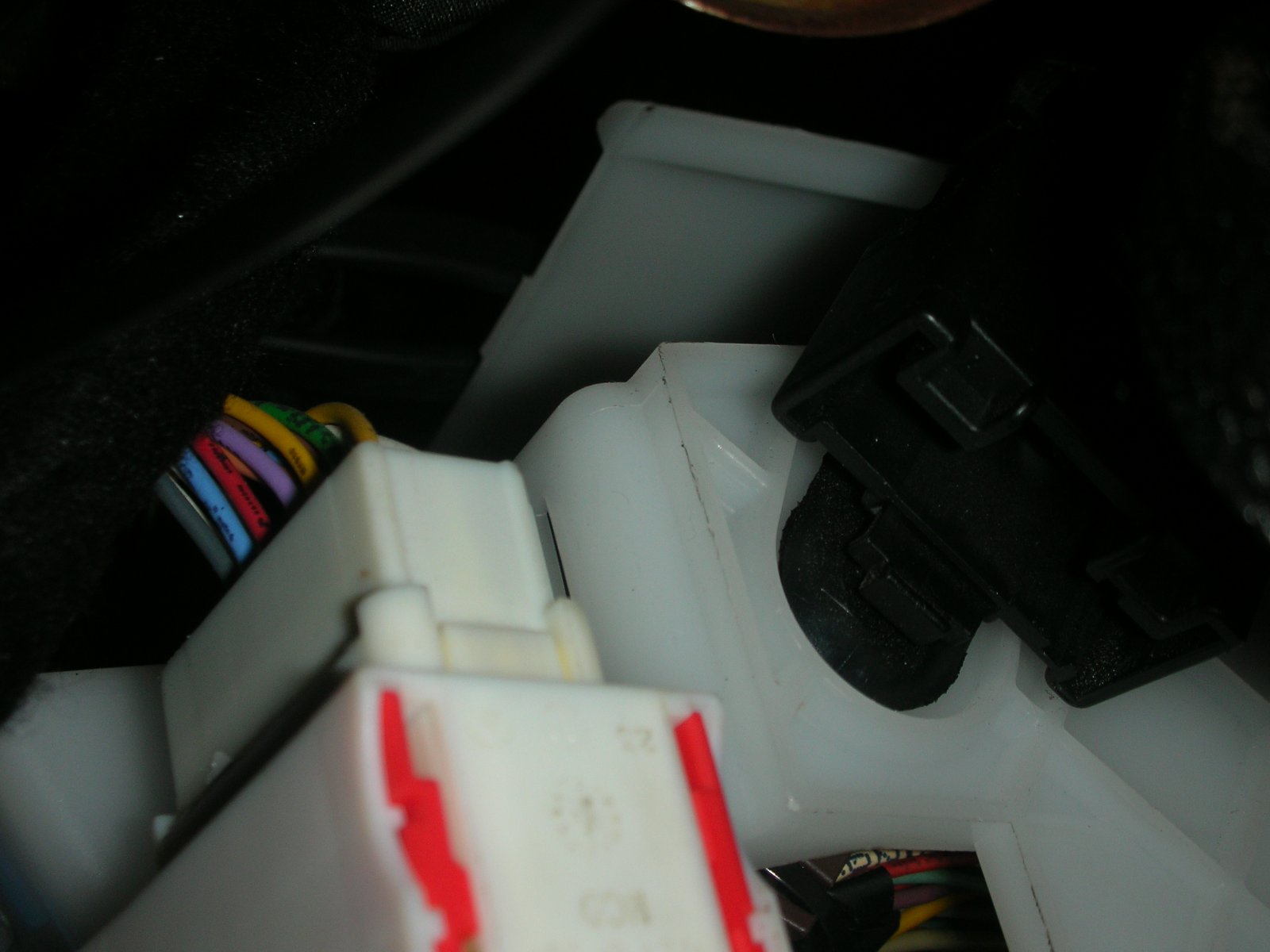

Today i faced the same problem (as daren and krakatoa) on my C4 (B7). Can you tell me the location of the 10PR / 59 CLM connector?
Thank you i advance.
- x 6945
@apostolos: Hi, I've just checked the post you 'liked' today and noticed that the image has become corrupted. I have corrected it now, so it should be visible back in the original post here:
viewtopic.php?p=630563#p630563
I have a C4 2013 RHD, normal controls, no fancy stuff. I had problems with the blower in the summer, sometimes working and then not and finally it gave up, AC led still coming on. If you are like me and tend to leave things until winter to get on your hands and knees and take glove box, side panels etc out when your fingers have decided to feel nothing and then trying to turn yourself upside down to get to what you want to get too. Checked all fuses, took out the fan motor after a right old farting about (motor turns freely and applied 12v and it works). Turns out it was the connector with the large earth wire and black wire had started to melt and making no contact. I have to ask why it would do this, bad design specs!
