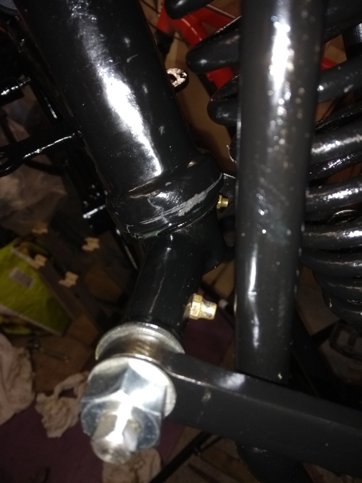

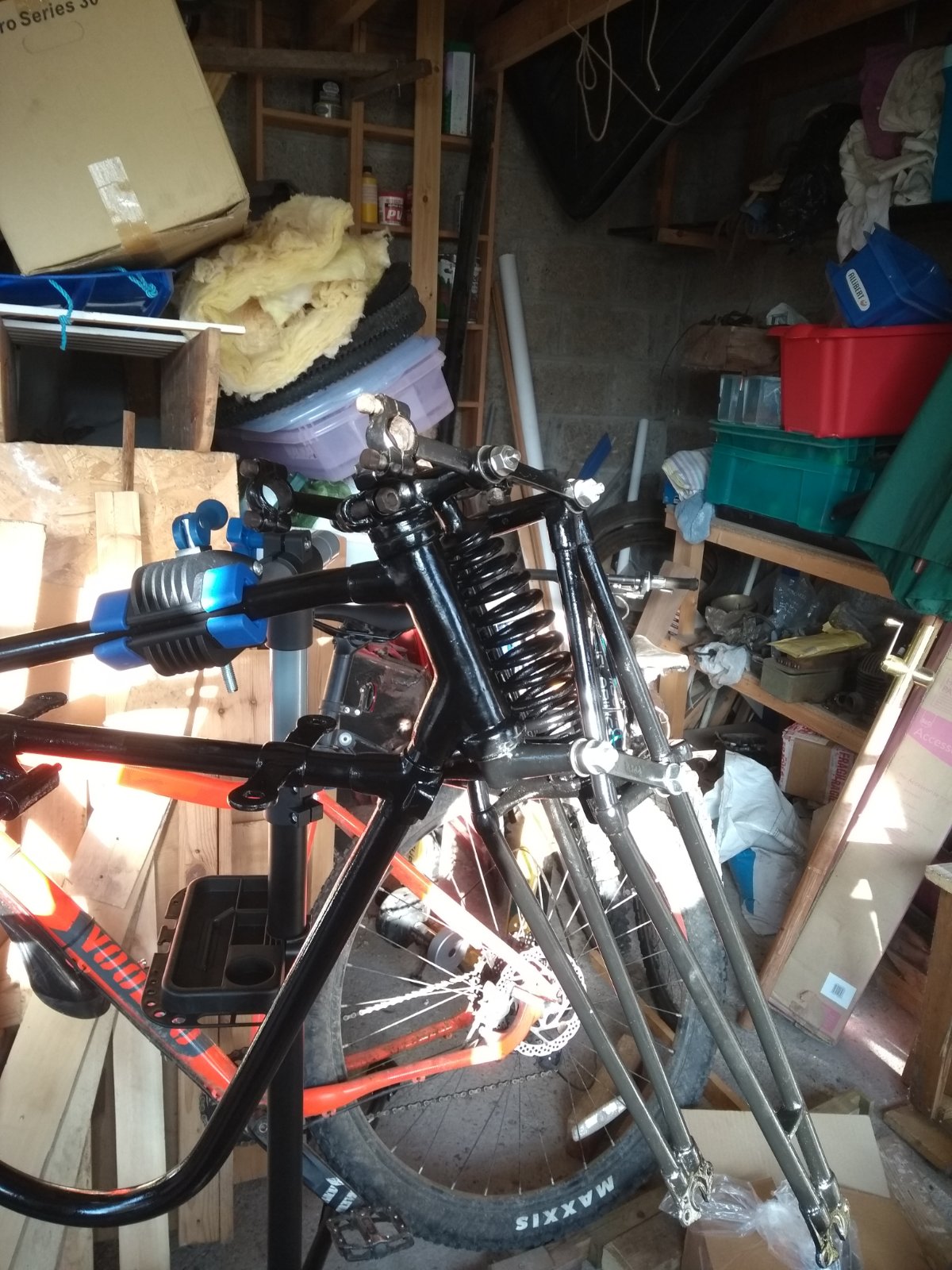

Threw it aside and assembled the forks - which is somewhat of a game! You seem to need about 4 hands. Anyway, I got there in the end. At first the spring was catching on the head tube, but when I bolted the top of the spring in it has pulled clear.
Forks and frame are same colour, difference is a trick of the light.

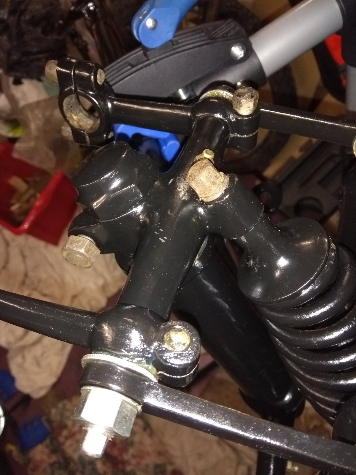

Then I realised that I had put the handlebar clamps on with the bolts in the opposite way round, no performance issues, but it looks stoopid which means I'll have to strip it all off again
Which means I can turn round the lower yoke, as the grease nipples are in fact hidden on the front, and should, I think, be on the back.

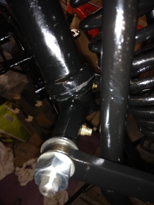

You can see on here scratches on the head tube where the spring was initially catching.

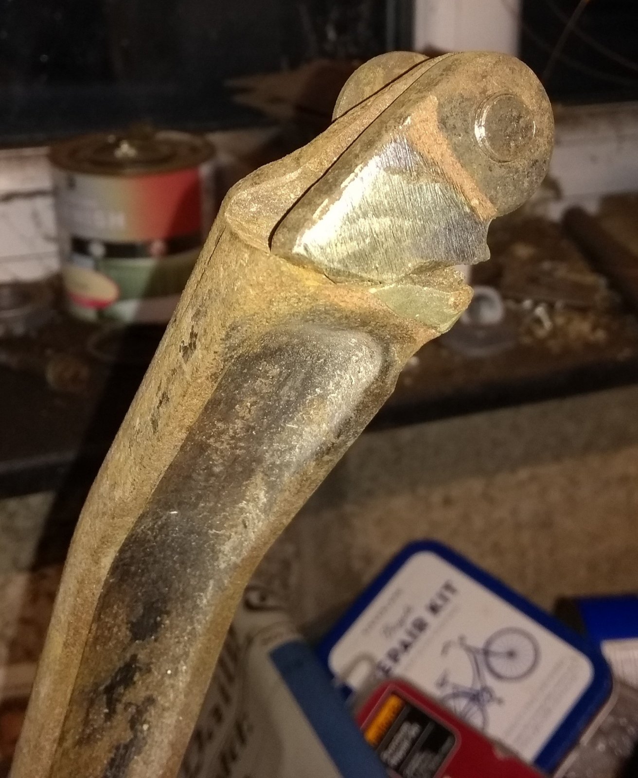

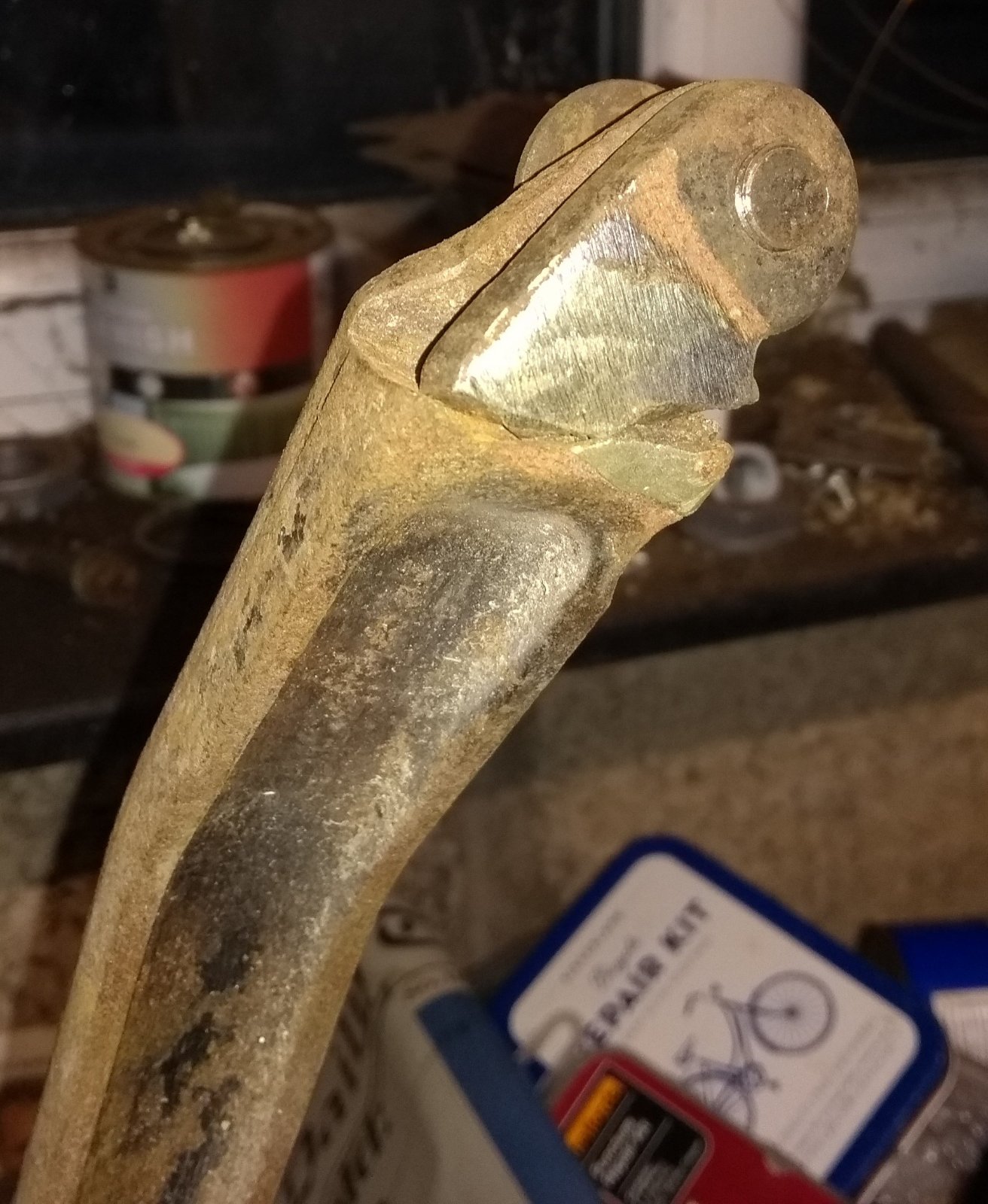

Then onto the stand - as previously noted this is broken:
Previous repair by brazing has not run into the joint, so needs to be re-done. Been looking at welding it, but it seems to be a challenge on cast iron - suggestion seems to be that using stainless wire, pre-heating it, and then allowing to cool slowly (may) prevent it just cracking off as it cools. MIG brazing a possibility, but it doesn't look that easy with a basic hobby MIG, so will try the stainless wire. I also found a home for the bolts with the pip on the top that I mentioned early in this blog - they are the stand bolts. I've still no idea why they've got a pip on top though!!
Just about visible on this more wear indication there's quite significant wear on the shoulder!

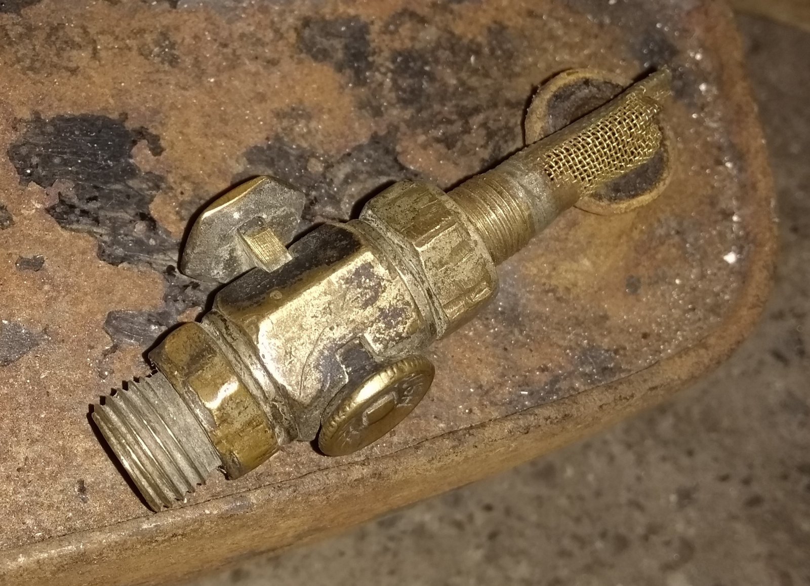

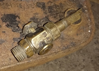

Another thing I wanted to do was get the petrol tap out of the tank to strip it down, and check that I could get it out in case it decides to leak. Actually came out easily, just a light tap on the spanner and it came undone. Just as well I took it out, as the filter on the end I didn't know was there was completely blocked! Manged to get it apart, no idea if it will be leak tight or not when I finally get the tank filled.

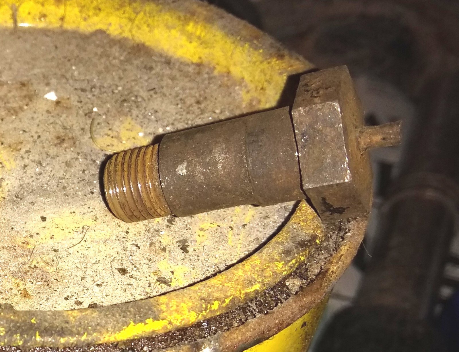

Is that pip where a spring for the stand attaches ?RichardW wrote: 29 Apr 2019, 12:42 I also found a home for the bolts with the pip on the top that I mentioned early in this blog - they are the stand bolts. I've still no idea why they've got a pip on top though!!
- Posts: 12603
- x 1493
Re: RichardW's Velocette rebuild
No, there's a massive spring, and lugs for that. I wonder if there were originally some embellishers, but I can't really see why there should be - there are no other niceties!

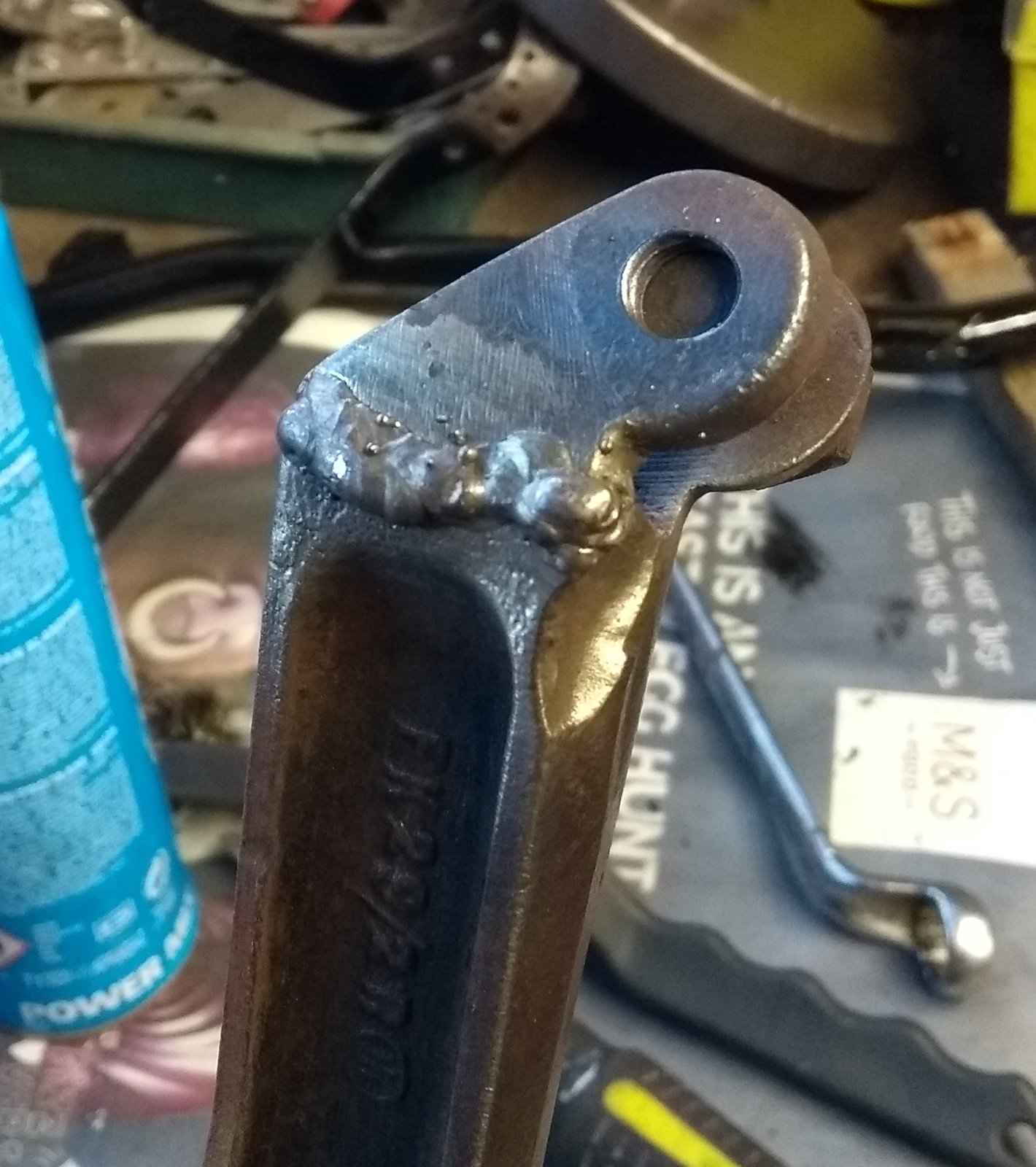

A little more weld on the stand has left us with this
Not the prettiest weld, but seems solid

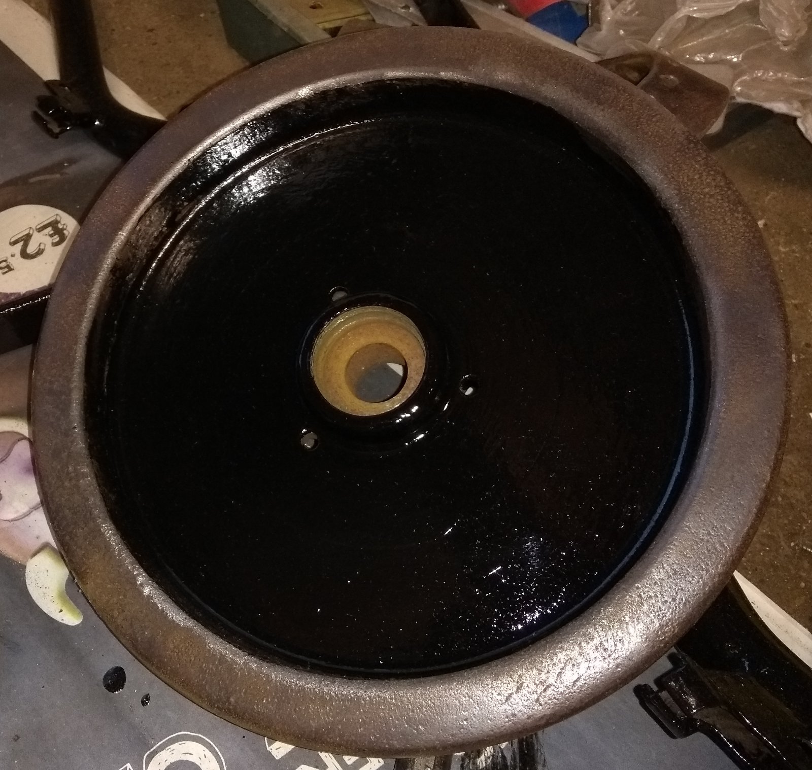

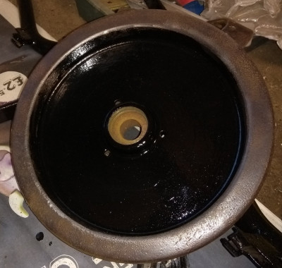

Flywheel with paint on the middle
You can see 3 small holes around the centre boss - these are not original, and were added to bolt on a (homemade of course!) pulley to allow the use of an external dynamo, bolted under the bottom of the frame.

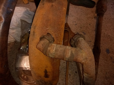

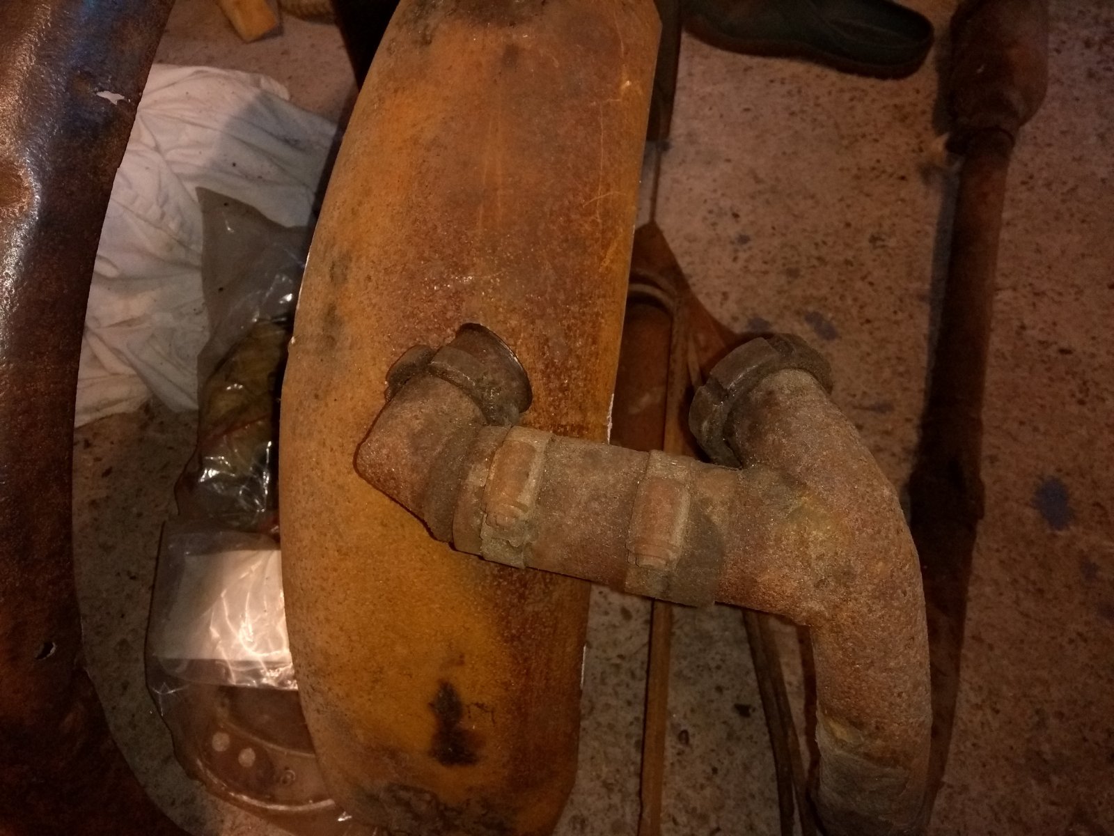

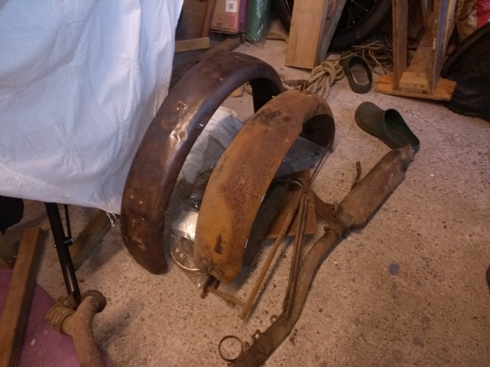

The exhaust shows signs of some home mods as well... there are supposed to be 2, one each side! Don't know how I am going to get these made yet....

Apart from the exhaust, the one thing I don't have is the gear change gate on the tank. If you happen to see one (how likely is that??!??) the pictures and measurements of this would be go. I suspect it will be the same on all the Velocettes with 3sp boxes of the same era. There is a show up the road from here in a few weeks, will probably go along and see if there is anything I can copy...
Spent a few hours on the rear mudguard today, welding up the holes. The first few were OK, but the split right on the front bottom is being a mare - it's so thin that as soon as I start the arc it blows a hole, even with the welder turned right down, and the wire speed turned down almost too low... what started out as a small hole is now a patchwork nearly 2" square - and it's still got holes in it, and extending it at the edge is still making more holes! Perhaps I should cut it out, and let a plate in, but then it needs to be thick enough to allow the butt weld to be made!

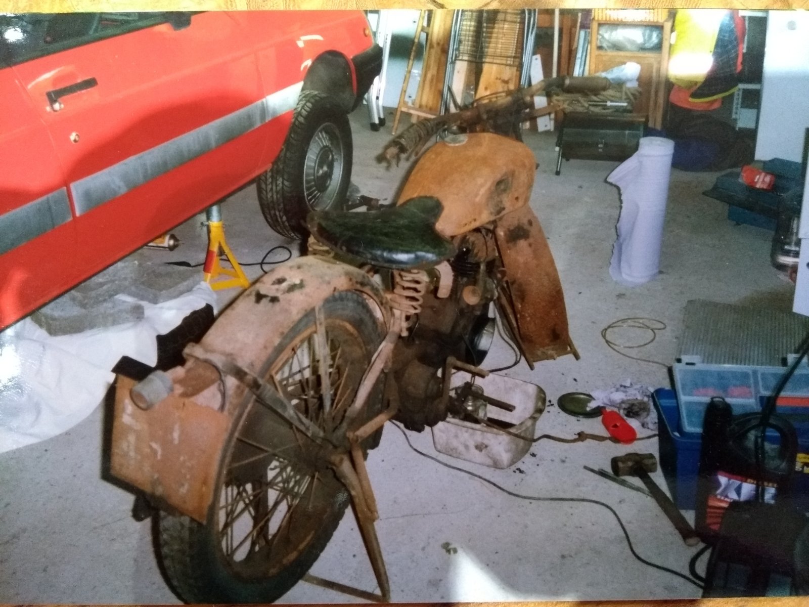

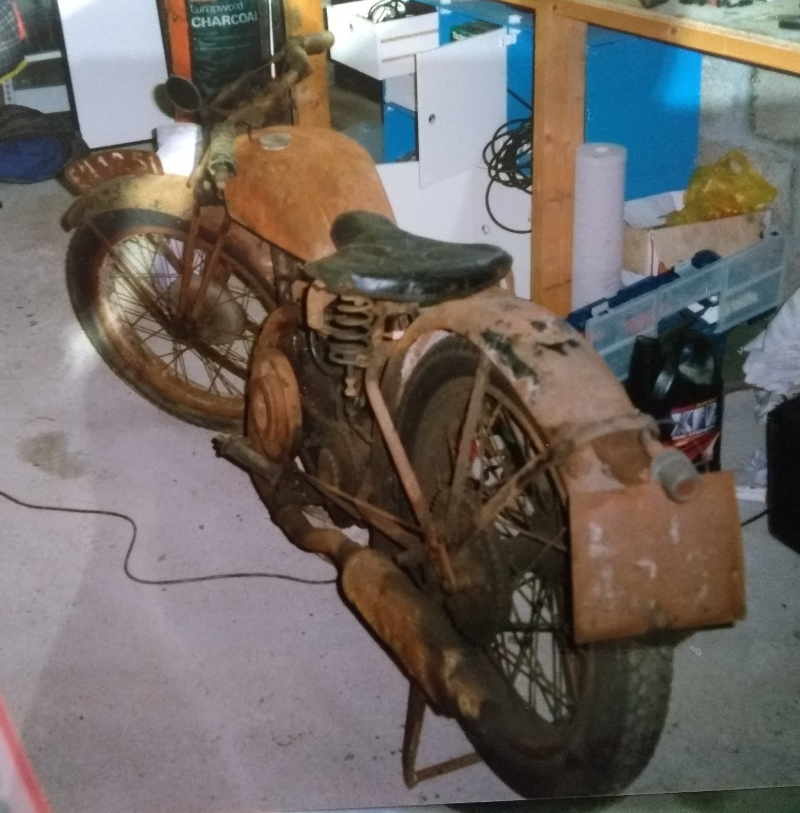

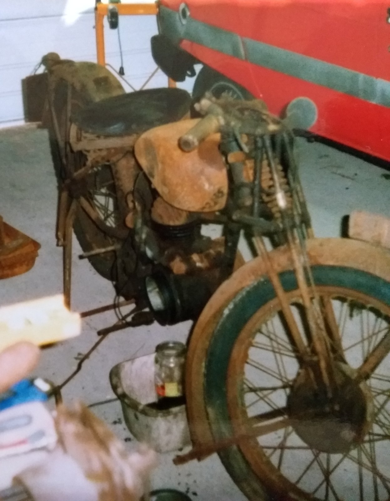

Not much done recently as too many weekends away! I have managed to tidy up this week and get some paint on the guards and stays, I've also got numbers to make the up the reg plates. Hoping to get the painting finished and the guards and wheels in in the next week or so. I found some as arrived photos...

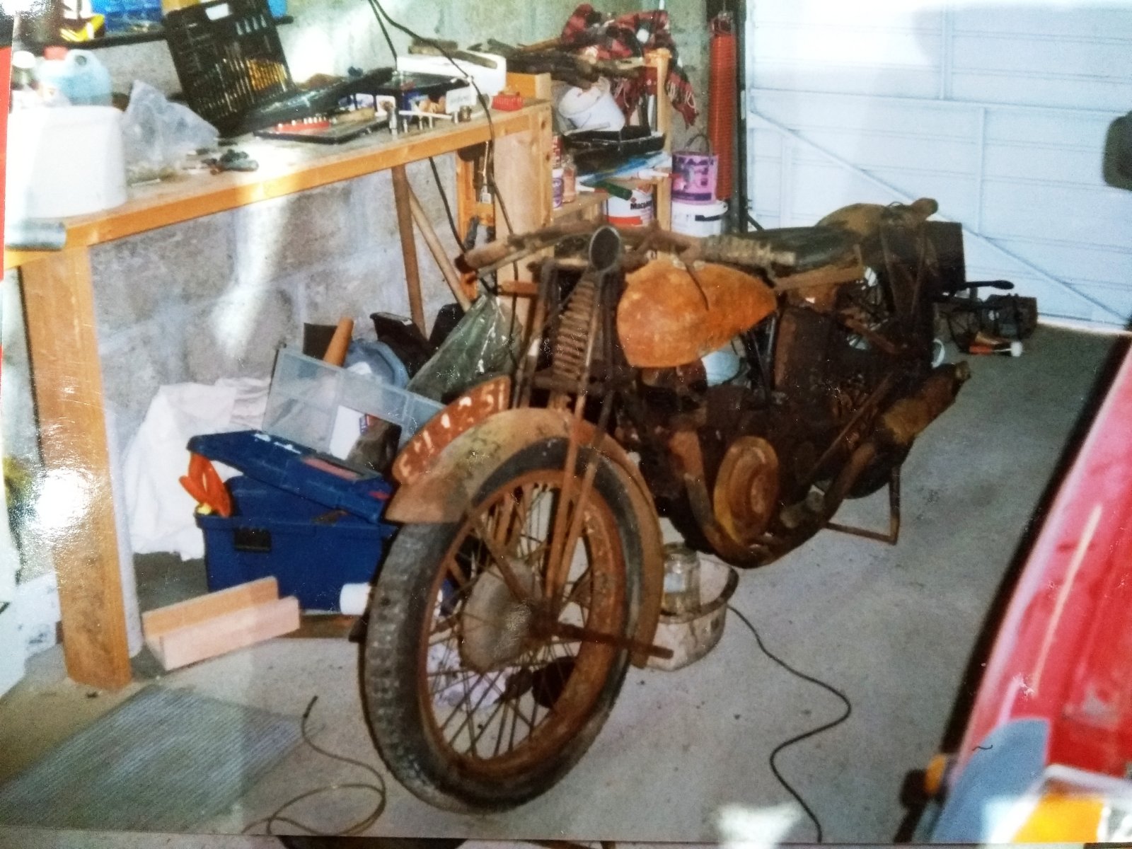

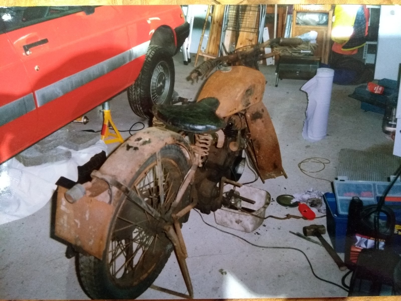

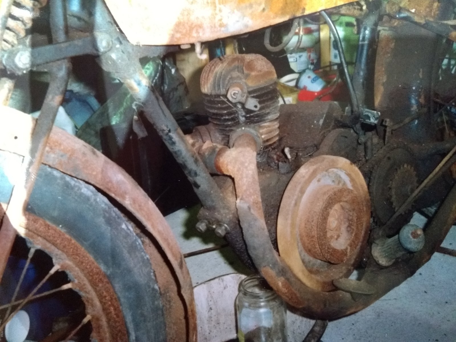

Photos 1, 2 and 5 show that the NS peg is (very) bent, I don't think I have straightened that out, will have to have a look at it - getting out the pegs and mount, which form the rear engine mount was next on the list anyway so I can get the crankcase base in the frame.
Things have changed a bit since then! In more ways than one it struck me, as I was taking digital photos with my smart phone of film photos... They were taken in 2002 probably, when...
No smartphones (pretty sure I didn't even have a mobile back then!)
Digital photography was in its infancy
We had no broadband
Desktop was a Pentium II equivalent
No laptop
No Wifi
No children (now 10.5 and 7.5!)
The pictures show there was quite a lot more space in the garage....

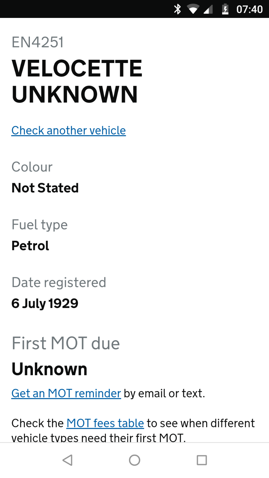

Happy birthday Velocette - 90 years today since it was registered
I've yet to establish factory dispatch date, will try and find out eventually.
