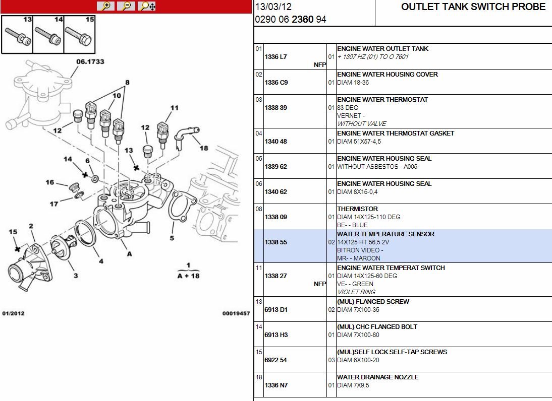

- x 1751
Re: Citroen Xantia 1.9 Turbo Diesel 1996
There are multiple temp sensors/senders on the engine, all on the water outlet/thermostat housing:
These control separate functions, eg:
- injection ECU control
- water temp control unit (Bitron), for fan operation
- temp gauge ('dial')
So it is possible for the gauge to mis-read, even though everything else is ok.
Thermostat is listed as 83°C.
Kevin posted his VIN earlier, Marc: VF7**************[VIN obfuscated, can be read by forum staff].
That cooling parts diag is for it.

Hi thanks everybody for your help,
Good pictures Chris thanks, I will check tomorrow, see how many sensors it has. And probably should check fuses also as needed to remove plug from A/C. The car has never ever been upto 90 degrees, not in the three years
I have owned it, not even in the summer. Fans always cut in about 85.

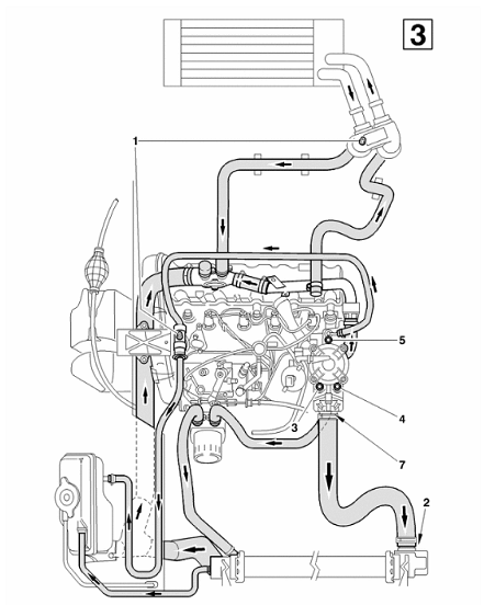

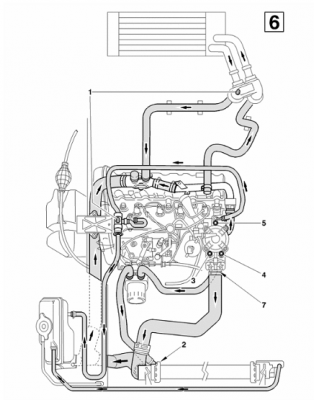

Thought I'd put this up for good measure - the cooling circuit For Kenny's Xantia - there are 6 of these circuits, but this one should be correct from the RPO and VIN:
Click picture to magnify and clarify.
Here is the data for your vehicle with A/C and the BITRON unit for info:
| (1) Bleeding the cooling system. |
| (2) Radiator drain screw. |
| (3) Coolant temperature sensor Warning and gauge. |
| (4) Coolant temperature sensor Bitron box - Pre-warning. |
| (5) Coolant temperature sensor injection . |
| (6) Coolant temperature sensor Engine cooling fans. |
| (7) Thermostat. |
| Vehicle type | - | Colour identification | Fan : Slow speed | Fan : High speed | Engine hot (refrigeration authorised) | Air conditioning cut-off | Pre-warning | Warning | Post-cooling (temperature and operation time) : degrees | Post-cooling (temperature and operation time) : Time |
| Turbocharged Diesel | With air conditioning | violet | 90 °C | 101 °C | 70 °C | 112 °C | 115 °C | 118 °C | 101 °C | 6 mn |

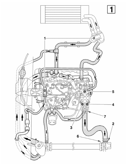

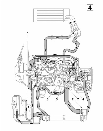

Like I said Kevin, there are 6 circuits and these changed based on build number:
Key to the Diagrams:
Your build number is 07158 from your VIN, so would be number 6, which is the one I posted before, so this might clear up the confusion and another reason why VIN is key as there were so many mods and changes on these throughout production.
| Circuit No. | Vehicle type | gearbox | air conditioning | Validity |
| 1 | atmospheric diesel | Mechanical | Without | Up to number OPR 6355 |
| 2 | atmospheric diesel | Mechanical | With | Up to number OPR 6355 |
| 3 | atmospheric diesel | Mechanical | With or without | From OPR 6356 number |
| 4 | atmospheric diesel | automatic | With or without | - |
| 5 | Turbocharged Diesel | Mechanical | With or without | Up to number OPR 6355 |
| 6 | Turbocharged Diesel | Mechanical | With or without | From OPR 6356 number |
The temp sensor connectors have been known to be colour-coded thus:
Injection (engine ECU) - Green
Water temp control unit (Bitron) - Brown
Gauge - Blue
Might help differentiate.
Pull the Blue one, and see whether it affects the gauge.
With engine running, pulling the Brown one usually puts fans on to full speed. (You might have to turn IGN off and then on again to return to normal.)
