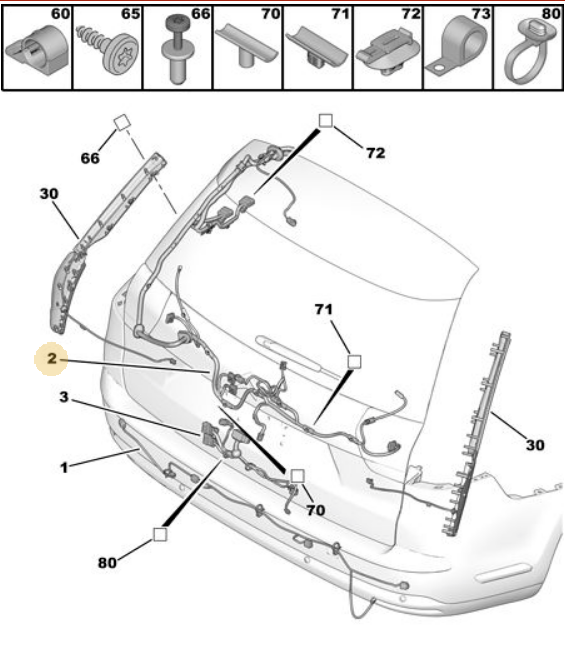

That's what I meant, sorry, It's been a long week, I'm just wondering whether to just get a new rear loom (part number 6534SX) phone call to the dealer in the morning will answer that question, what I can't work out yet is where the multiplug is for the tailgate loom.

Can't see that part number for an X7 Richard?
I think you mean 6534SX - but the price is the same!
Tourer Rear Harness:

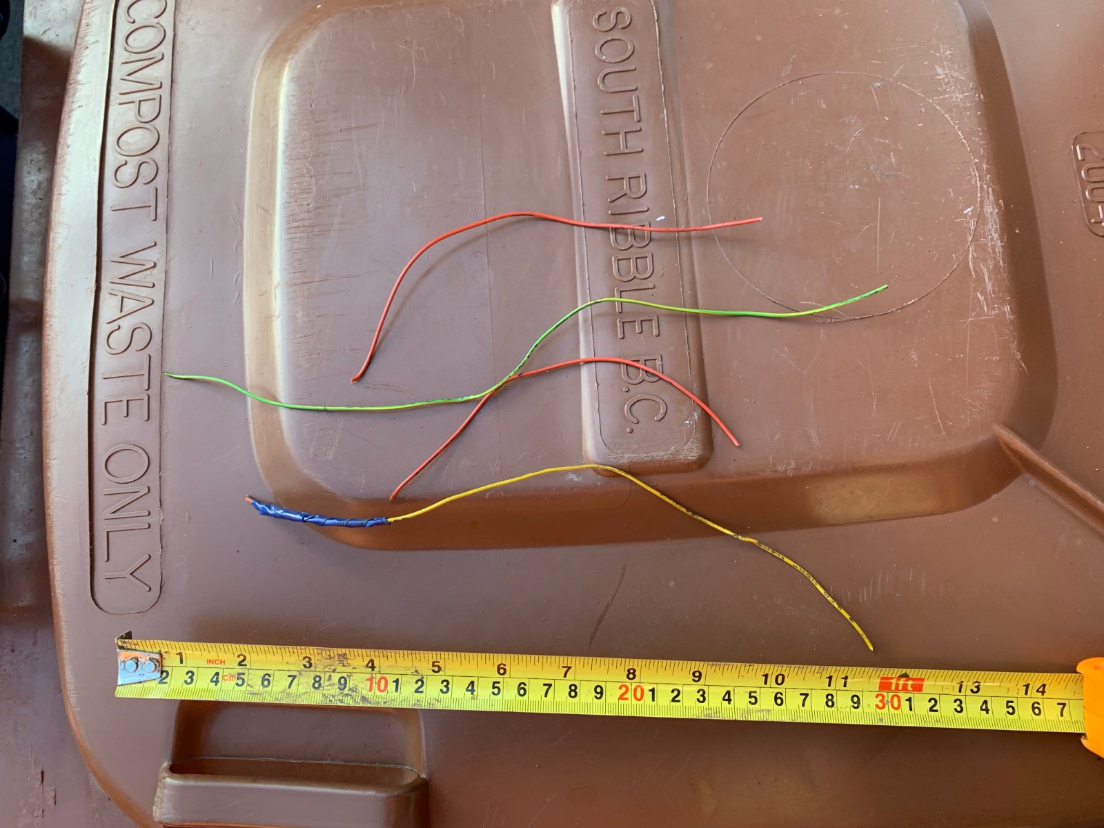

Tailgate now working after splicing in 4 lengths of wire,
The break was in the rubber tubing coming from the gromet in the top left corner, that Marc had mentioned in an earlier post.
I disconnected the loom from the junction point, which is above the tailgate ECU located on the left hand side as you look in the boot, to get access to the connections, you have to remove the cubbyhole and side trim, this has 2 torx screws hidden behind the plastic blanking plates and then it's held in place by a series of metal spring clips, a got tug, and they came away, you also have to remove the plastic strip that goes between the roof lining and the side panel as the loom has a couple of clips holding it in place.
Once you've disconnected the cable, it can be fed back through the gromet hole to allow you space to work. I had to remove quite a bit of the cable "wrapping" to get access to the wires, the by "wiggling" them around I could hear the switch relay "clicking" as it gained and lost power. This was how I found one of the wires had broken in the rubber tubing.
So, once again, thanks to everybody for their input, and Marc, I owe you
Next job, the handbrake
