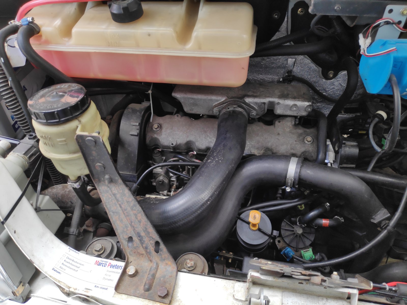

Just because I do not know were to find them. Does somebody know were the coolant bleeding point would be in my case? The coolant tank is way above the engine in my case (see picture). I just can't figure them out.
