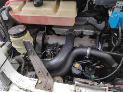

CPtje
- Posts: 33
- Joined: 01 Oct 2018, 15:42
Re: Cannot see clearly because of smoke during cold start
Hi Chris,
Head and gasket were replaced. The same issue before and after. No coolant loss, so guess thats not the problem.
Just because I do not know were to find them. Does somebody know were the coolant bleeding point would be in my case? The coolant tank is way above the engine in my case (see picture). I just can't figure them out.
