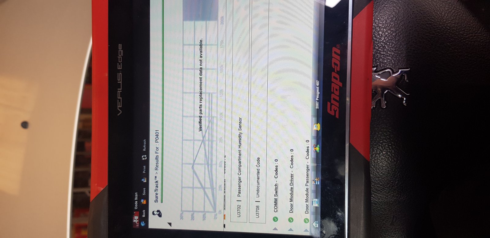

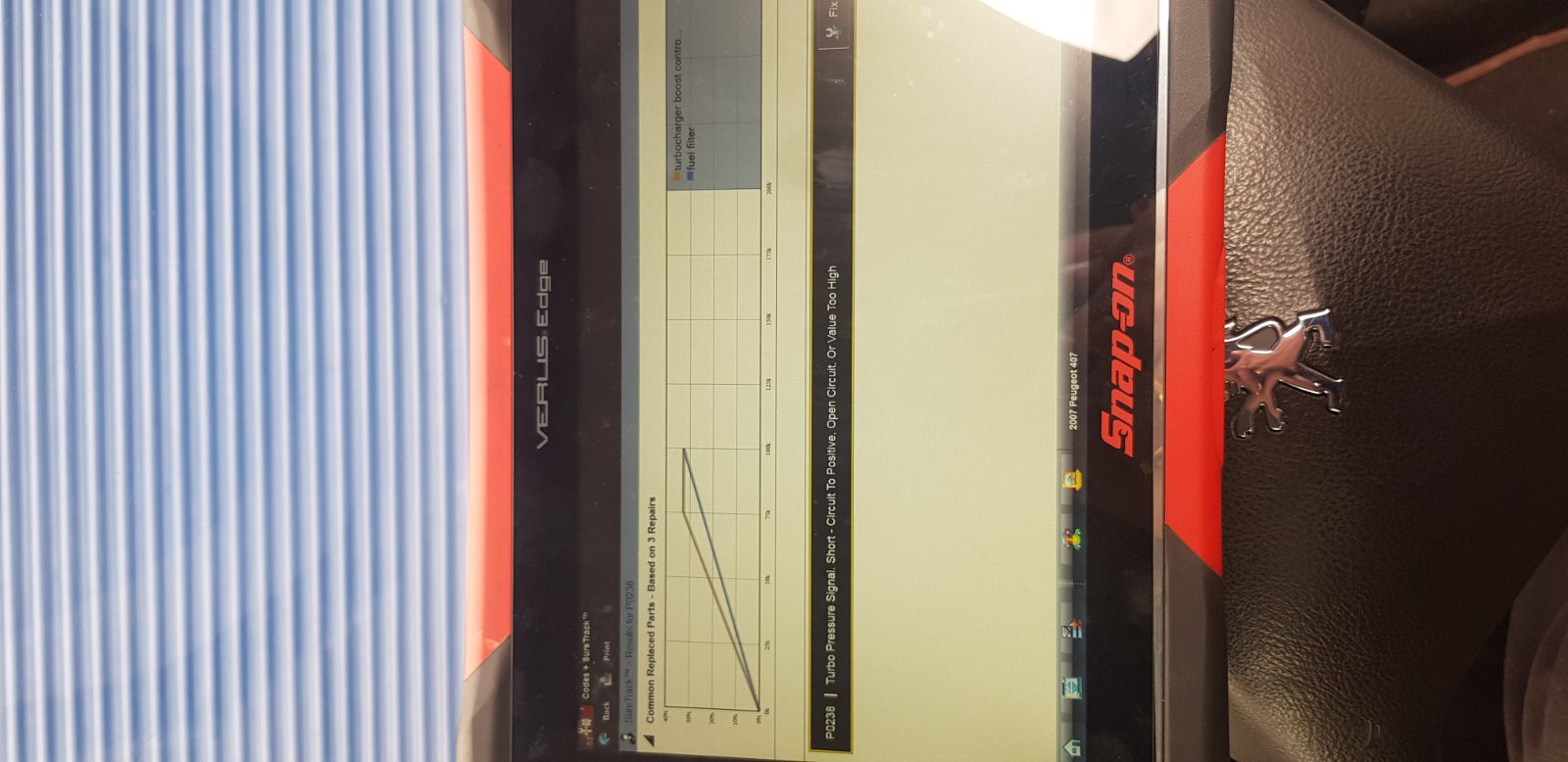

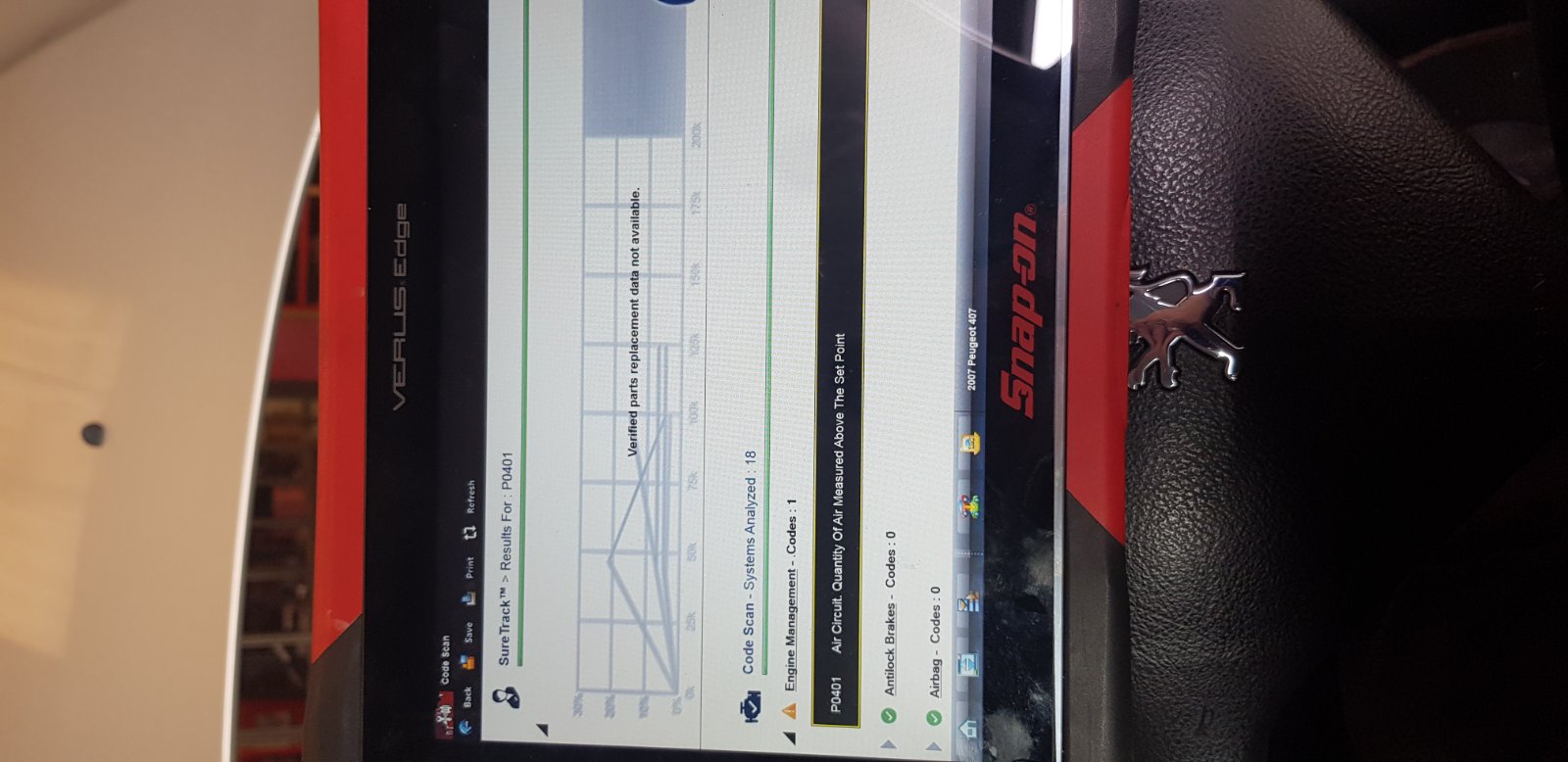

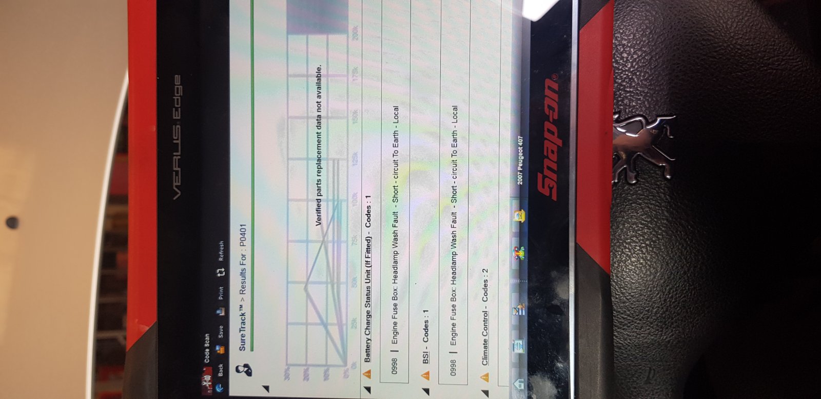

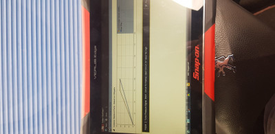

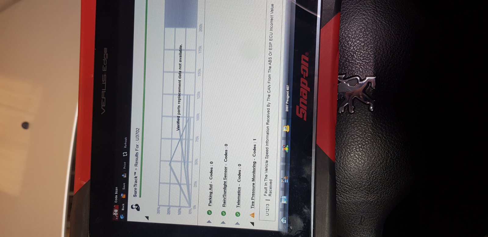

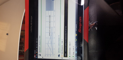

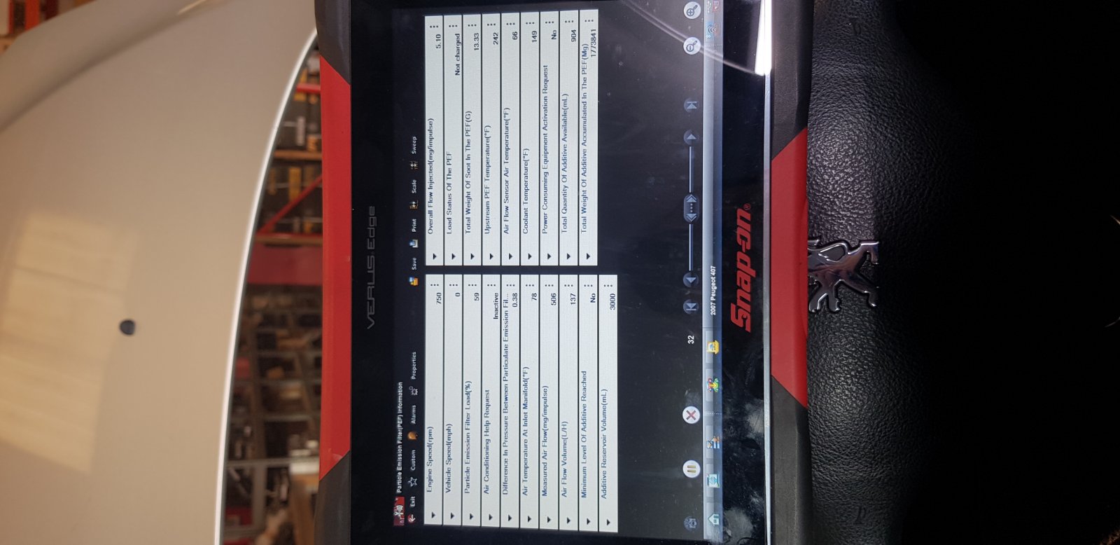

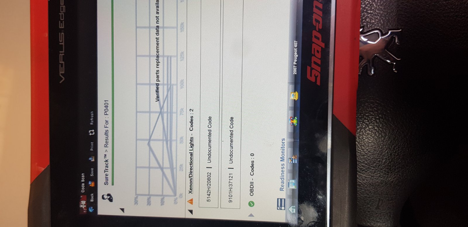

Sorry it's been a while since I last posted. Between work and my house I've hardly had time to do anything.
Looked into things a bit more and replaced the mass air flow and intake pressure sensor.
That cured the first fault on the pics I'm posting, which hasn't come back although I have blanked the egr off.
There's a couple of other codes, I'm unsure on the passenger compartment one??
And then in the final pic, just when I thought all was fixed..... new one appears about turbo solenoid. Why is it I fix one thing and another appears ffs lol

Now I'm officially annoyed
Thought everything was well and I'd finally got it behaving as it should. Yesterday noticed a very slight hesitation again on initial start up, but after pulling away from the house it wen't away. This morning, back to it's old self, hesitation is back. Damn thing nearly got itself written off doing it as I tried to nip out quickly on a roundabout near work. I give up, don't know what the hell to do now
