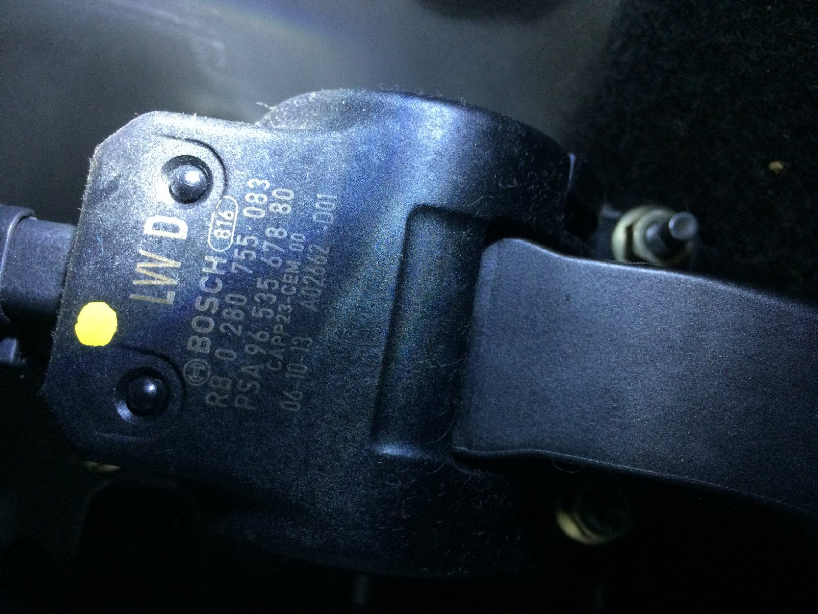

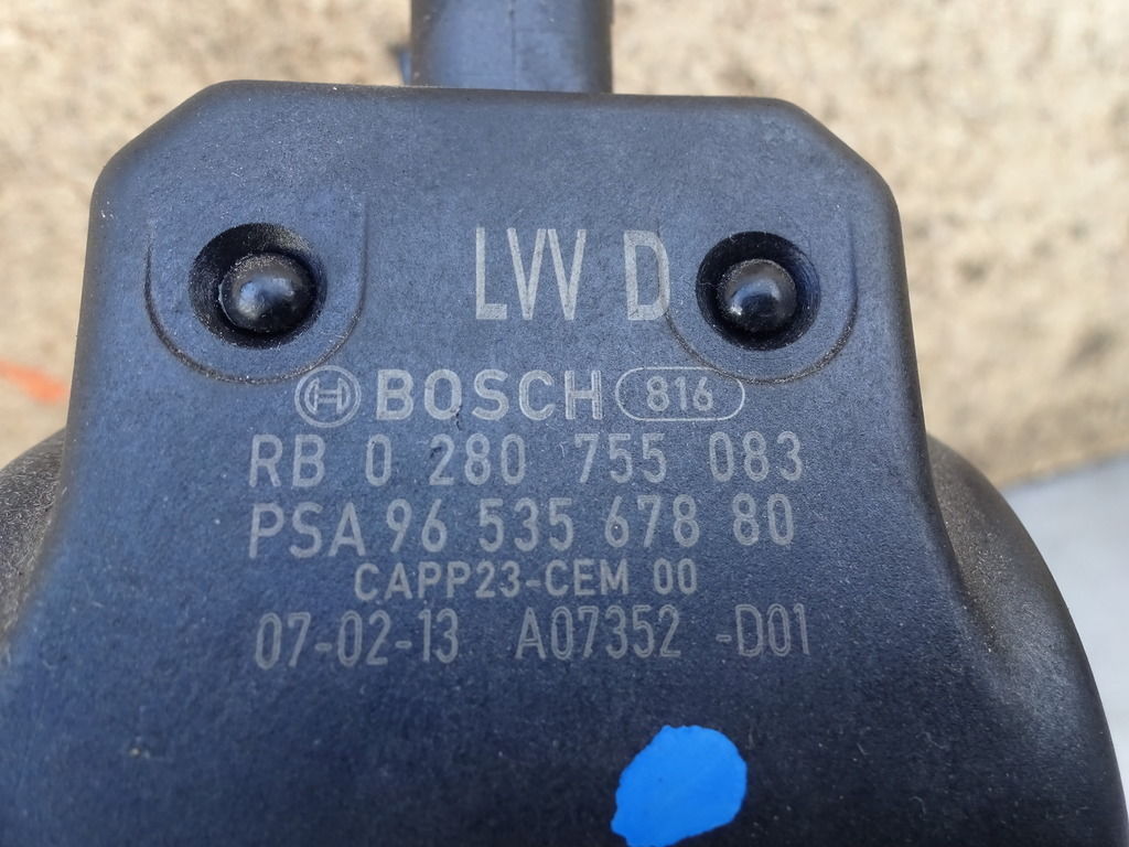

I've been looking at accelerator pedals on Ebay and without the Citroen part number in any of the ads it is difficult as all the numbers shown on most of them are a lot different to those on my pedal. However, I've found one from a VTS HDI which has the PSA number and what I think must be the Bosch number both the same as mine. Anyone tell me if it will work with my car? It's £30 which while more expensive than many of them is still worth a try.

I think you have little other choice than to go for it at that price - looking at others I see that 1601 V6 is the standard one and 1601 V7 is the aluminium one - so I would give it a go. You can always slap a bit of Bacofoil on top of the pedal for effect if desired

I just made an offer and bought the pedal for £25.
