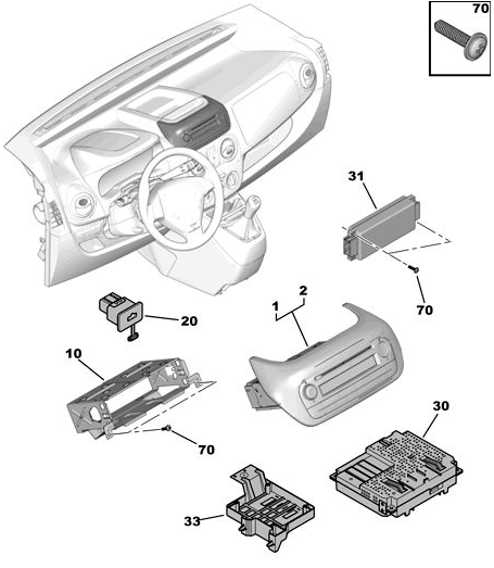

The part for the telephone interface unit has been replaced 3 times on the Bipper: 1613696780, item 30 below, cost £455.10 inc. VAT!
So if this is not an option, I would suggest that if you can get somebody with a Lexia and the S1279 module, that they could de-install the unit, which would at least stop the flashing.

Telematic units are part of the Head Unit - but if you mean the Bluetooth Hands Free unit then it's under the seat possibly passenger side on a RHD, but you'll have to check.
