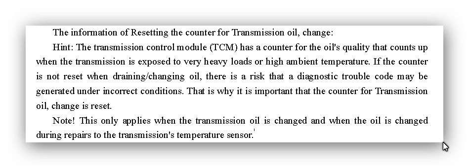

I am going to do two changes this weekend (2 x 3+ litres) and have a question that hopefully one of you will be able to answer.
Do I have to reset the oil counter? I know I have to check the oil temperature between changes to ensure the oil is warm enough, but what is the reason behind resetting the oil counter, I have seen one video where once it was reset he typed in the same number before the reset, why?
Thanks in advance - Stu

Re: Asin 6 speed auto - Clunk
The book says to reset the oil counter but I didn't bother with mine and there seems to be nothing gone amiss.
I assume that it will be to do with the diagnostic kit reporting faults that it's needed to be done, maybe it misleads the kit somehow if it's not done.
This from a PDF on the Volvo site.
Sloppysod wrote: 08 Nov 2017, 12:34 I am going to do two changes this weekend (2 x 3+ litres) and have a question that hopefully one of you will be able to answer.
I reset mine to zero as it makes sense to inform the gearbox ECU of the oil change, that way it may tighten some of the solenoid timings or something (I'm not sure). I'm not sure how essential it is though, but saw no reason not to.
My AM6 was flushed, and there was nothing done with computer. Gearbox works just fine after that, so I don't think that resetting is very necessary. A bit same thing than with changing the battery.
- x 6950
It is a preventative measure - to tell the ECU that the oil has been changed. The ECU software adjusts the hydraulic valves and actuators which operate the gearshifting to allow for the deterioration in the oil. Not doing this will likely mean rough shifting or other problems in future. That is why it is done.
