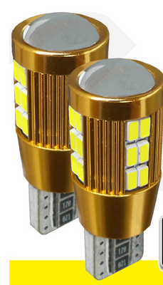

Then there are the 'Side Lights' - the innermost position of the cluster. These are a weird type but basically take a W5W stock bulb - yeh, right! Those went straight away, and I now have some of these that I have just fitted. I'll try and get a picture later on for you to see at night:
The design of the light housing and reflector prevents head-on glare as the beam is scattered behind and around, with the front of the bulb blocked by the silver dome you can see in my original picture. So it gives a good dissipated white colour without dazzling oncoming traffic.

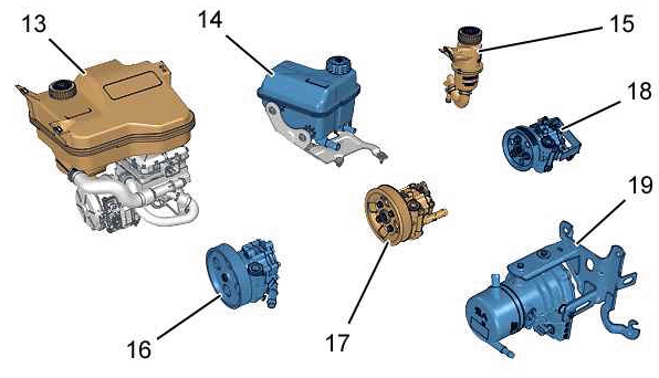

Re your question on the Power Steering systems on the X7 Elis:
Both yours and my cars have items 13 and 19.
13 is the BHI (Built-in Hydroelectronic Interface), housing the ECU and pump for the suspension system. 19 is the Electric Pump Unit incorporating the ECU. This provides varied assistance as a function of Vehicle speed and the
Speed of rotation of the steering wheel.

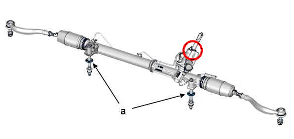

Re the steering rack issue: The area we talked about is circled - this is where water can collect and start rusting.

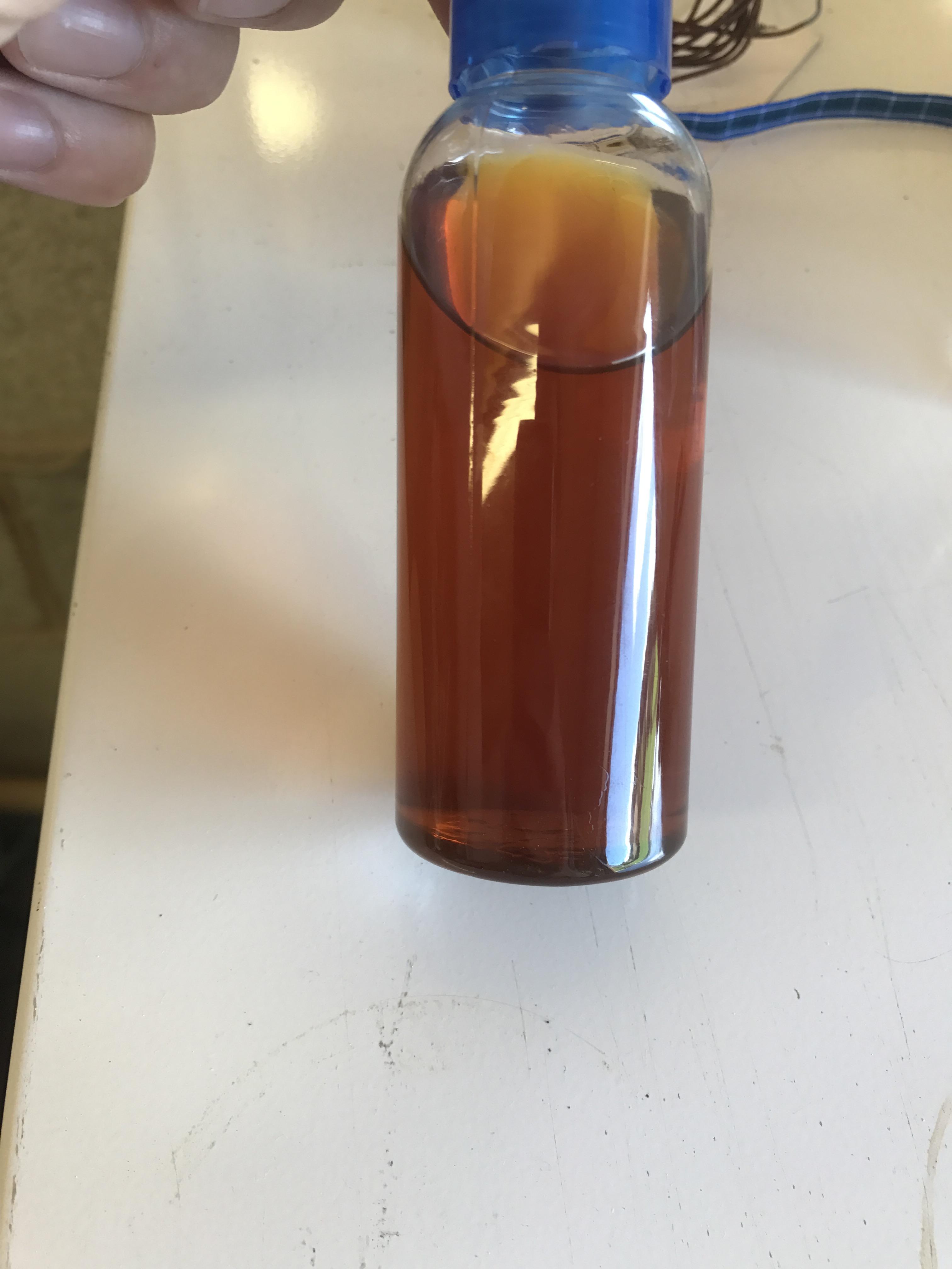

Extracted a sample of my LDS.... does it look a bit off?
Posts: 28691
x 5674
Re: C5 X7 Hydractive 3+ Possible Fault
That looks OK to me but then it has been years since I added any.

myglaren wrote: 23 Jul 2017, 14:34 That looks OK to me but then it has been years since I added any.
Great.
I can't explain how much better the car rides with the correct level of LDS in the reservoir but it seems much "floatier". As someone new to hydractive suspensions, I thought the ride was good before but nothing amazing, now I feel the car is giving a superb ride, especially on potholed roads. Also, the difference between "sport" and normal is more distinct now.
