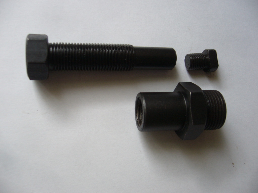

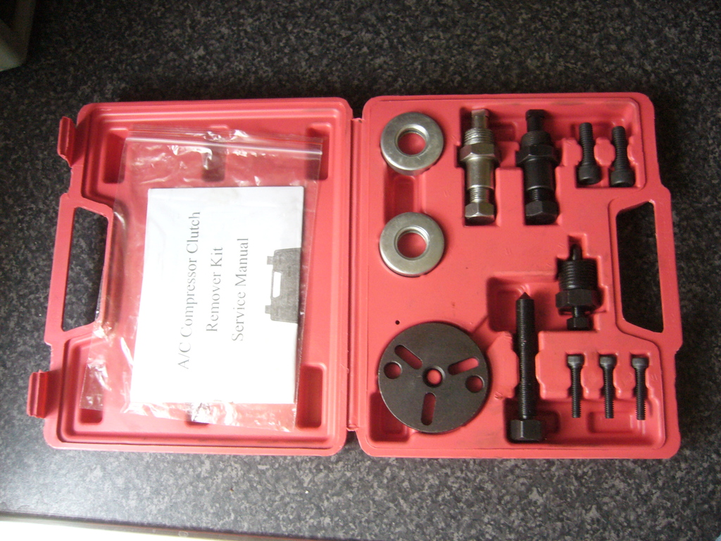

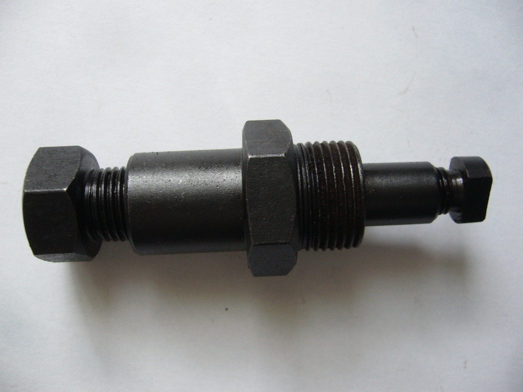

Sory for delay Jim but see below for the A/C pulley puller I have:
The main body of the puller inserted into the boss of the pulley ok but when I tried to then insert the inner bolt (With the end piece attached) the threads would not engage, because of the smooth shank before the treads... I thought about removing the piece in the end of the bolt but that would have damaged the end of the bolt and also the thread sticking out of the middle of the A/C pulley. This is when I decided that either I did not know how to use the puller properly or that the puller is not suitable for the job!
I hope the above makes sense.
Sorry I didn't get a chance to take pictures of the A/C pulley but will if you require. The Compressor is a Delphi I believe!

Ahh, I did not realise you had the full kit Grum... I can see exactly the problem...
It's often the case with universal kits like those... They don't quite cover all eventualities.
That you have the correct one to screw into the pulley boss is an excellent start... It would not be a lot of work to make up a new and more suitable centre bolt on a lathe... I'd expect the bolt has a standard ISO Metric coarse thread so a standard bolt could be modified...
Maybe a little case-hardening on the end of the modified bolt and away you go...
Then you'll need a hydraulic press to remove and replace the bearing proper...

CitroJim wrote: 01 Jul 2017, 16:21 Ahh, I did not realise you had the full kit Grum... I can see exactly the problem...
Great, so I have a full kit but it won't do the job ... Hufff
Ho-hum ... I'll have to go through my big box of old rusty nut's and Bolt's and see if I can find one that will do the job some time.
I assume that the tool simply presses on the centre shaft that the small nut is on
Thank's again Jim ... If you ever wan't to borrow it, especially after I find a center bolt, don't hesitate to ask but I still need to get transport sorted out beforehand!
Grum
- Posts: 55222
- x 8466
Re: Xantia Rear Window Wiring Diagram!
Yes, that's correct!Grum wrote: 01 Jul 2017, 19:36 I assume that the tool simply presses on the centre shaft that the small nut is on![]()
Grum wrote: 01 Jul 2017, 19:36Thank's again Jim ... If you ever wan't to borrow it, especially after I find a center bolt, don't hesitate to ask but I still need to get transport sorted out beforehand!
