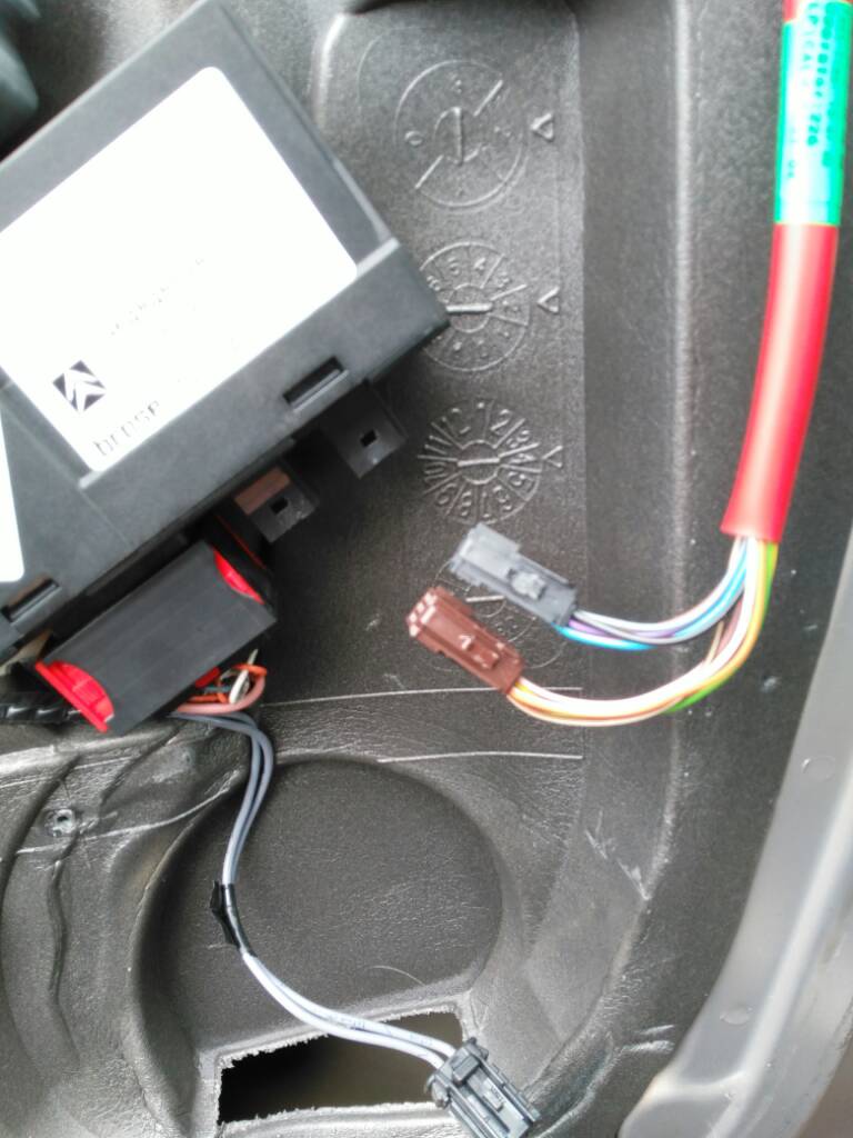

Ah well best laid plans and all that. I honestly thought there would be a plug and socket arrangement 'twixt door and A pillar where I could check the pinouts. Unfortunately there is just a corrugated rubber tube with the cables inside. I can only think that my mysterious "interconnection" is inside the door so tomorrow weather permitting I'll remove the doorcard and see if I have power.

Those rubber protectors should just pop out so you can see if there is a break with one of the wires.

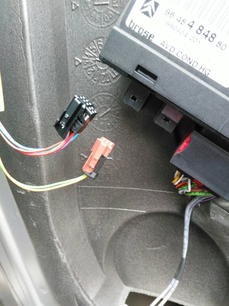

Re: All change at demag towers.
An interesting day. I took the drivers door card off and found the cables disconnected. I reconnected them and the driver's mirror worked. However the passenger door mirror was still dead and the temperature display was still blank, so off with the other card and two connectors off that side as well. All back together now and working apart from the passenger mirror not folding out but folding in ok. But I noticed the cover is not fitted correctly. Causing an obstruction? Maybe. I'm not sure how it comes off, will check.
That's bizarrely odd Dave...
Those connectors don't just come apart on their own...
CitroJim wrote:That's bizarrely odd Dave...
even if one did I can't imagine all four disconnecting themselves.
Suspicious!
