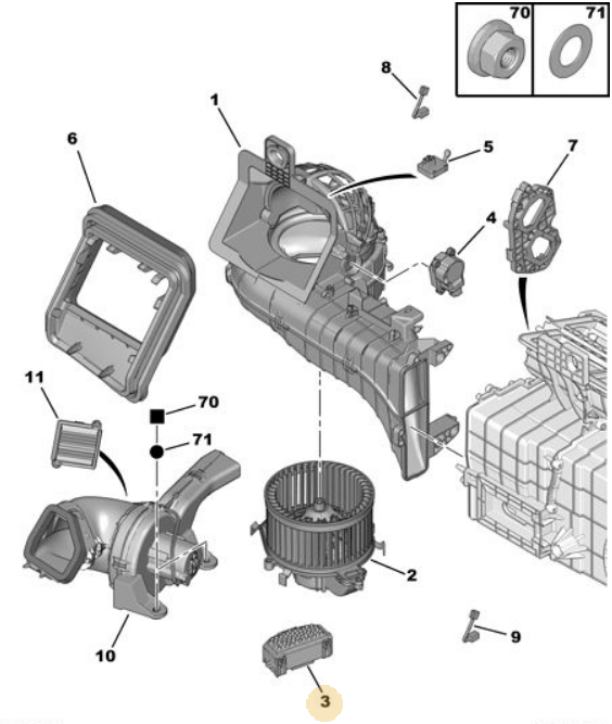

Thank you for your quick response. I think my problem is elsewhere as there is no power going to the blower at all. Have thought that the blower had gone dead so have purchased one on eBay, had it connected and nothing happened. Then I had the multimeter out and realised that no power is getting trough. All fuses were ok, read a bit more and found that the fuse box is the blame, replaced that but still no juice going to the blower . Then I had it tested with 12v direct and it does work. So somewhere the power is stopped, have checked the wires but they all look in good shape. I am thinking to run a fused direct line from the battery to the blower and put a switch to that if everything else fails. It is raining badly and very quick the condensation gets the windscreen in a mess so I have to open the windows and more water gets in.... Here is the VIN VF7**************[VIN obfuscated, can be read by forum staff]
- x 6945
Re: C4 heater/air con not working
So this is your setup: Item 3 is the Blower control module for reference - however, this is supplied directly by Maxi Fuse 6 in the engine fuse box.
So I would check Maxi Fuse 6 in the engine fuse box - this is a 50A. So if there is no power to it when connected it could be the maxi fuse that has blown. MF6 does not seem to supply anything else.
I don't really recommend a direct wire up, as this system is linked to the A/C ECU control and the BSI via the CAN network and may have implications down the line....
Try to see if you can identify the cause first.

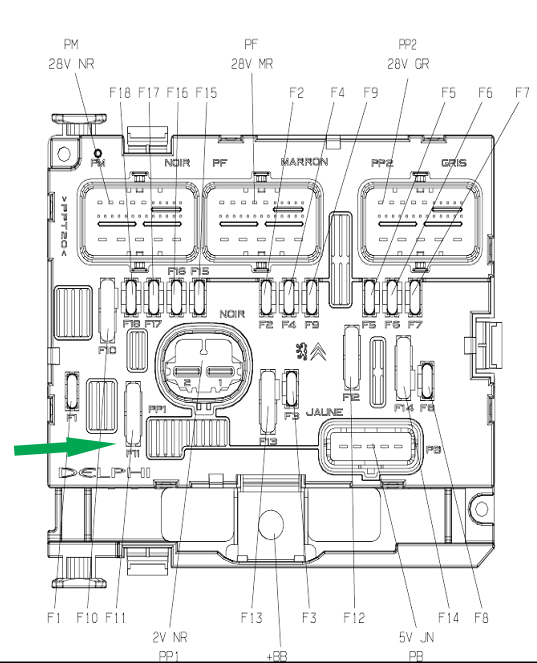

Ok, so if we know the blower motor is working under direct control - there must be an intervention in between that is preventing the power getting through. A diagnostic with diagbox would probably help at this point, given the tight integration of the system with other components.
Here is the wiring diagram for the heating system for your Picasso.
8045 is the actual Blower Motor.
Wire 8018: blower control module requirement
Wire 8019: blower control module diagnosis
Wire 8020 : air conditioning motor control
Wire 8020 above goes to 8048 which is the Blower relay
Wire BF01B: is the wire that goes to Maxi Fuse 6 that you say you checked as being OK.
Wire BM11B: (11 fuse server unit) is the internal relay (R7) of the engine fuse box.
Looking at the diagram again - I can see that Fuse F11 in the engine fusebox is for the blower relay So definitely worth checking that. It should be easily accessible and is located here where I have arrowed it in Green:
