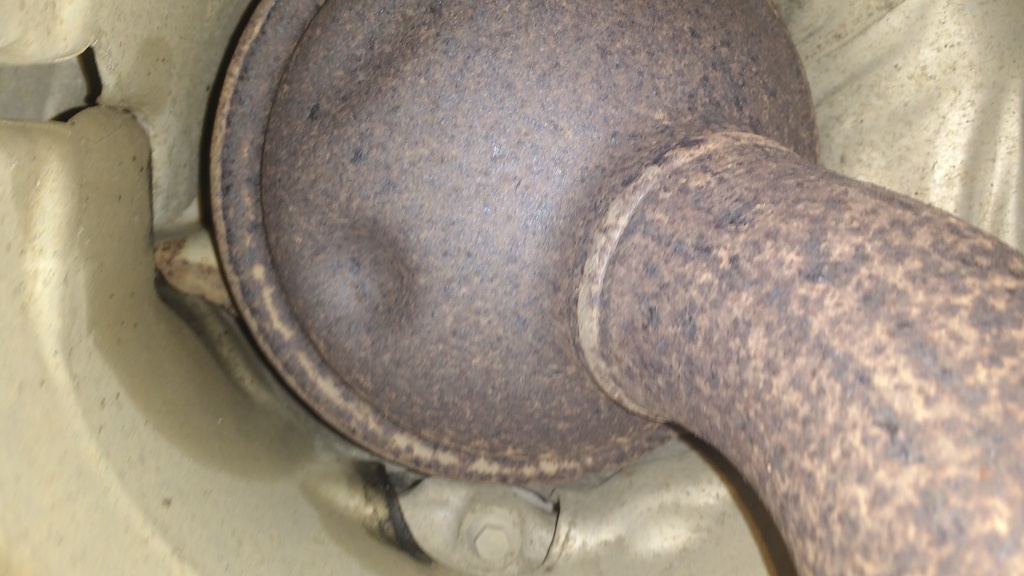

I do think it has a dpf though, it looks like it's bolted right under the turbo with the cat - I think - under the sump. I will leave the oil feed pipe till later in the year when I have more time, not ideal I know, but just don't have the time. I am going to change the oil as suggested above asap, to make sure anything left inside is the proper stuff - Total low saps.

No DPF - the bit you can see under the sump is just a flexi.
