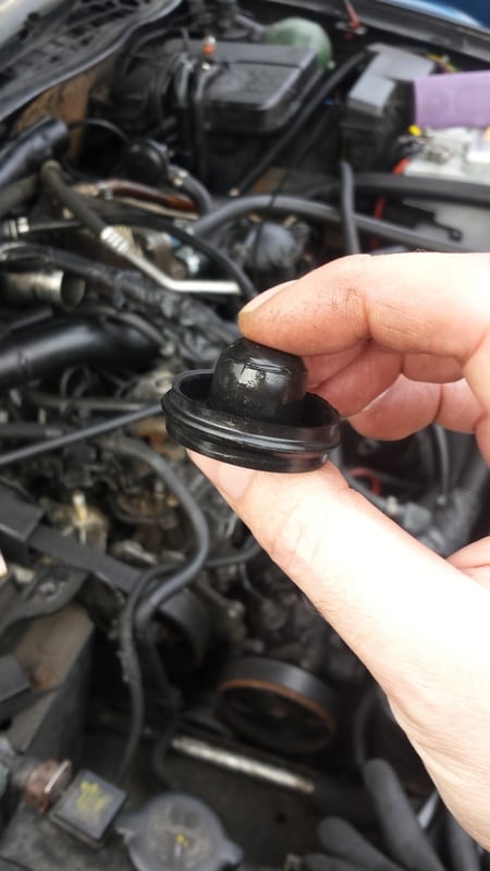

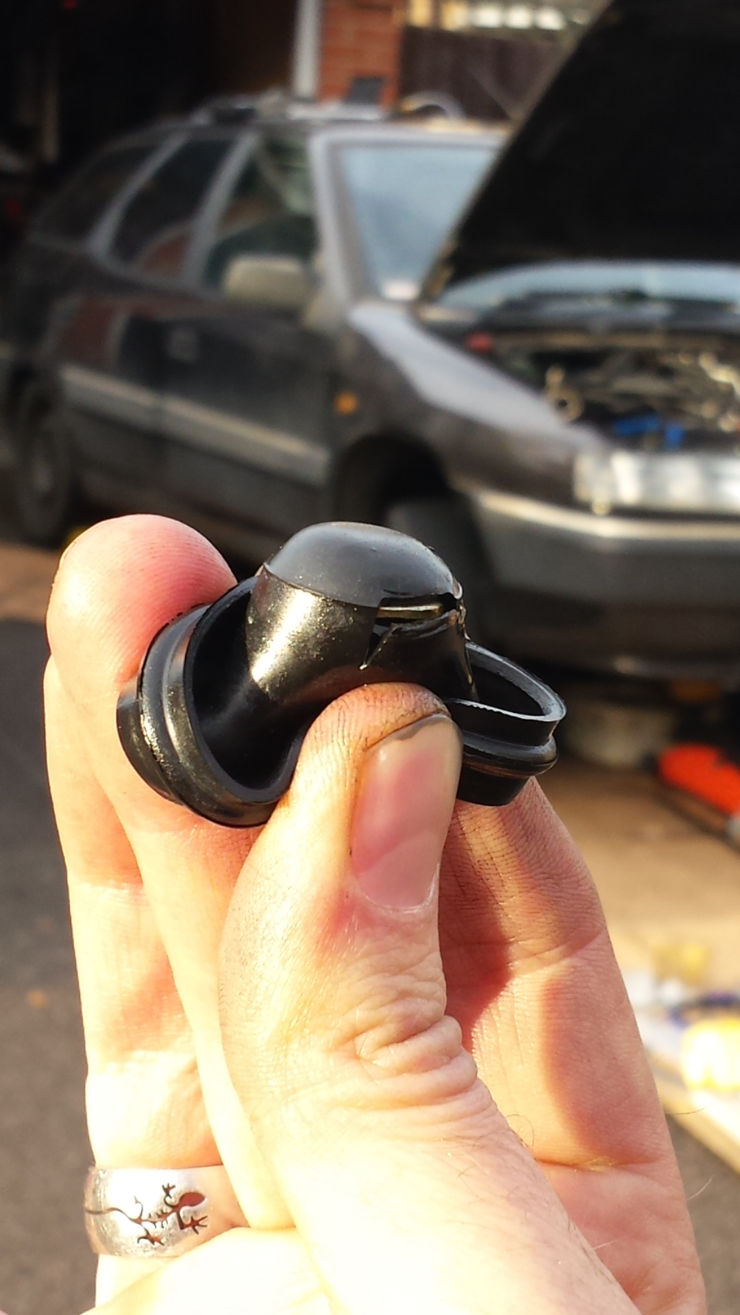

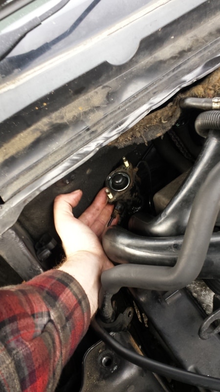

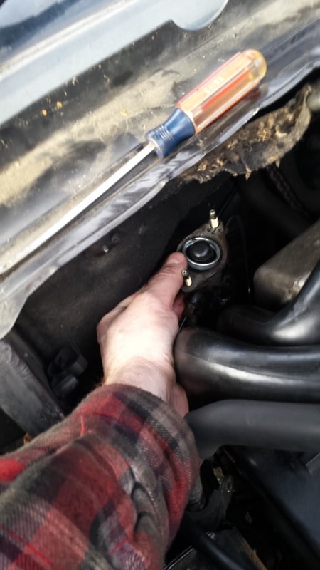

SOLVED!!!! Again! :p
Thanks again to the late Citronut :/
Got the correct parts and did the job in one go without having to put everything back together and - repeat. (That would have been nasty!) :I
Anywho

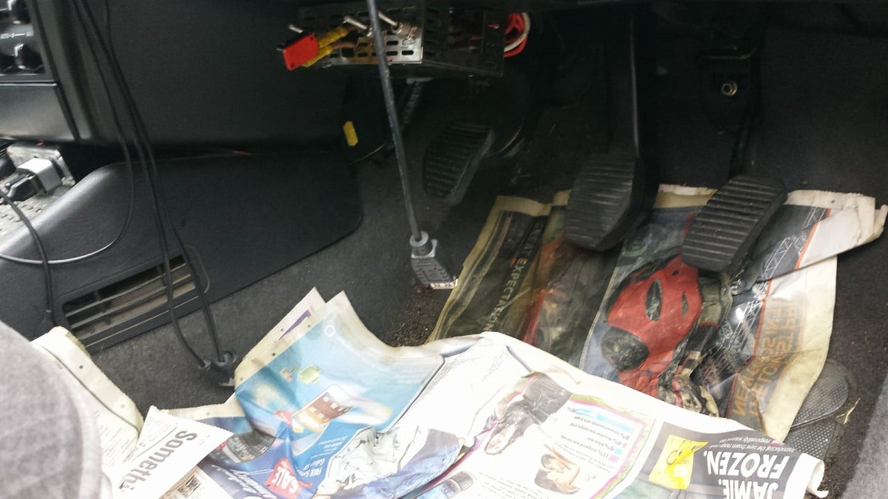

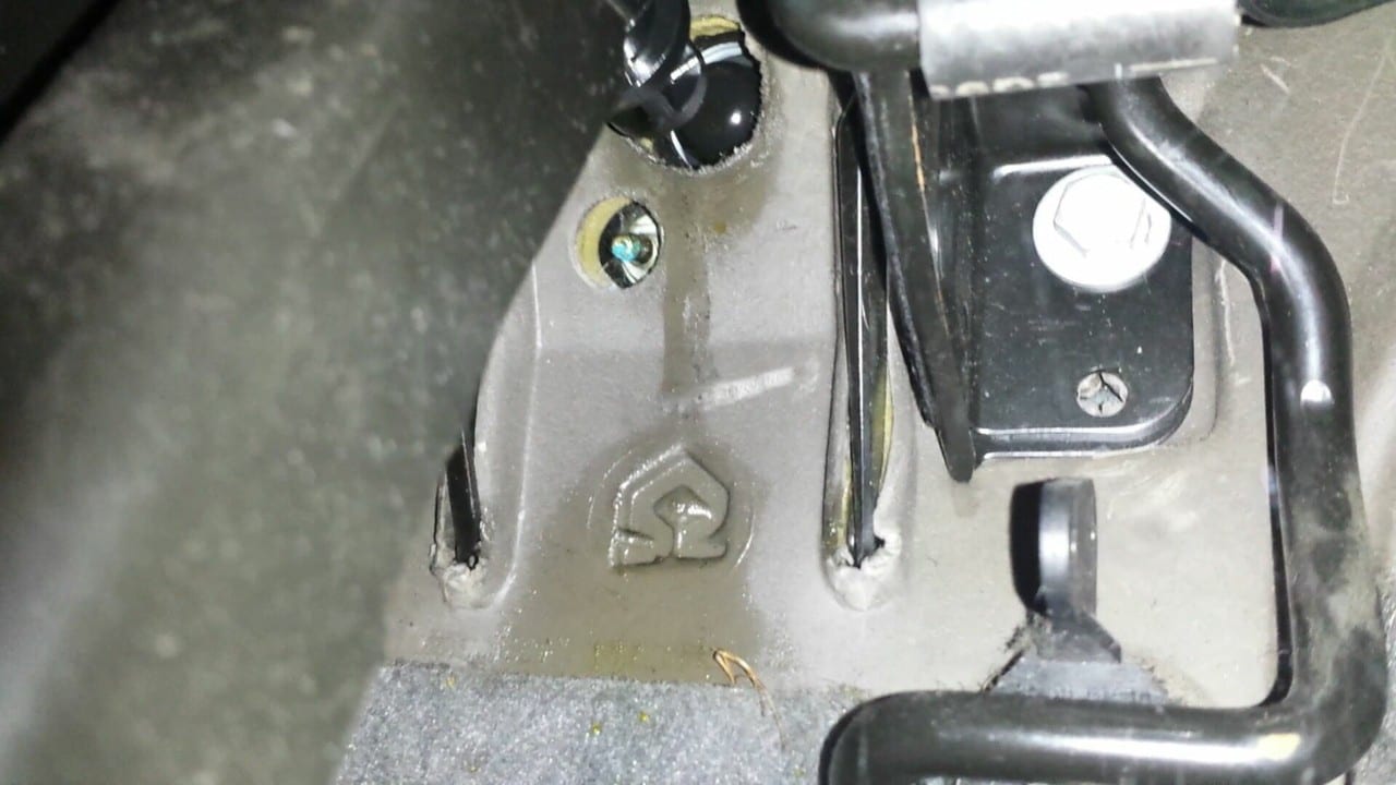

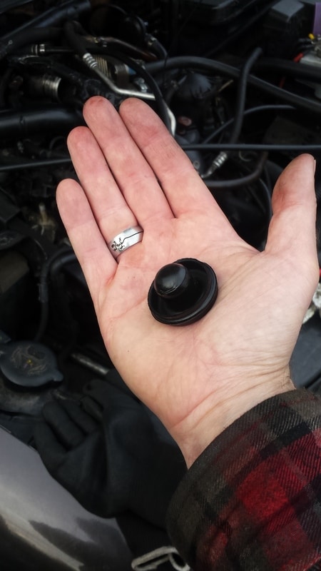

Brake Control Unit leak repair!
Slippery feet - hmm
Pool of hydraulic fluid temp repair with NEWSPAPER! HAHA
after reading all Citronuts posts on this and ordering parts...

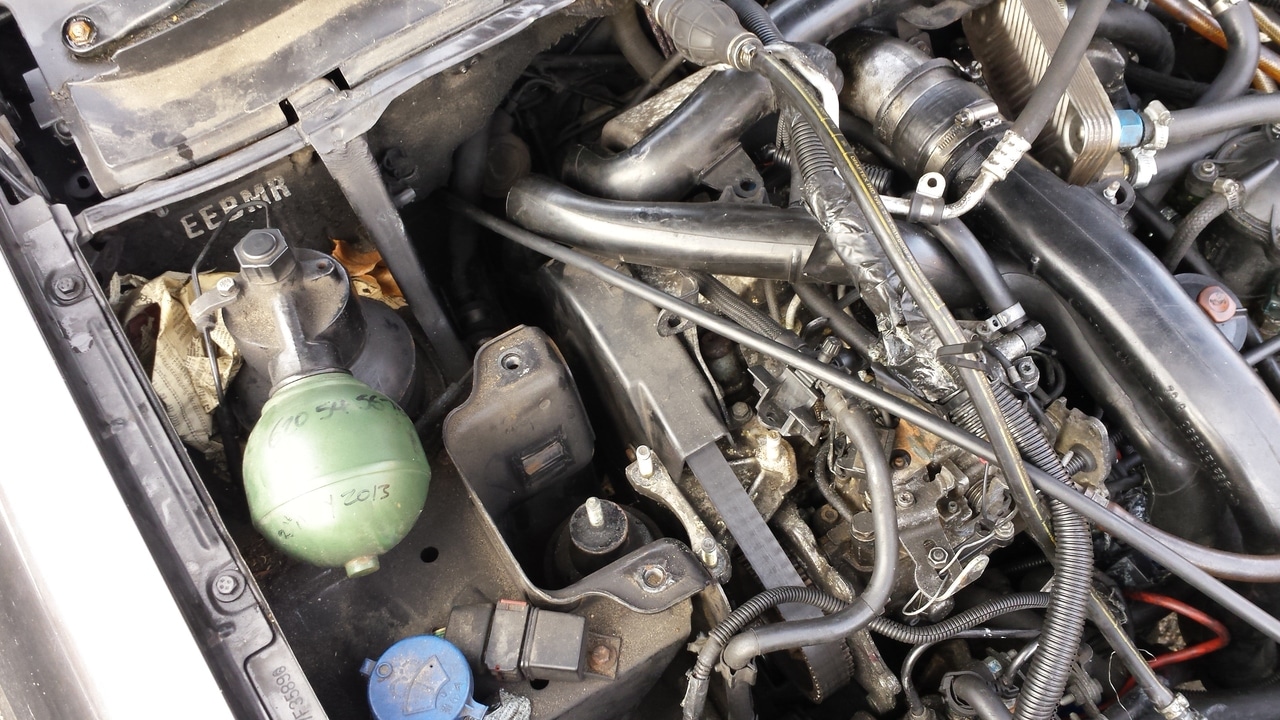

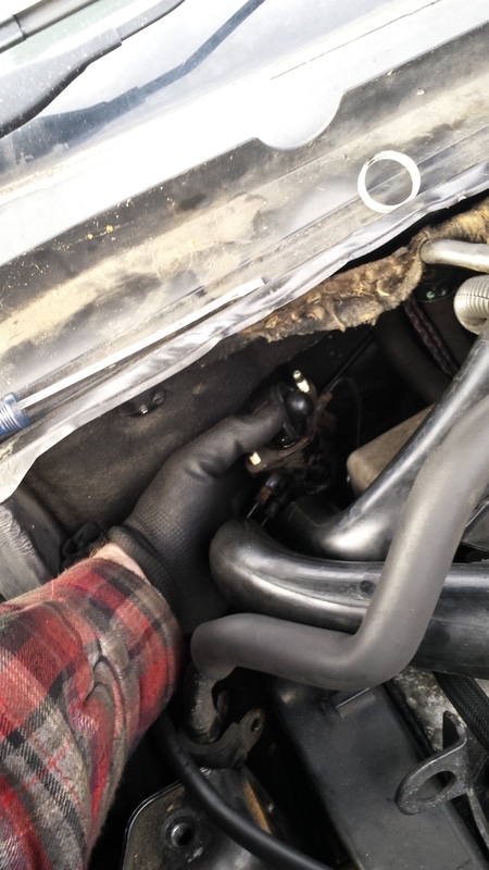

Off comes the engine mount as the doseur valve is wedged between the bulkhead and the back of the engine :(
As mentioned by Citronut, I twisted the Control Unit around 'carefully'
One ring to rule them all comes off
Finally access to the Brake Control Unit Protector!
.. nothing seemed wrong here....
hmmmm
AHA! You little bugger! YES! Love it when you can see the blatantly obvious issue :)
Reassembly is just the reverse.... oh, and a minor detour with having to repair the split low pressure return LHM hose I split turning the unit round ~ oops.
:D ace

Excellent work Romie :D This is an excellent guide to the job. I take it you removed the engine mount so that the engine could tilt forward and give more access to the dosuer valve?

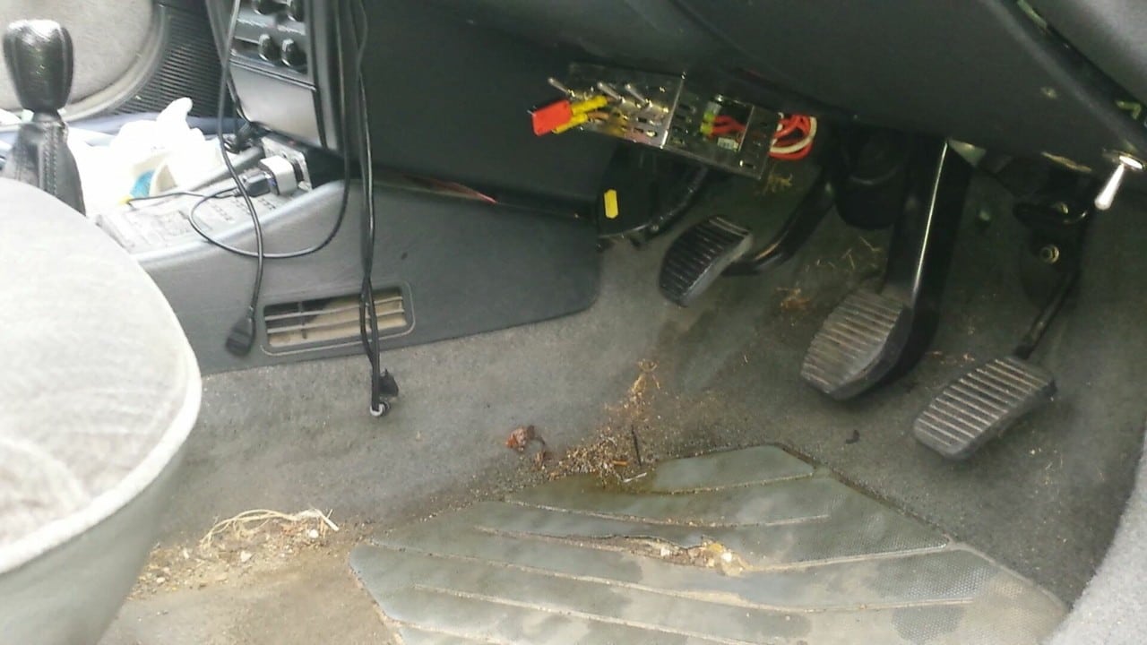

What's the purpose of that box of switches under the dash?

CitroJim wrote:Excellent work Romie :D This is an excellent guide to the job. I take it you removed the engine mount so that the engine could tilt forward and give more access to the dosuer valve?
YES, exactly. I put the car on jacks, removed the upper and lower mount and dropped the engine as far as it would go, (basically hanging off the mount on the other side.).
It was a VERY tight squeeze still.
I depressurised the hydraulic system first.
Then I moved all the aircon pipework out the way as much as possible and just managed to turn the unit around enough.
I split one of the low pressure return pipes when I did this, but just repaired with a couple of cable clamps and a bit of hose I cut from a spare strut lhm return pipe.
The switches?
Haha, I've had them on there for three years now
It's a result of my frugalness.
Put it this way, a replacement ignition barrel would cost a hundred odd quid. (old one finally died from having to switch the heavy current fan loads if I remember rightly).
I looked at the ignition switch wiring and realised I could just replace it with three toggle switches and a push button ;) hahah :p
So that my ignition box
MOTs are fun, I need to teach them how to fire her up :p

romie wrote: The switches?
:lol: Excellent. I love it and what an excellent idea :-D It would defeat any potential thief too :wink:

CitroJim wrote: :lol: Excellent. I love it and what an excellent idea :-D It would defeat any potential thief too :wink:
Ah, not shown in that pic is, believe it or not, I actually put some time into fitting my own immobiliser circuit in there as well! :p
Opportunists would never be able to start her, (although the fact she's a nice shade of Metallic Poo Brown and looks in a right state, that's an anti theft deterrent in it's own right! haha ;) (I should get money off my insurance just for her looking the way she does! Wonder what that'd be classed as? hmm ))
