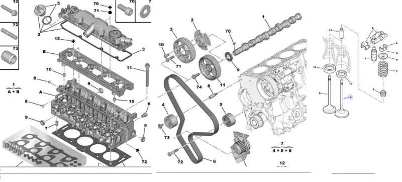

...bit more minor work done.....removed the brake vacuum pump from the right hand end of the camshaft as per page 9.13 of my Haynes.....yes a 3-spanner job done very straightforwardly. In reality its just unscrew 2 10mm bolts and a threaded stud with a 10mm hex on it at the bottom and off it comes, noting the 2 o-rings which will need replacing.
The whole purpose of this bit is to examine the rocker arms and associated components, to see if any have been damaged in the glow plug tip incident cylinder number 4. Camshaft and its "upper Housing" (no 8 on the left of the pic), have to come off, but I am wondering whether I really need to take the camshaft pulley wheel off to achieve this.

You don't need the cam wheel off you can lift out the camshaft with it still fitted.

Thanks Gibbo the next stage is to remove the 12 little bolts holding the housing on, ease it of its dowels at the front and lift it away with the camshaft.....and see what's revealed underneath. I am hoping in some way that the rockers are broken on cylinder no 4
