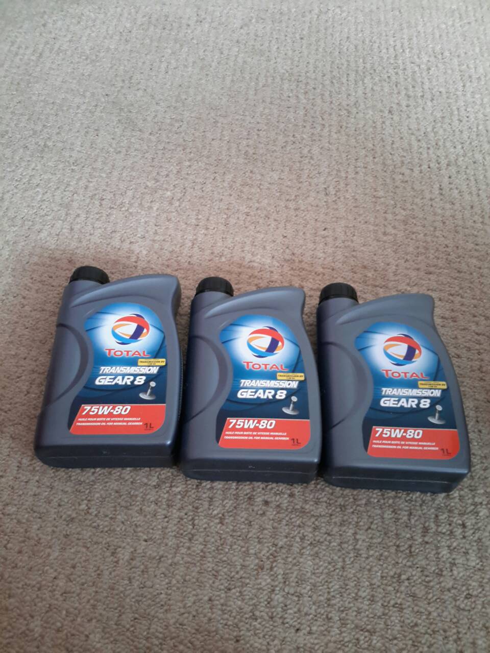

daviemck2006
- Posts: 5033
- Joined: 04 Dec 2010, 18:45
- x 496
Re: Activa clutch
The first delivery. I'm waiting to get all the bits I need before I get the car transported down the road. I can't find the guide tube and seal that I'm advised to replace also.

- Posts: 55061
- x 8386
Re: Activa clutch
Beautiful, that's the right stuff Davie
