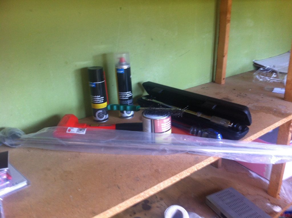

Thanks guys, I went shopping today:
breaker bar, rubber weighted mallet, wire brush, caliper file, caliper grease, copper grease, brake cleaner, and a torque wrench.
Also had the wheels off today, used the WD40 on the bolts a couple of times, and used the wire brush to clean them up too
Will be trying to do that every day now up until next sunday, when we will be doing the work

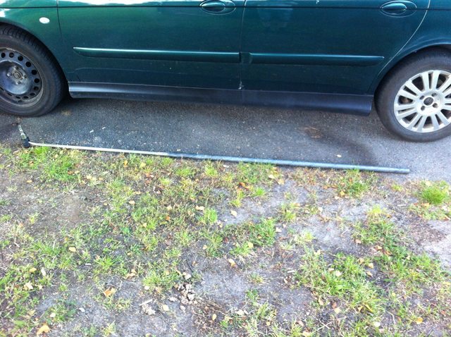

Got the cheater bar from the place Steve suggested - thanks Steve
Car in pic for scale lol
