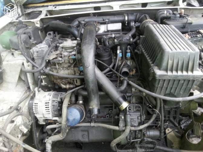

We have been offered a complete Xantia lump for 150euros - about £110 - its only an hour from us and while the km is a bit high , it recently had a timing belt kit + waterpump, plus accessory belts.
We are not atall familiar with xantias - but in the photos the starter motor pokes out to the right (are we correct), whereas in the Boxer as in the 306, ZX and Xsara the starter is on the left of the box .
The engine should be good for us - however - is the sump the same, as in the photos it looks to have a bump near the starter - but the photo is unclear.

Wrong.. xantia engines are typical xud engines.. the starter sits across the front of the block with ring gear to the right into the gearbox on the right...
They are all the same in french cousins... its Rover that used their own gearbox and had the starter in a completely different place to Psa ..

Is it the hydraulic clutch gubbins we can see in the photo then ?

Here is the picture.
Please excuse our ignorance of Xantias.
Whats that lump low down right on the sump where the starter should be - is it part of the gearbox ?

I think you're looking at the pressure regulator, it's part of the suspension system. The starter motor is behind it.

Just to be sure and even more sure...
Just below the oil filter, follow the pipe to the right - first clip bolts it to engine block below a breather pipe , along to right 10mm bolt holds it to aluminium housing just before hydraulic pipe. Below this 10mm bolt is the bump we are talking about - alu but gone a bit green - can it come away to reveal a normal sump ? ~
Feel like a real numpty asking this but the seller hasn't removed the engine yet and we dont want to put him to the trouble of the work if we are not having it.

Yes thats the pressure regulator. Can you see the green sphere below the pipe screwed into it? The whole assembly removes and is as normal underneath. Its part of the hydropneumatic system so obviously not required on you're van.

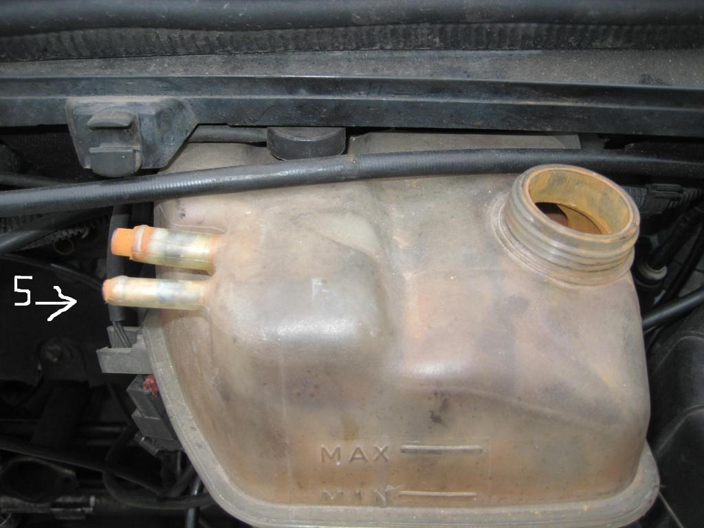

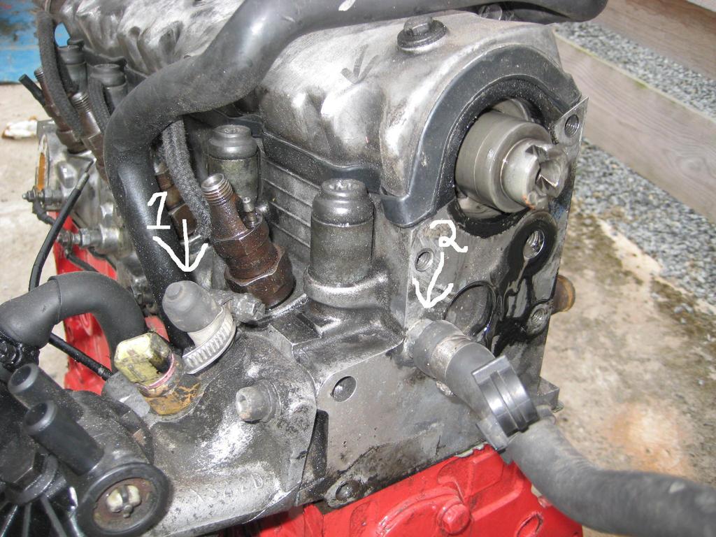

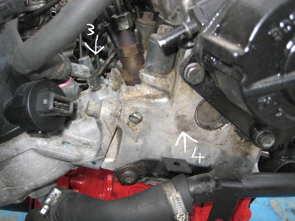

Hello all again.
Got that Xantia engine, found the patience and energy to clean and paint it again, just like the first engine.
Have started to move items from Boxer to Xantia engine and have found a difference.
On the Clinder head in the Boxer Engine there is a pipe out of the head (Photo 1, item 2). The pipe out from below where the diesel filter normally sits (Photo 1, item 1) is capped off.
The pipe out of 2 goes to the expansion bottle (Photo 2, item 5)
On the Xantia engine, there is no pipe or blanking plug in the head (Photo 3, item 4) and the pipe from near the diesel filter is present (Photo 4, item 3)
Can we connect 3 to 5 ?

citroenxm
Fallen Hero
Posts: 8061
Joined: 30 Dec 2004, 23:10
x 70
Re: 1.9td questions
Unread post by citroenxm »
Yes...
No idea why they would drill a NEW bore into the cooling when they had an outlet.. capped off too already on that extra housing bolted on.... very strange.
