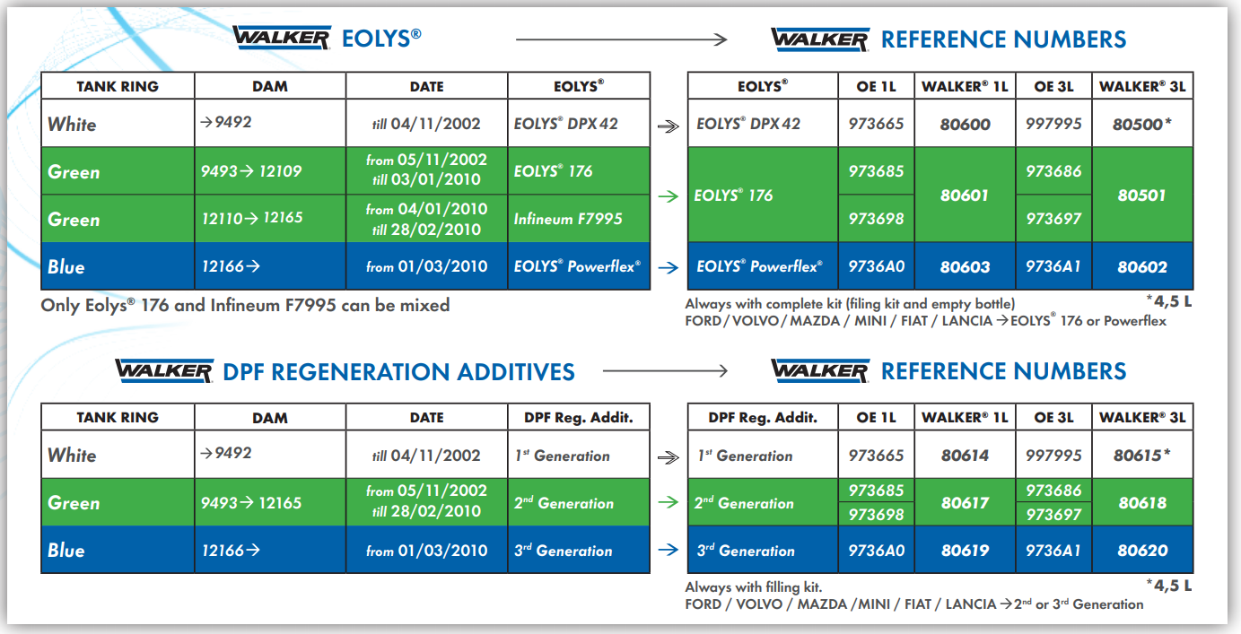

- x 6946
Re: C5 Eolys Question.
No Robin definitely NOT Powerflex! Only Eolys 176 or Infineum F7995 or direct equivalents from Walker or others. Adding Powerflex will bu**er the system up.
I advised Peter already in his other thread when he bought the car. But best to clarify it again.
viewtopic.php?f=3&t=63159&start=90#p616251

- x 6946
That's not what's in the latest document Robin, and seeing that Eolys 176 is already been replaced with Infineum and were the only 2 fluids to be interchangeable, they should not be mixed with Powerflex - it is a totally different additive.
The new 3rd generation particle filter additives
Suppliers and brands:
RHODIA: EOLYS POWERFLEX
INFINEUM: F7995
2. Previous type of additive
Additive DPX 42 is still available and must be used for all servicing on vehicles that have DPX 42.
The EOLYS 176 additive is replaced by the INFINEUM F7995 additive. When current stocks are exhausted, only the new product will be supplied.
3. Compatibility between additives
Additive DPX42 cannot be mixed with any other additive.
Additives EOLYS POWERFLEX and INFINEUM F7995 cannot be mixed with each other.
It's also listed on main sites that again only show the green types of additive as interchangeable (Eolys 176 and Infineum).
INFINEUM: F7995
