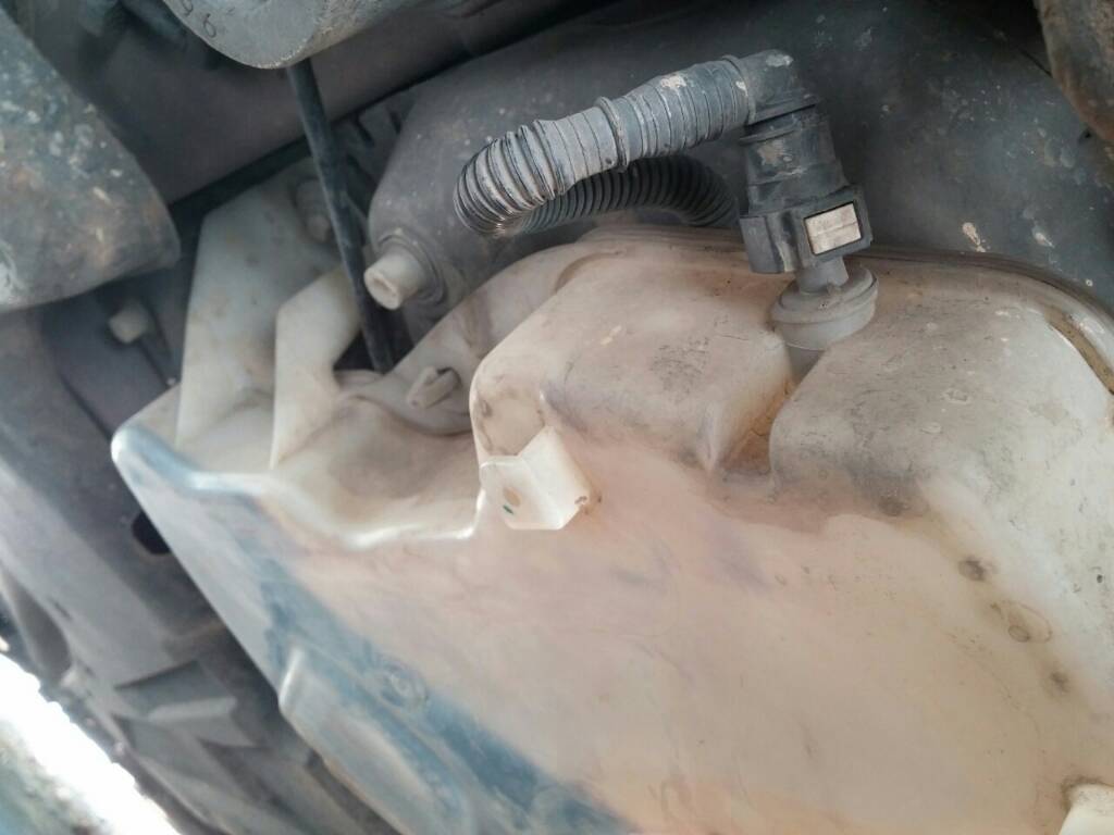

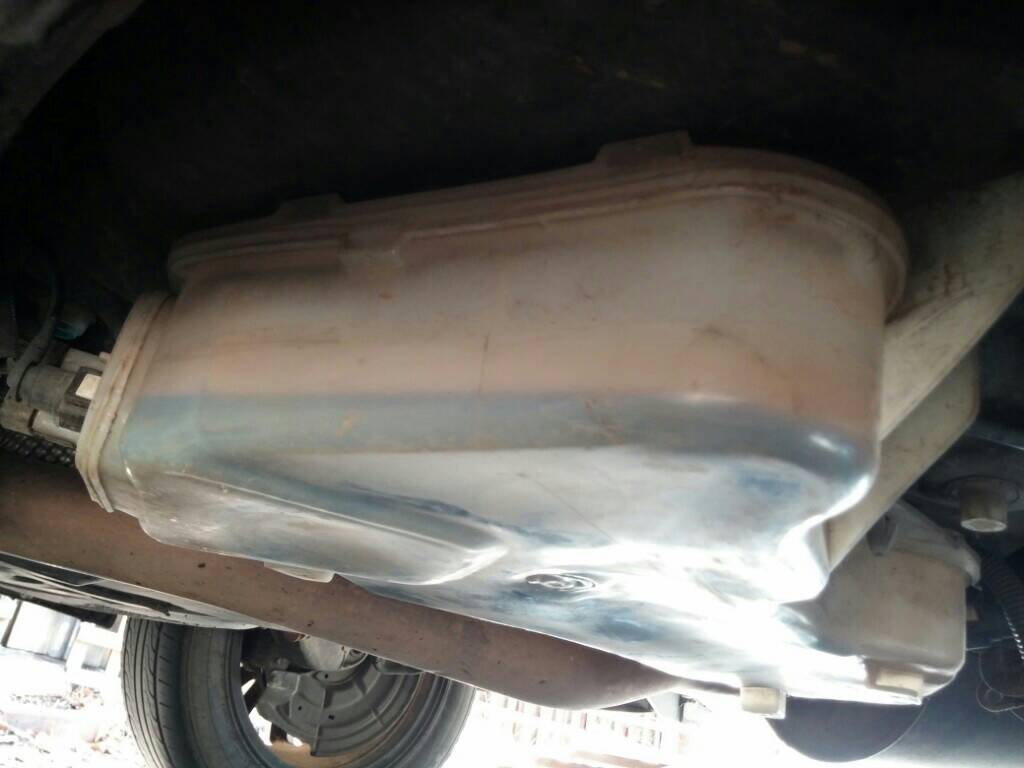

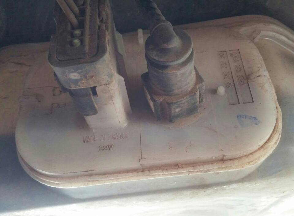

Hi, had the low warning come up awhile ago and am wanting to verify which fluid to use. I have a 2006 2.2 Hdi. My research led me to believe it should be Eolys 176/ infineum, and that the filler on the tank should be green, and not white.
When I had a look the tank looked different the ones I saw online.
Here are some pics.
As you can see there is no green cap and the connectors have white clips not green as I saw elsewhere.
Just want to verify if I have the correct fluid type, please!
Thanks, Leith.

Definitely 176 type on a 2006 model.

Even though white connectors are meant to mean dpx? The RPO is correct for 176 though. I just want to be absolutely sure!

My guess, going only on the 'clickfit' colours, would be DPX42 as your 'clickfit' would match the colour of the cap on the new bottle of additive, but that would pay no regard to how it fits in with your RPO number.
