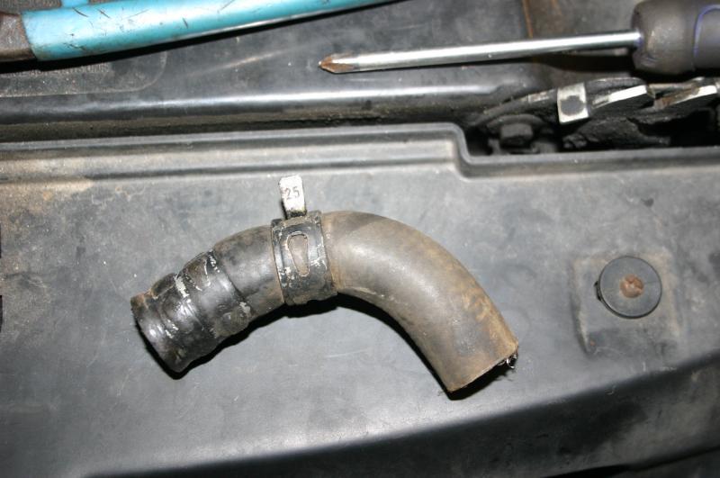

Re: Water preheater-Xantia fitting
Here we go.
I used a 5l container and a short length of hose pipe( make it just the length from rad to ground and it'll sit there nicely) to drain 4.5L of coolant. that was enough to work on the hoses without loosing more than a cupfull of coolant.
Follow the instructions here for refilling. I found it very useful..." onclick="window.open(this.href);return false;
I couldn't fit the heater inline where I wanted it to go, Just in front of the firewall or on top of the gearbox, There just wasn't enough room.
So I decided to cut the original hose and add extensions so that the pre heater would sit just in front of the intercooler/turbo hose. here are some photos.

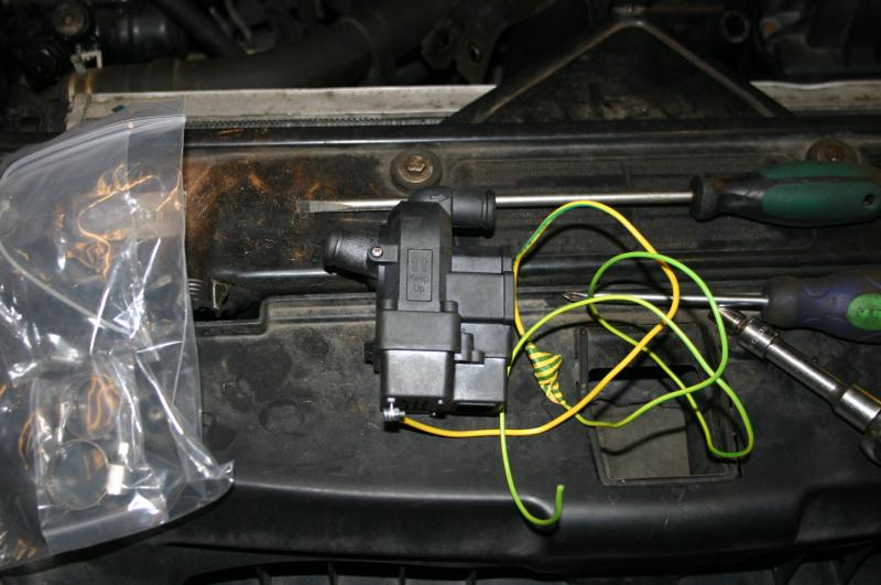

The pre heater

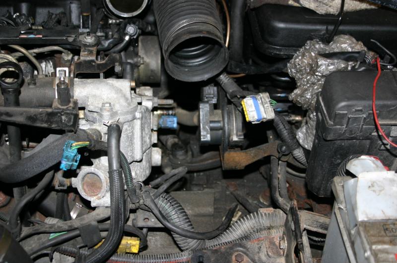

With the airbox, turbopipe and blue connector out of the way you can just see where the thermostat pipe leaves the housing (behind the blue stub and the disconnected hose tucked away to the right of the stub, behind the throtle bracket)

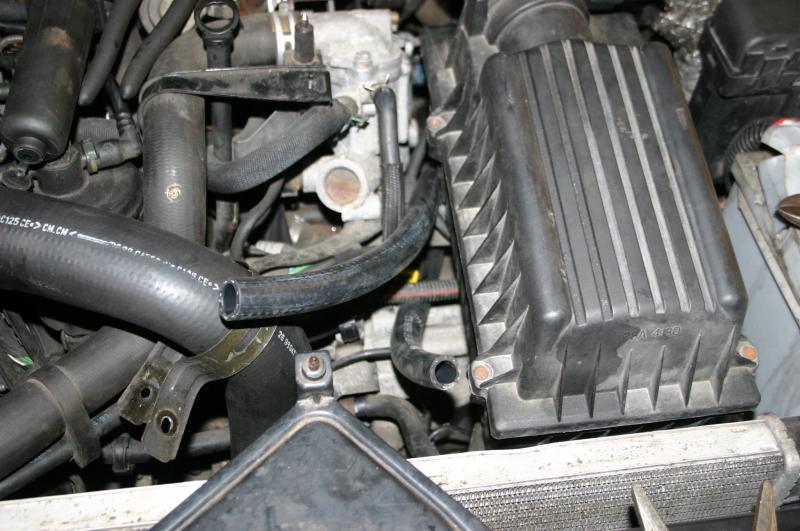

I took the pipe off the thermostat housing and pulled it back to the firewall, where I cut off the final 90 degree bend.

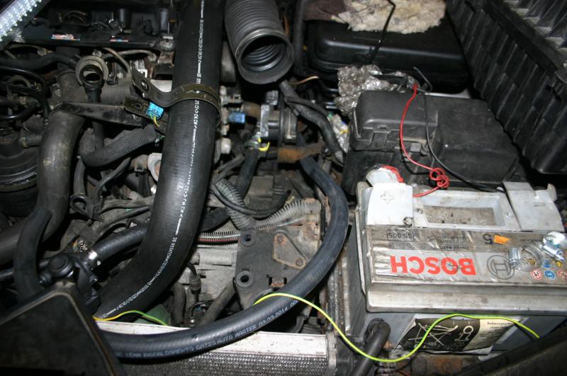

I connected 1m of 16mm hose pipe with a straight connector ( 15mm copper pipe I had lying round) and fed it back through on its original route then under the throttle (using a short piece of longditudinally cut tube to protect the rad tube from chafing on the throttle bracket) I then routed it round the right side of the airfilter box
and over the top of radiator before it turns back on itsself infront of the turbo pipe.
The other pipe about 1/2M I joined to the bend cut off with a straight connector... connected the 90 degree back to the original thermastat housing, although facing forward rather than backwards as it had been, and routed the pipe under a bracket to the side of the engine above the gearbox before it emerges behind the turbo pipe.

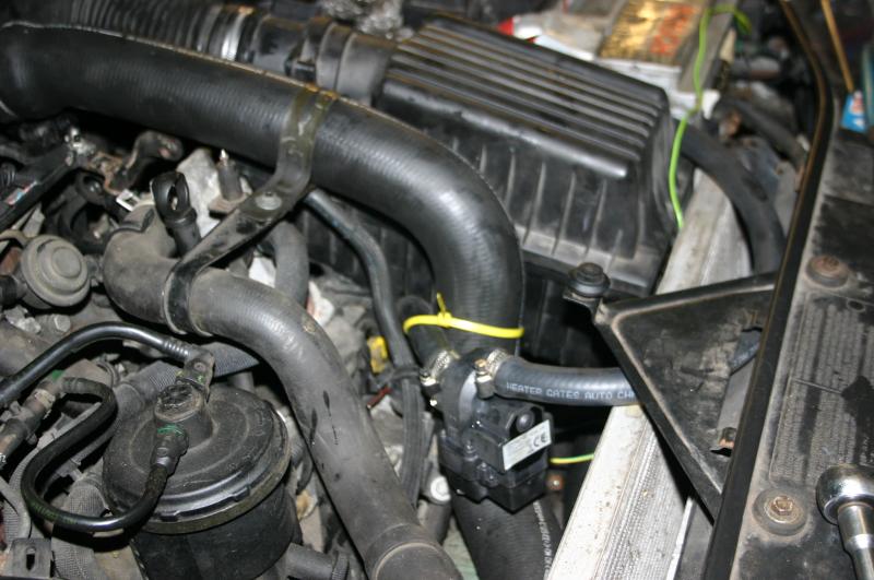

This photo was an early attempt and the pipes were too short but it gives an idea of the route of the 2nd (lower) pipe.

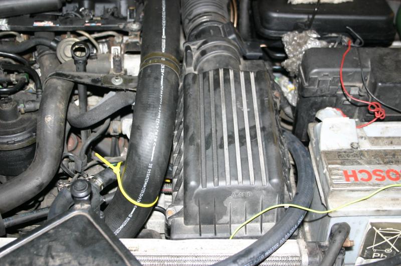

This is the finished article showing the 1st pipe.
And finally I zip tied the preheater to the turbo pipe just to stop it moving too much and to keep it vertical
I haven't tested it yet as I had to run the engine to get all the air out of the system.. but it's supposed to be cold tomorrow morning....

Re: Water preheater- need hose size
That's going to be luxury Chris
KennyW
- Posts: 2614
- Joined: 17 Jan 2006, 21:22
- x 163
Chris,
Very interesting, have you bypassed the water preheater and straight to the matrix?
Kenny
Kenny
