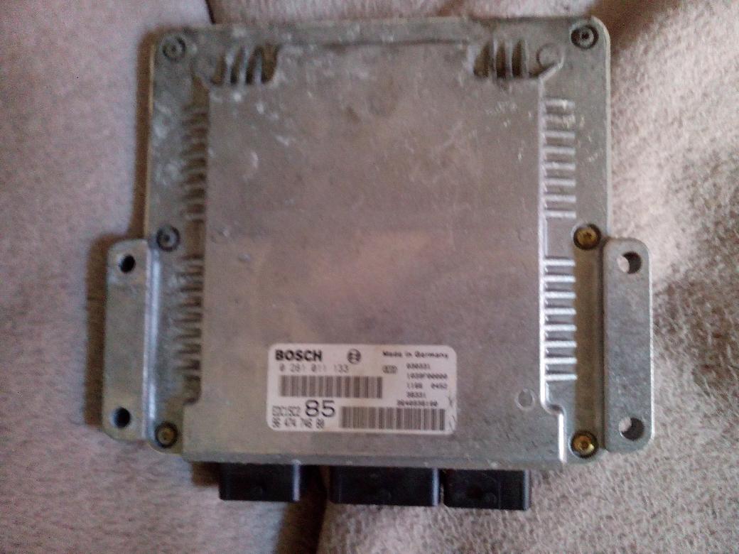

Looks a bit like this: Siemens ECU It should have 3 plugs on the top of it, about 8" or so square and maybe 1-2" thick.
Not sure about the immobiliser light - a key symbol somewhere on the dash?
C8Charlie
- Posts: 30
- Joined: 05 Jul 2014, 01:29
Re: URGENT URGENT HELP NEEDED C8 2.2HDI
Yes mate, have taken that, the fuse box and BSI out now.
Oh, and mine is a Bosch:
