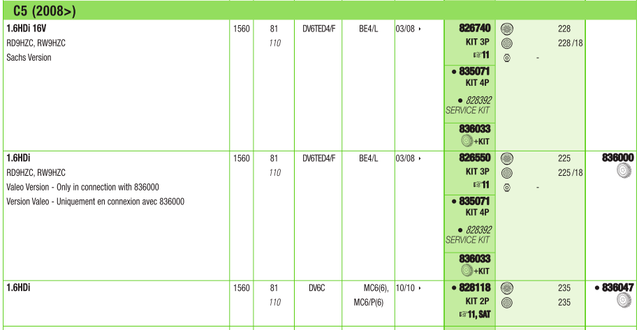

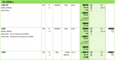

You should be fine for your car, as it lists it for your Model, Engine and Year.
Their brochure doesn't list any 2.0 HDi kits at all for the C5 X7 2008 on - there are only 3 listed and they are all for the 1.6 HDi. So I have to assume from this that there are no compatible ones for my X7.

Its probably early days yet maybe an email to valeo customer services/sales might return a result for the X7
owners. 'vsuk.sales.mailbox@valeo.com' if you include your Vin No, reg number, variant & Version.
what have you got to loose? I think if you scroll down to the bottom of the valeo website page it does say that the list is not exhaustive
and the C5 does seem to be listed in more than one section as you scroll down. maybe we are looking at different lists on different pages.
Update:::: I to have downloaded the catalogue and if you scroll down further there is a 4P clutch kit listed for the C5 2008 onwards
The number is :835071.
hope this helps Marc.
regards.
Nigel

Just replaced the DMF and Clutch on my 2006 C5 1.6 hdi at 111000 miles managed to pickup a new kit of Ebay for £190.00 inc. postage. Also recommend changing the clutch release fork, clutch release folk ball joint and first motion shaft support tube and oil seal. As a preventative measure I have also replace both drive shaft oil seals, the offside drive shaft support bearing, checked both wheel bearings (replaced), checked both bottom steering swivles (replaced) and fitted new front disc's and pads. A friend have a single mass flywheel and clutch fitted to his 2005 1.6 hdi back in November 2016 I when for a drive in it and the vibration was atrosious last month whilst drive in the M1 the engine died he had the car recovered to his home and on stripping it down he found the crankshaft had snapped, bent 8 valves and holed 2 pistons expensive mistake fitting a single mass flywheel?

qprdude wrote:Someone on here enquired about the cost of a replacement solid flywheel and found it was more expensive.
well unable to find a replacement conversion kit to a Single mass flywheel for my 2007 138BHP MK2 C5 Exclusive Hatchback.
I emailed Valeo customer services on Sunday. giving all the necessary information from the reg document Model: variant: reg number:
They replied yesterday, They have a Single Mass Conversion Kit for the 138BHP 2.0l Hdi and the part number is 835069
I looked it up online and the price is £249.00 for the 4 piece kit.
This beats a replacement dual mass flywheel kit including the flywheel by £200.00 then of course we are looking at labour or about £300.00
so current single mass clutch changes for older single mass clutch cars at around £500.00 all in is about right at most garages.
unless of course you plan to do the job yourself.
it is slightly more comforting that Valeo have admitted over time that the dual mass flywheel is a failure to consumers with them failing at around 50-60K.
and have designed the 4p Valeo SMF conversion kit.
I will be giving them a chance especially as I like to be able to tow large four wheeled car transporter trailers.
