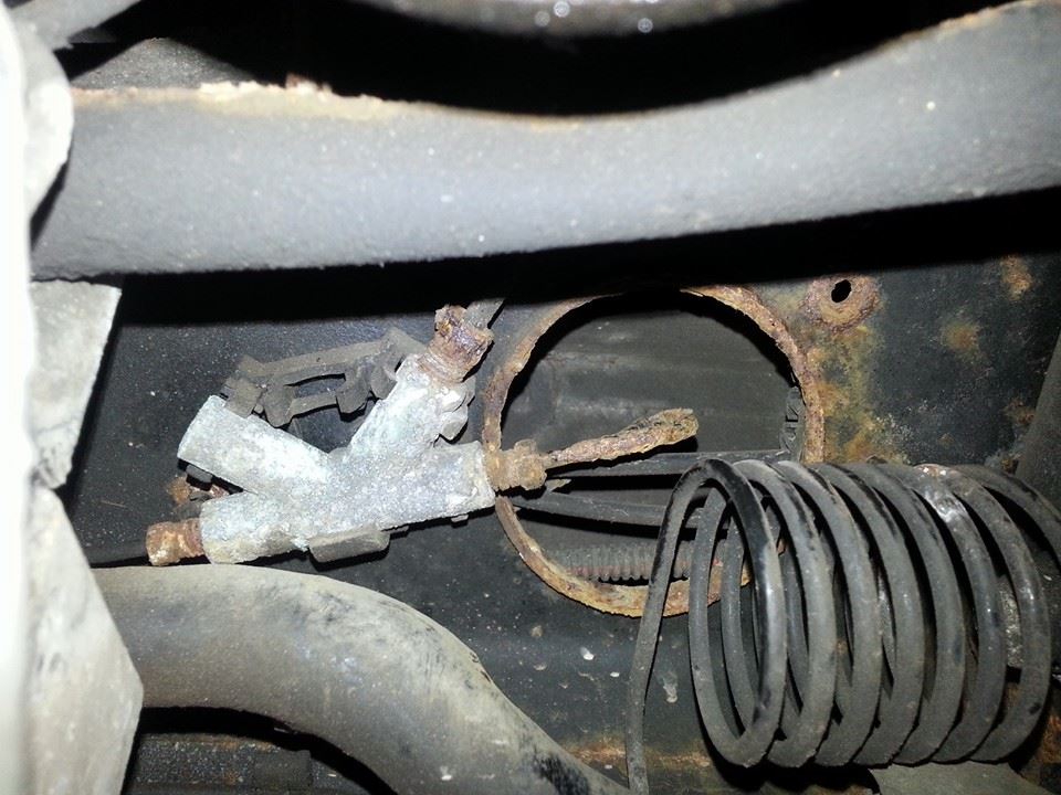

On second inspection, it doesn't look like a brake pipe.
It's the rusty pipe which disappears through the hole in the subframe to the right of the K-piece..
This looks like it might go forward somewhere. The two lines I think are brake pipes are the ones coming from the left hand side of the "straight" bit of the K piece, and the one coming from the right hand side "leg" of the K piece. The rotten pipe comes out the right hand side of the "straight" bit of the K piece and up through the subframe..
Where oh where does it go?

Would comparing against Gracies' pipework help?

That's on the driver's side Richard.
James - no idea. Are they different on hydractive cars?
Sent from my GT-I9300 using Tapatalk

Re: Xantia Slip ring again
In which case I'm pretty sure it's suspension not brakes (the brake splitter being on the NS), and service.citroen shows that pipe as going to the height corrector, so it's a relatively short one. The long one for the suspension comes to the anti-sink valve.
I have no idea, it was just that (if it is a range common pipe) I thought it might help to compare.
The other thing is that it might be possible to do a few hydraulic checks (brakes, height changes) and see if any caused LHM to come out. Then we would have a better idea as to what the pipe did.

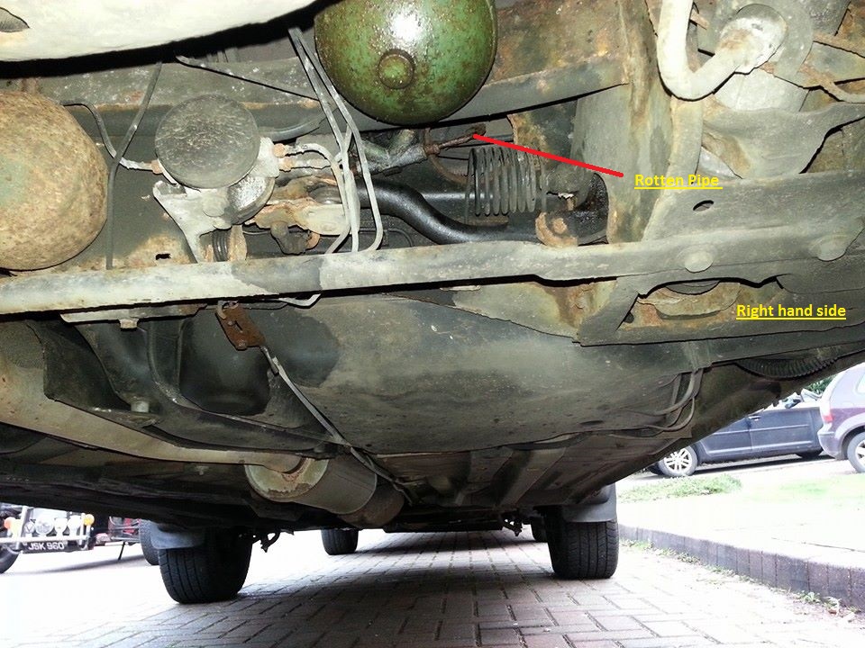

Here is another view of the underneath. You can just see the driver's side rear suspension cylinder on the right of the pic. The K piece is just below the sphere at the top of the pic, and the pipe that needs changing is the dark (soaked in plus-gas) one that disappears through the hole in the subframe.
Removed image - look further down the thread for a labelled version..
so does this mean a sub frame and or tank down jobby Mike
you do know the coiled pipes are the rear brake feeds,
the other pipes to that height corrector look a little festered Mike

Northern_Mike
If it's a subframe out job, the bugger is going on eBay, I'm not messing about with that! Nor do I expect anyone else to. I shall investigate where this pipe goes tomorrow...
From what I can tell, it looks like the brake pipes have been done in the past, as they seem to be in good condition. The ends are horrid - so the original ends were likely reused, but the pipes themselves are generally sound. It's just that one that's bad.
I have just had a look under Gracie, and that 'K' join and pipe is there. I don't know where it goes, but the offer to compare against her still stands.
looking on service citroen with Mikes chassis No.
i cant see a three way/K union at the rear suspension pipe circuit, but there is one for the rear brake feed, Mike can you see were the curly wurly pipes conect to there feed/supply pipe/joint
Item 12? Pipe either goes to the HC or the AS valve (3 or 4) - I can't see any reason why it has to go over the top of the subframe - just go via the shortest route. I think this is the pipe that Chris is having trouble with on his as well http://www.frenchcarforum.co.uk/forum/v ... =3&t=47780" onclick="window.open(this.href);return false;
