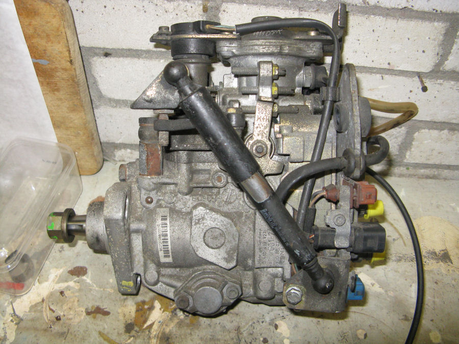

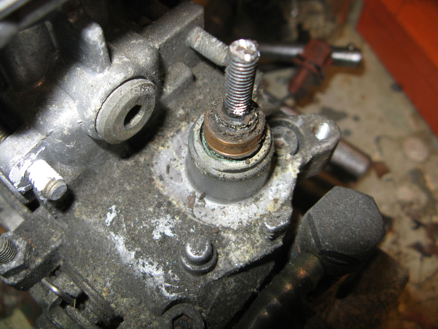

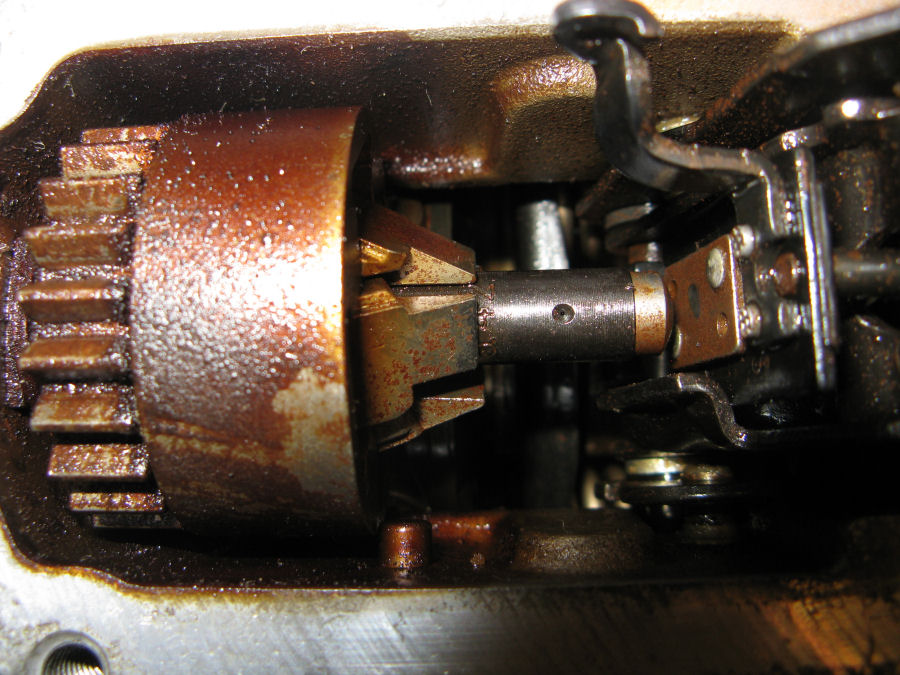

I received the second hand dieselpump today. Supposedly it had rund 127.000 km only.
Inspecting it I saw no signs of leakage. I saw that one side of the pump was rather weathered, the engine side was relatively clean.
The armoured plate did not come off so easy as the other one. Using the Dremel to make cuts to use a screwdriver to take them out, did not work this time. I had to resort to heavy grinding with a 125 mm disc. A lot of work and swearing was required. The workbench and garage was full with irondust. After some cleaning up of the workspace I started to disassemble it. First the upper cover. I noticed that everything was very brown inside. The Acelerator assembly inside was very brown. I believe it is not rust, but rather thickened residue of the diesel that had been there so long. Also the regulator (? With the Watt type mechanism), was very brown. The axle inside this, which should slide in and out was stuck. I pushed the leaver against it, and then it finally began to move.
Below in the HP department everything is brown too. I started to wonder if this piece of 200 Euros was going to extend the life of my Xantia for another 100.000 kms. I started to get afraid of the possibility that everything was just sticky and not going to work. I really need to get my car going before the weekend starts (or otherwise the wife is going to do irresponsible things). Therefor I am contemplating of using the Distribution Head with Nozles and HP Plunger and put it in my original Dieselpump. I could also only take the plunger but I am afraid of the fit in between the head and the plunger.
Question: Knowing the the pump has the exact same number is it possible and wise to take the Distribution Head and pass it over to my original one, considering the state of the secondhand pump?

JIm,
You can change over but why not replace the distributor shaft between the 2 pumps.
Obviously make sure all the bits are there.
Citrojim will be able to confirm.

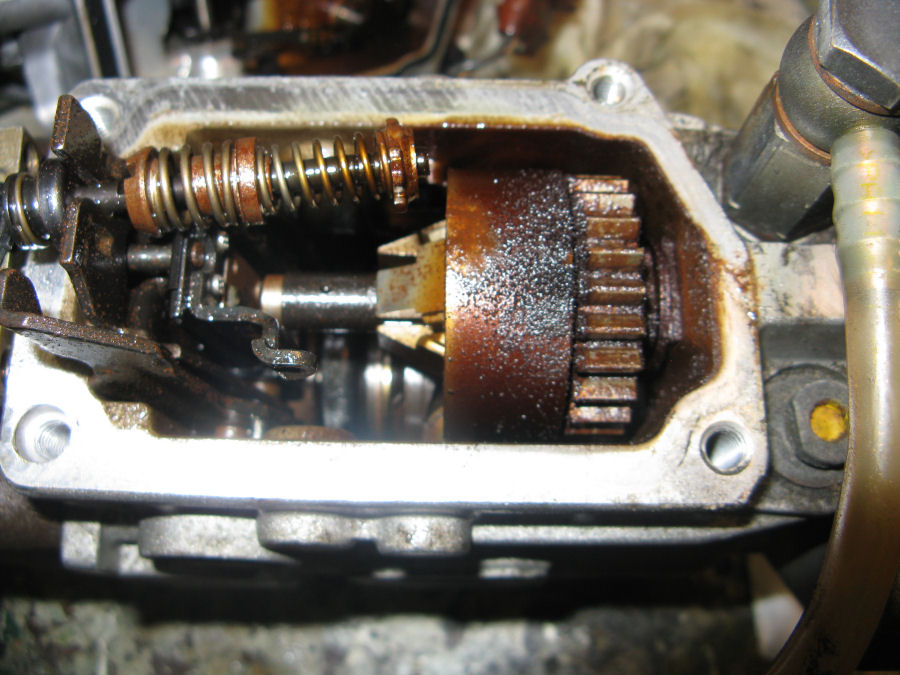

Jim, here are some photos from my rebuild of the Distributor head area.
When i was refitting the head to the pump I think I used a small amount of grease to hold the 2 springs in place.
Once fitted and pump ready to fit back into the car,I did manually test the pump by turning it by hand in the vice. I'm sure I used LHM fluid for the test. If the pump is working it will fire a small jet of fluid at least 1.80m (6 feet) across the garage.
I am sure other members will confirm if it is LHM is the right fluid to use.
Re your photos, could this pump have been using veggie oil?
Good luck
Kenny

Hello Kenny,
I have moved the Distribution Head, Plunger Shaft and the big Ring from the second hand dieselpump to my original dieselpump. I have tested if I can rotate the pump via the sprocket. Via the homemade pulley extractor device I was able to do this. I am fitting it now into my car. I watched several videos on how to reassemble the distribution head. I have put my grease pot in the freezer to have some heavy grease to be sure that the little springs that go into the Distribution Head stay in place. Still it is a bit like the freezer door closing: when it is closed you are not sure that the light is really off. Since I had the upper cover off, I could peek into the distribution head area, but you can not really see if everything is all in place. Grease will have to work for you to keep the parts in place. There is the little spacer between the disc and the plunger, which had my worries. During the job I meticulously used compressed air to clean every part of any dust.
I am fitting the pump back into the car. Maybe I will do the check inside the car, with real diesel and a cloth.

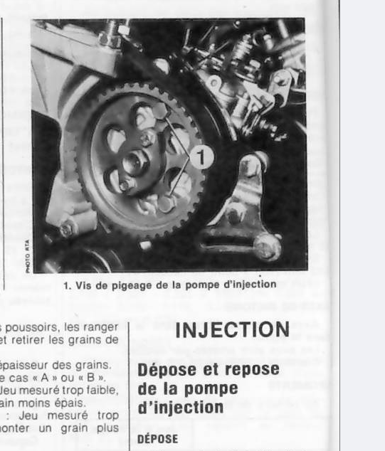

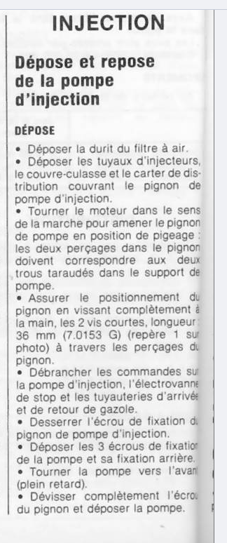

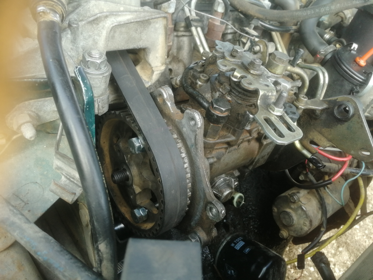

Hi guys, bringing an old topic from the dead.
Today I was trying to remove Bosch VE pump from Peugeot 205 diesel, 1995 to change some leaking seals.
I unscrewed the 4 nuts of the pump, the pump shaft nut, fixed the pulley in place with 2 M8 bolts and removed all that was necessary according to the instructions in the manual, however I can't remove the pump.
It moves freely back and forth, and moved around 2 mm in direction of removal but something is holding it back, I think I'm missing something.
Manual is in French, but with Deepl image translation I get a pretty accurate result.
Thanks for any advice.
