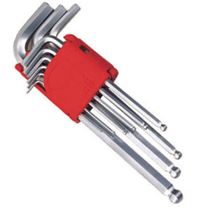

What about an actual Allen key (instead of an allen key bit for a ratchet) with a really long shank ? You can get Allen keys in that size that have a 100mm or longer shank, and then slip a bit of tube over it for more leverage...something like this:
Or this:
Find one with the right depth to clear the housing next to the plug then you'll have a lot more room to swing it.

Good Ideas Simon.. something like this could be the good for the job maybe:
http://www.ebay.co.uk/itm/Ball-End-Hexa ... 3f26573df4" onclick="window.open(this.href);return false;
Will check around to see if I can get one over here.

You slip a ring spanner over the hex bit shank.
If it's really that inaccessible, replace the bolt for a regular headed item.

Tried something similar with trying to use my long angled hose ring pliers to keep the hex bit in place whilst I took the ratchet off, but it didn't work... certainly not enough of the hex bit for the ring spanner to be far enough away from the other metal brackets there.

1) get an Allen key a similar size to how it is currently with the ratchet, which would give more room to rotate, or, hoping the angle for the ball end is sufficient for reaching the bolt and turning it.
2) get an Allen socket bit with a longer Allen shaft on it, and a shorter round shaft, this would allow me to get it on the bolt, I could then use the ratchet on "free spin" mode and use a spanner to turn the Allen key. So the ratchet is only used to hold the bit in place.
