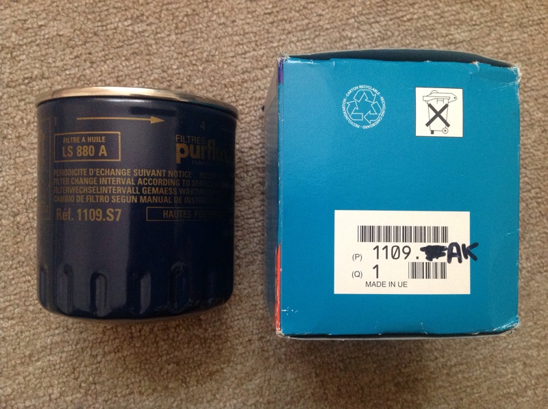

Argh, my oil filter just arrived and it is not as advertised :evil:
Here was the listing:
http://www.ebay.co.uk/itm/350535794807" onclick="window.open(this.href);return false;
It clearly shows an 1109AK with genuine packaging in the photo, but here is what arrived:
An 1109.S7, with a hastily crossed out number on the box!
Does anyone know what the difference is and whether I should be sending it back ? I know that people sometimes supply the smaller filter instead of the larger one for the V6, if this is the smaller one I don't want it, as I have the correct type on at the moment...

Hmm according to the Purflux website LS880A is in fact their recommended filter for the 3.0 V6, and is 13mm longer than the LS867B listed for all other Xantias. So I might have been fretting over nothing. :oops:
It will be interesting to see what the code is on the filter on the car, perhaps the one on there now is the wrong one, or is slightly different but equivalent...

Mandrake wrote:Hmm according to the Purflux website LS880A is in fact their recommended filter for the 3.0 V6, and is 13mm longer than the LS867B listed for all other Xantias. So I might have been fretting over nothing. :oops:
Depending on manufacturer they come in all sorts of various sizes. As long as they are the recommended types with appropriate flow rate and bypass pressure they will do the job. I'm always amazed at the size of the filter on my Kangoo when I change it. It's more like a motorbike filter!

That's the right filter Simon :-D You were definitely fretting over nothing. In fact the batch i ought were the same..
The important thing is not to use the little tiddler used on all other Xantias even though they do fit...

CitroJim wrote:The important thing is not to use the little tiddler used on all other Xantias even though they do fit...
The filter that was on the car when I got it was one of the little tiddlers :evil: The one that's on there now that I fitted in June is quite a bit bigger in both dimensions, and it looks like this one I've just got will be the same.
