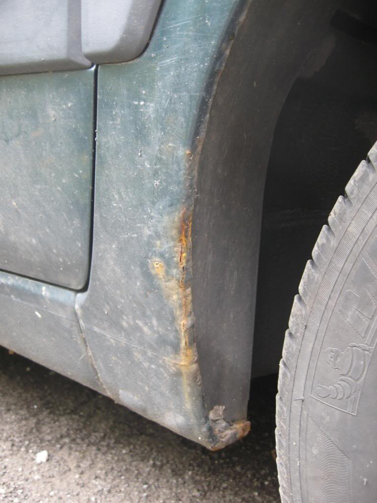

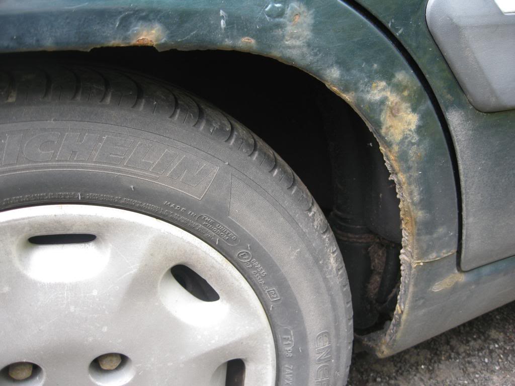

I told chris that id upload some photos of the rust on the car. Might be useful to other owners? we both agreed that the inner wing/underwing L shaped seam/extrusion is a big danger. so here it is...
why they made it that shape to 'scoop up' mud ill never know...
and heres above
That's about 2 inches. Despite the orange bubbles it feels solid so hopefully will be ok.
defo one to watch out for

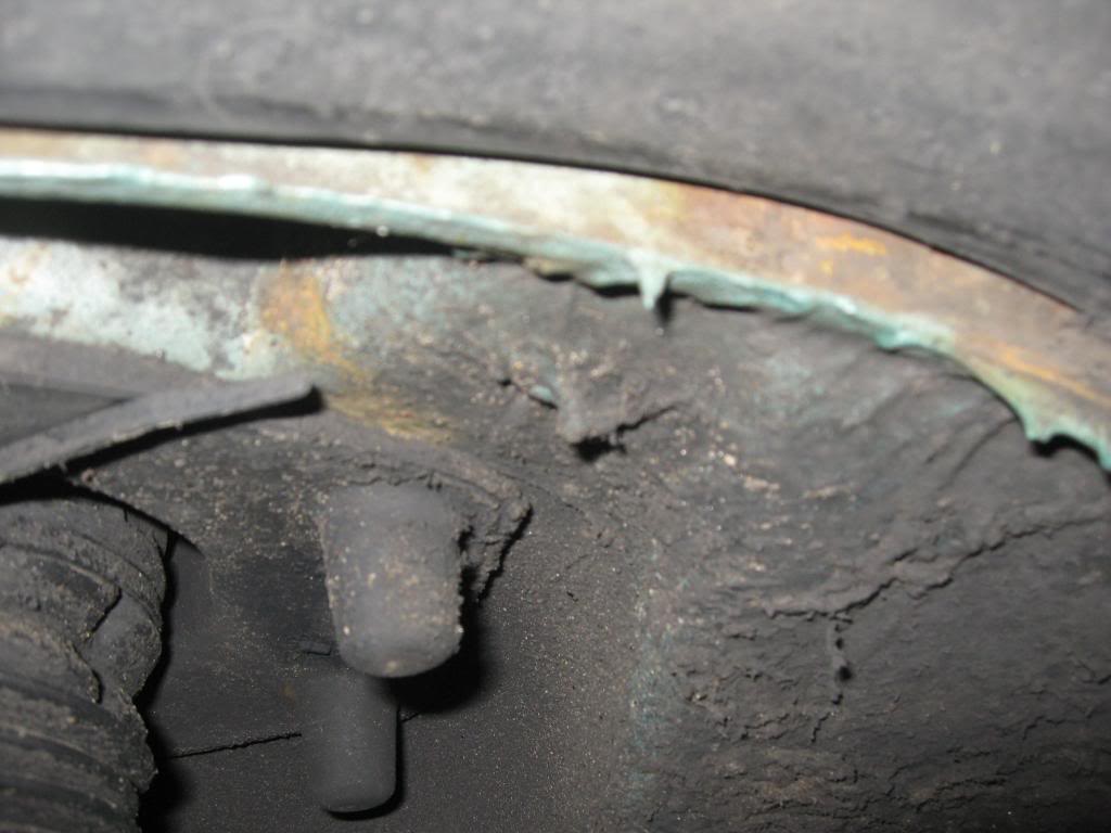

straight through :shock: but notice how its only blown the seam rather than inner wing rust. I cleaned mine out with a tooth brush as soon as I noticed. Problem is you wont notice unless someone tells you or you see the seam go..when its too late!

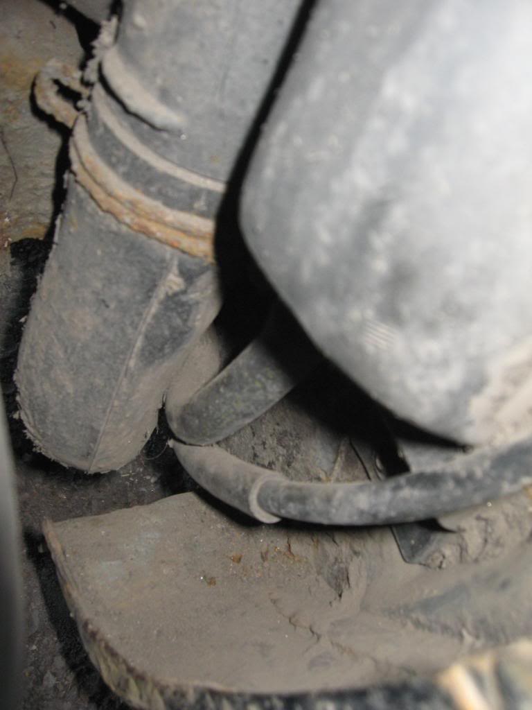

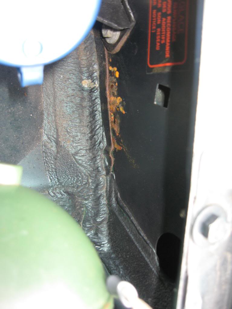

Next the front wing rust trap chris covered in a recent mag. Notice here how the lower lip has rippled/distorted/bubbled. N/s wing much better implying stone chip/paint loss hastened it.

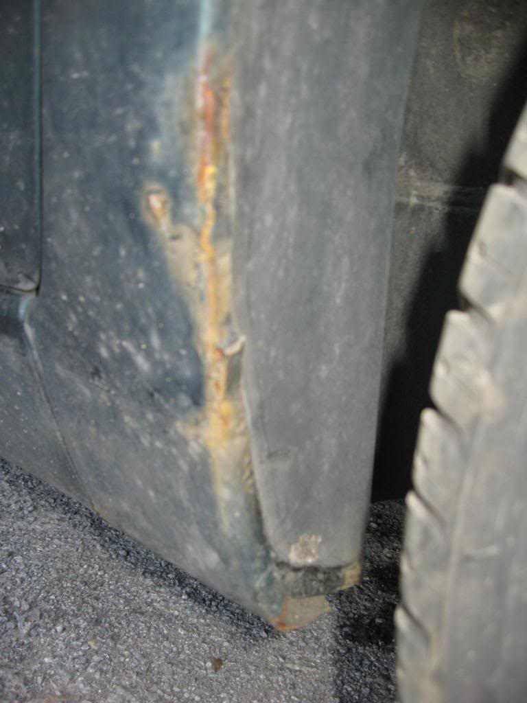

Then rear quarter all caused by the paintloss/chip near the door on the sill. Also the flange on the rear quarter panel itself.
Heres the other side. Note the rippled and rust near the bumper. This was repaired some years ago. hence the rust cant go forward towards the door due to the fiberglass repair. However last year for the mot to get it on the road for the icccr and 20 years of the xantia (the xantia is like the queen so has two birthdays :lol: me and chris decided :wink: :-D ) I had to replace the metal holder for the rear light as that has rusted through...due to the near side rear quarter rust. So it can get pretty bad. Thought it was odd that the light never had condensation in...guess I know why now..
Had a brief look underneath with my mirror and it seems fine bit of surface on the jacking pint that was repaired and on front subframe no doubt due to the underguard being missing. So hoping I can fertan and hammerite it all. I have a plan as you can tell...just need to think the order through..

That is getting a bit scabby in places isn't it Phil, some Xantias seem to last and last and others go a bit frilly around the edges. What is yours like in the common Xantia rust place, the section where the rear wing meets the sill inside the rear door shut? What are the sills like?

The offside rear arch is rusting exactly where you describe as it gone stone chipped and not retouched/left as bare metal (in fact you can see it in the photo- near the door!!). Nearside is better but was accident damaged. Sills bubbly but solid. Again the paint came off- recurring theme here?! My dad catches his feet on them so its probably that. Don't forget inner wing seam as discussed at wetherby. I bought some bx spares so need to get some rust treatment which ill use on the xantia.

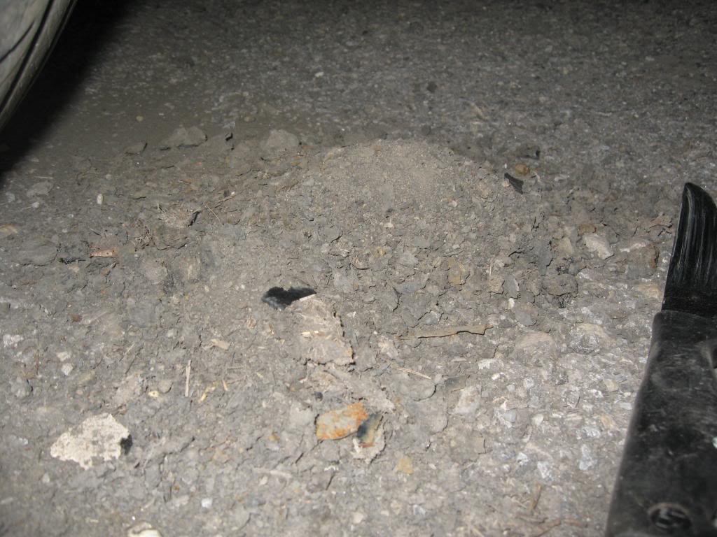

Did some more cleaning today: I took the edge off the front offside wing..with a tooth brush!
Heres the 'damage' and the dust from the front wing, and bits of metal: [nb how the corner has fallen off]
Unfortunately the bolt has sized/rusted so I cant get the wing off. I was able to bend the plastic inner wing up and the inner sill/end looks/feels solid.
heres the dust from the osr quarter. Note the gravel/lumps of stone these had to be hammer and chiselled out! ! the metal feels ok, very solid.
im hoping now ive removed the crap behind the panel may be salvageable..at least for a while. Heres it cleaned:
Did the accident damage nearside a few weeks ago. Then I realised why it had rusted again despite being repaired by 'experts' :evil: Theyd put the inner wing plastic mudguard thingy back without any screws/clips. its literally sat there in the wrong position with a gap of 4cm (yes 4cm) at the door end. So presumably it flaps about in the breeze/when moving and lets water right up. I knew they were sh*t when he said "I cant give you a guarantee coz its l reg"..still parents paid for it I suppose. Also my mum caught the car on the hedge: it created a hole in the nearside rear quarter. you can see the noise reduction foam !
