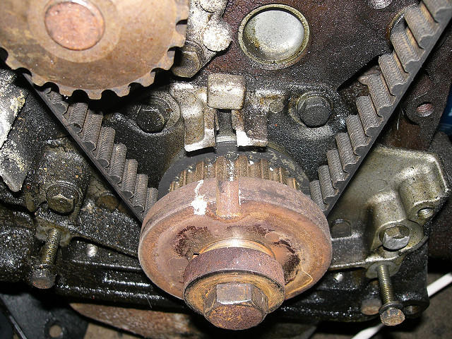

on the 2.0 engines there is a timing mark on the timing belt drive and a marker on the oil seal housing, some others have a locator on the oil seal housing to take a 1/4" section pin, not too sure about the later 16v engines though as i believe they used a different block.
timing belt change4 by Deanxm, on Flickr
D
D

Deanxm wrote:on the 2.0 engines there is a timing mark on the timing belt drive and a marker on the oil seal housing, some others have a locator on the oil seal housing to take a 1/4" section pin, not too sure about the later 16v engines though as i believe they used a different block.
D
Mines a 1.8 8v though!

is the 1.8 8v still an xu block? may well be then and in which case they may be just like the 2.0 8v, forgot yours was 8v.
D
D
