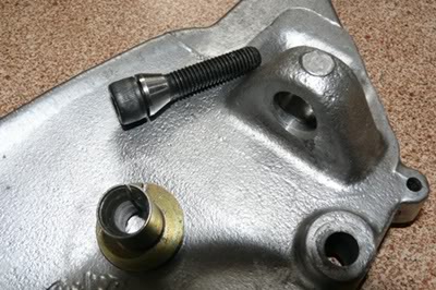

P.s. Back to my earlier dilema of the tapered bolt fitment for the rear pump mounting; I ended up getting a tapered sleeve machined. I tried modifying a few different tapered head bolts from various Peugeot models but nothing was going to give the fit up that was needed. I should have gone straight to the engineering shop in the first place as the time lost mucking around trying to make something fit was such a waste compared to how inexpensive it was to get a new tapered sleeve made up. Here's what it looks like.
