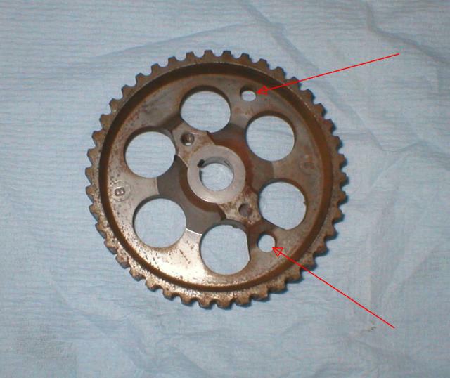

Warren,
In Paul's absence (I'm sure he won't mind) the two holes to use are the plain ones that will take an M8 bolt. I presume the second hole in a spoke you refer to is a tapped one and that's used (with it's opposite number) to attach a special puller to remove the sprocket from the pump taper.
As Paul says, it is absolutely correct that the right timing point is right on one of the pump's compressions.
The two plain holes are in time when one is at around 12 o'clock and the other is at 4 o'clock. In this position, the holes should meet up with tapped M8 holes in the pump cradle. Use two M8 bolts as timing pins and screw them in.
The reason there are two holes in the pump sprocket is so that the pump can be removed without upsetting the cambelt or the timing; the sprocket will 'hang' on the two bolts.
It's the same with the cam sprocket although on that sprocket there is only one plain M8 hole and a corresponding threaded hole in the head at around (I think, if I remember properly) 4 o'clock. I really can't exactly recall but you can't go wrong as there's only one tapped hole in the head that corresponds with the plain hole in the cam sprocket.
Have you found the crank (flywheel) pinning boss and corresponding hole in the flywheel to time and lock the crank?
Crank timing is roughly there when the keyway is at around 10 or 11 o'clock and you can slide a rod (I use a length of kunifer brake pipe) into the pinning hole and into the corresponding hole in the flywheel. The pinning hole boss hides behind the starter motor and is hard to see. Sometimes it is easier to take the starter motor out if you are not familiar with where it is.

Single holes, lines up at around 4 o clock...
Anyone got a Pump Pully picture???? Should help this along!
Bosch OR Lucas, it does not matter, as both Pully to Back Plate positions are identical! The pumps ARE timed different, but this is done by the positioning of the pump. Not the pullys...
Paul
Paul

IF you are NOT removing the pump, theres no need to put both bolts in, just one, and in either hole too...
Sounds like your dooing well!
Paul
