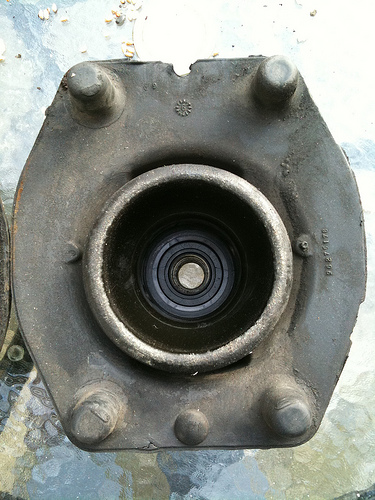

Hi all,
Just got the strut top from wosley now, and the pipes DO fit, whats different is the seating for the top of the strut , plus the hole is bigger.
So it must be a different strut. On the listing they did specify the wrong part number in the q/a section and the part was for a series 1 V6.
So there we go, that is the difference, different struts on the V6. Will be returning it and going to get a new one from citroen. Blast.
citroenxm
Fallen Hero
Posts: 8061
Joined: 30 Dec 2004, 23:10
x 70
Unread post by citroenxm »
Dei
YES The pipes WILL fit, but do they tighten up CORRECTLY!
Is there a step in the union hole were the pipe screws in?? Is the hole DEEPER? Compare it closely to your old top..
If they refuse a return, I WILL buy it off you!
Paul
A very sad...
1994 XM 2.1 d auto
deian
Posts: 1729
Joined: 26 Feb 2006, 10:53
Unread post by deian »
Hi Paul,
The pipe inlets are EXACTLY the same, same depth, same thread and same seating towards the end, they are both chamfered (is that the word? cornered out) ever so slightly on the inside corner and the outside. So exactly identical there.
The holes on the strut top, where the threaded shaft of the actual strut come through are also bigger on the V6 version, they are 20mm wide and on the non-V6 version they are 17mm wide.
As you can see in the pictures below, the seating for the strut/end stop is different on the V6 one.
But if the series 2 has different pipe ends, then this is most definitely for the series 1 V6 as the pipe inlets are identical, and as I understand the v6 mk1 strut top is now a discontinued product.
There are no obvious part numbers to uniquely identify either.

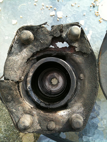

This also shows the difference between a rotten strut top and a better one, the replacement one isn't shiny and new, but it is clean and solid and has been been cleaned with some kind of thinner/petrol.
So if you still want it paul, all i want is my £55 back to help fund the genuine citroen one that i have ordered today, they don't know when it will arrive cos of the weather as it comes from manchesta.
Hope that helps.

:shock: That's impressive tinworm!

Yes I took a top in EXACTLY the same condition off a P 1997 Reg Xantia SX TD with 3.5mm pipes!!
I have it in my shed SOMEWERE! But couldn't find it to show Dei how bad they CAN and DO get - no matter now, he has seen his own.. Im GLAD I showed you Dei!!
