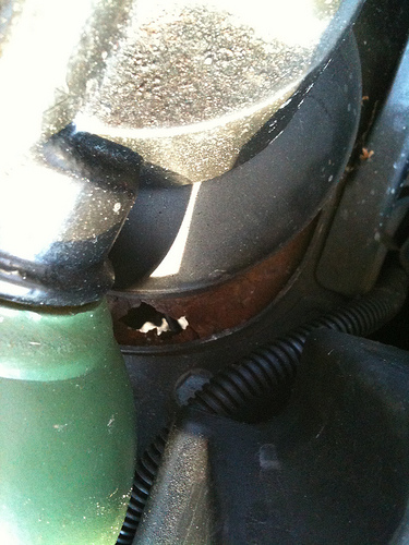

Oh oh!!
Thats after gently prodding with a screw driver, i was scared to go through on the top, so i prodded from the bottom and up comes the screw driver, I thought the creaking wasn't good.
Whats more is, if you wiggle the steering you can see the bloody thing wobble!
Citroenmad
Posts: 8125
Joined: 04 Dec 2008, 22:08
x 110
Unread post by Citroenmad »
I hope your not intending to use your car until you get that strut top replaced, could be dodgy :lol:
Lucky you spotted that though, could have been nasty. :shock:

Well done Dei - better to discover it now (even if it is winter)!
Did my nearside last year, and yes, the screwdriver seems to be the best tool, doesn't it. I was initially drawn to the problem by the way the rubber covering in the wheel arch was separating.
Mine went in more or less the same place as yours, just below the sphere.
I replaced with new Citroen item, using the procedure outlined on the forum, rather than removing everything as per Haynes
