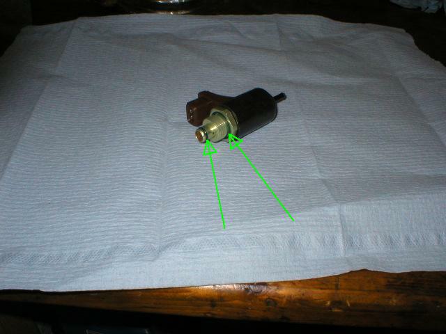

On this picture you posted, presumably the bit above the arrow is the electovalve and the bit below is the sphere body? If so the leaky bit is inbetween the two? Is the leaky bit attached to the body or electrovalve? If the valve I assume just swapping the valve is all you need to do?

It leaks on the big hex. This is made of aluminium alloy and suffers corrosion. The picture below shows an electrovalve on its own with the seals highlighted (the green o rings). Corrosion eats into the hex and eventually exposes a bit of the O ring seal as shown in my original picture.
The valve screws out of the sphere block but normally corrosion holds it tight so when you attempt to unscrew it, the electrovalve body separates and leaves the alloy part in the block, then you need the 24mm deep socket.
This picture shows a disassembled valve and you can see the top part that will screw out of the alloy body.
The two halves are loctited together and normally this allows the whole valve to screw out by unscrewing on the top 16mm hex but if corrosion has really got hold, the loctite will separate before the body does.
Hope that makes it a bit clearer Dom.
