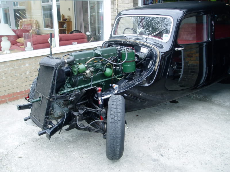

Hi Jim,
Its a Big 6H, well we believe it might be the only RHD hydraulic left in the UK and that only a handful remain world wide. There are a few more LHD hydraulics but very very few RHD as only 74 were ever made, not many exist now. It is a Slough built car, which has a nice history too it as a road research car. It was never a saloon car until my dad bought it, previously it had always been a working car and was in a very bad state when he first got it.
Its running on LHM. It does ride very softly indeed, though its handbrake is a bit of a quirk, as it works on the rear and there being so much suspension movement that you have to be careful with it. Park to close to something and as it settles it will be touching whatever you parked near, or be further away if reversed in. Also when doing hill starts the back end sinks right down onto the stops as you pull away. Hence why Citroen moved it to the front.
Im yet to drive it on the road, so im looking forward to that when its going again, its quite a car i must admit. Ive driven it around feilds at CCC events but not on the roads. Apart from having to double de clutch from 2nd to 1st its very much like driving a modern car.
Its stunning to see how unlike a old car it is, its very quiet on the road, will sit at 70 all day long, the steering is so very accurate. There is no need for the minor adjustments often required in modern cars to keep it in a straight line, its straight and true. Though that does make the steering very heavy, sometimes it takes two of use just to turn the wheel when parking! Its tyre pressures should be somehting like 22 psi front and 19psi rear, though we have them set to around 35 and 30 just to give a bit more ease on the steering.
It has long torsion bars on the front of the 6H to compliment the rear suspension, so it ride well all round. It certainly gets some looks especially with its suspension, as people dont expect it on such an old car.
Ill have to get some better pictues up once its on the road again, hopefully we will have it at some CCC events next year, so you might see it Jim, im sure a ride out wouldnt be out of the question either :lol:
Before its bearing went me and my dad used to go on local classic car runs around the yorkshire moor areas etc. I would drive our old Renault 4 whilst trying to keep up with the traction. It really took some doing, the 4 was not really one for corners, i was asured it would not fall over, though often it did seem like it would, i would just cling to the steering wheel with a huge grin on my face :lol: The traction keeps up with the more sporting things, but the little 4 had to work very hard.
We have three gearboxes for it, our one and two gearboxes borrowed from another traction owner so we have been trying those out previously as ours had problems with selecting gears and reversing on anything other than flat ground.
So we have had the gearbox back to the specialists and hopefully this time it will be fine, though its just a trial and error thing. We will be putting our gearbox and clutch back in, so hopefully the gearbox is ok now.

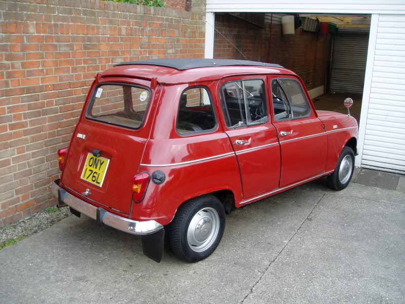

Its a 1972 4 TL Jim, it has the optional huge fabric sunroof, just like a 2cvs, ive never seen this option before or since.
Unfortunately we dont have that any more, that traction picture is two years old, though it looks the same no just minus the rad - until tomorrow.
We bought it in 1997, well i say bought but actually it was free. We overheard someone at a Rolls Royce club meeting (my parents are still in the club even though we no longer have a rolls) saying that they had an R4 which is free to a good home or it will be scrapped. My dad has had 5 R4s and couldnt let one to for scrap.
It had been stood in a garage for 11 years, it only had minor problems really, the main one being that the fual had gone off, it was like someone had filled the fuel lines with silicon which had set, it was like rubber, very odd. It needed a few things doing but didnt take long to get it on the road.
It was in original condition with a low milage of just 54K miles when we got it. It just sneaked into the free tax band on its age so it was very cheap to keep. The interior was sportless, nice black letherlook vinal which was like new, the roof was also in great condition. The body was a little scared in some places but very tidy for its age.
My dad tought me how to drive it that, along farm lanes, around our garden etc at the age of 11, im sure it was just a ploy to get me to put the cars away each night, as its been my job ever since :lol: After i passed my test in 2004 i used to drive it quite a bit, not as my daily car but to classic car events and just have a nice run out in the country on nice days. As i said just a few posts ago me in the R4 and my dad in the traction would do classic car event drives once a month.
We also had another R4 for a few years together with the 72 one. It was a newer GTL on a C reg. That one was white but its owner had a red one previously, which she wrote off. Not liking the plain white R4 she had the doors fitted from the red one, so it was a white car with red doors. Slightly more luxury in the GTL, it has a larger engine, almost 1.1, reversing lights, heated window and a conventional handbrake, unlike the 72s umberella handle :lol:
Very cool little cars in my opinion, i loved the red 72 R4, it always put a huge grin on my face every time i drove it. It gave me a different driving experience. the brakes are obviously poor on older cars, the suspension seemed to let the car corner on its dfoor handles, my dad asured me it would not roll over even if i pushed it, it really did feel like it was going to at times. Huge fun. It was faultlessly reliable too, started on the button every time, even though it could often sit in the garage for months without moving.
A couple of years ago we had been thinking about selling it, as it made parking exceptionally tight having it in the garage, thought we had had it for over 10 years. I squeazed it right over to one side of the garage, though its not really a double width garage and to get access to the tractions garage and get to the rear parking place where i keep all of the cars ment getting past the R4. With a decent sized car like the Xm i literally had less than an inch either side of the doors to squeeze the cars out. So that was the main reason we wanted rid of it.
So one year at the CCC event in weatherby someone expressed an interest in owning an R4, someone else then introduced them to us and he ended up buying the car. We had a whole load of bits for it which went with it, new wings etc. He did fit the new wings and had a lot of paintwork done, though it wasnt a great job as we went down to see it after it was done. Its since been sold again and now lives in Ireland, supposedly its getting a restoration job but im not sure, it would be nice but ive not heard about it since its move over there.
Me and my dad really miss the little R4, almong with the Activa its one of the two cars we wish we still had.

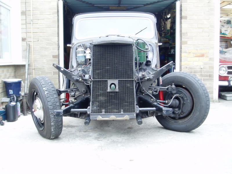

We have got the tractions radiator back on now, filled with coolent and ready to go. It took us a lot of running around to day sourcing some new belts for the dynamo, hydraulic pump and water upmp. As the ones we had didnt quite fit right, so we wanted better ones. Though finding the right sizes and widths isnt easy as many places dont stock them. Anyway we got there in the end.
We had it running for around 30 minutes adjusting the carb and getting it running right. It really does sound very nice, it ran up to temperature fine and didnt get too hot, the clutch works nicely, nice and light and the gears seem very smooth to get. It was the first time in years ive been able to drive it in and out of the garage without having to push it :lol:
We have always had problems with the gearbox on it, mainly with reverse. Tyring to reverse up a hill, slope, gradient or curb would result in a lot of vibrations through the car and very little backwards movement. However it would reverse fine on the flat. The gearbox specialist who rebuilt the gearbox said it could not be the gearbox and must be the clutch. We have tried other clutches which still does the same. Though while its been off the road we have been back to the specialists with the borrowed gearboxes to use them as a test, as they reverse fine when fitted to our car. I think part of the problem was a lack of lay in the gearboxes, the old ones have a lot but ours was very tight. Ive only reversed it into the garage but there is a bit of a lip to get into the garage, before you would have to have a little run up to get in but now you can force the wheels over the bump with the clutch and there is no juddering. So maybe that problem is now fixed.
Another gearbox issue was it sometimes became hard to select gears, though that seems cured now too, ill cross my fingers about the box until its on the road though.
So all is looking good at the moment, we should be doing some more work on it tomorrow, which should hopefully be putting the wings on and grill. A bit of a fiddly job to get them lined up and without damaging them too
