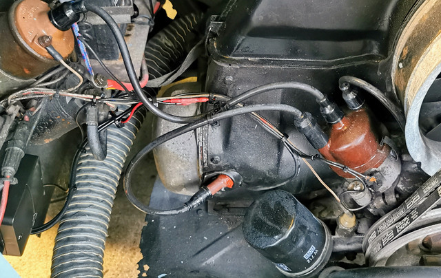

Ignition system will obviously be first port of call. Ignition amp will probably be first on the list as it's something that I can test by substitution really quickly and simply. Distributor will get a good going over obviously, as will a lot of things I imagine!
Nothing huge to report today. Just took the HT leads back off TPA and gave them a clean and wipe down with some silicone spray to help keep the water off.
While I was at it I made a spacer out of a couple of cable ties to keep the lead to the nearside cylinder and the king lead separate. I'm sure I've got some actual spacers from back in my "grab anything not welded down from an old Saab in the scrap yard" days somewhere in the garage, so it'll be replaced with a proper one one day.

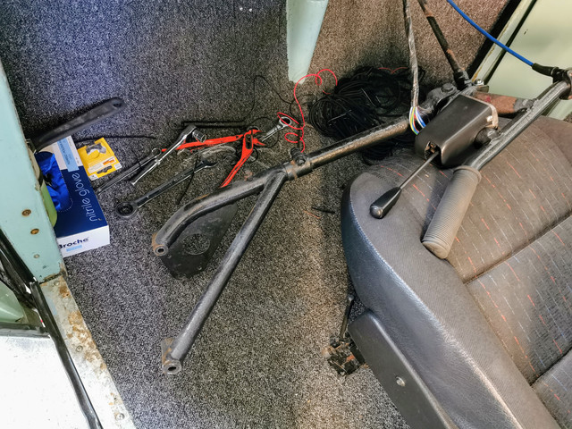

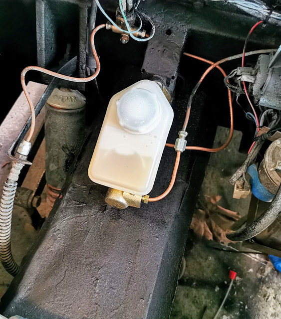

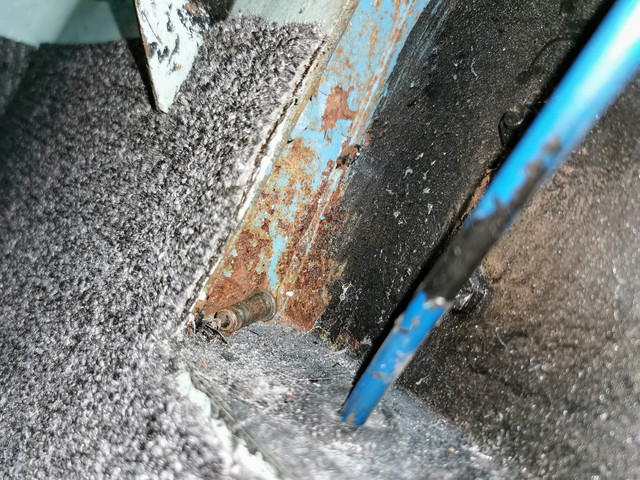

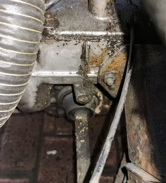

Yesterday afternoon I had a bash at sorting out the ball joints which there was some play in, the worst of which was the one between the steering knuckle and the drag link. Didn't take much work to find that!
It turned out though that there was absolutely nothing wrong with the ball joint...The nut just hadn't been tightened up properly, the clonk was the taper moving against the seat rather than actual play in the joint. I got at least an additional two or three turns on it...Then surprise surprise, there was no play in there any more. Having a closer look revealed that they were all like that with the exception of the one I'd already changed.

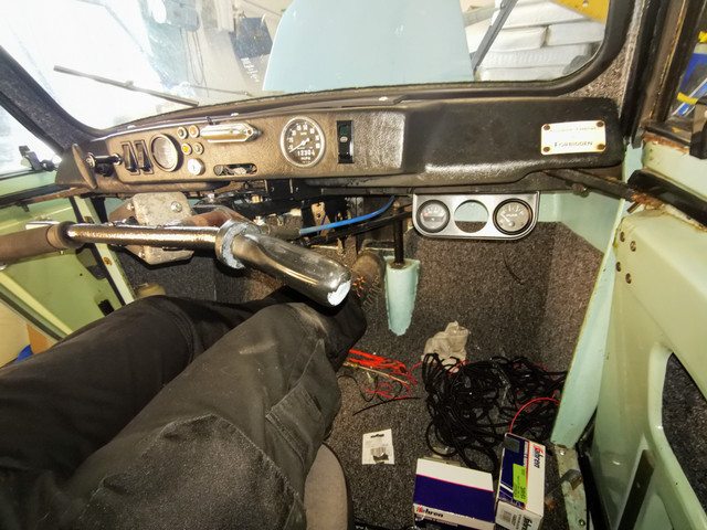

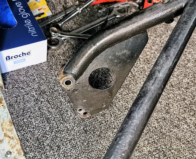

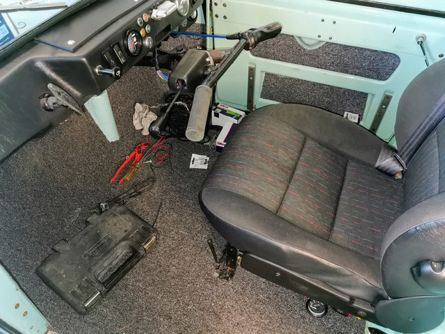

Back to today - I wanted to finish up the work on the brakes. This meant making the adjustment to the brake yoke assembly to account for the different rest position on the new master cylinder. The easiest solution to this I'd figured was to drill a new hole in the yoke slightly further back, and slightly further up to provide a little additional mechanical advantage to account for the fact that the new master cylinder has a slightly wider bore (which in theory would make the brakes heavier to operate), though the other reason for moving upward slightly was to ensure that I stay well clear of the original pivot point, the last thing I wanted was to have a drill slip cause damage to that - plus one of my goals with pretty much any of the improvements or modifications I've been doing should all be things which can be reversed in the future should I/any future owners want to. A blob of weld and a bit of paint will be all that's needed to get rid of this hole if someone was so inclined.
Before I could do that though I needed to get the yoke detached from the car (as the support frame is in the way of where I'd be wanting to drill). You don't actually need to remove the steering tie rod, indicator wiring etc - just these two bolts (one of which required a LOT of effort to initially crack off).
With these out there's enough reach on the wiring and flex in the steering tie rod ball joints to rest the yoke against the seat to work on it.

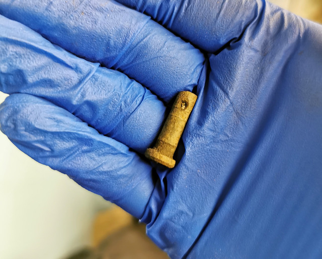

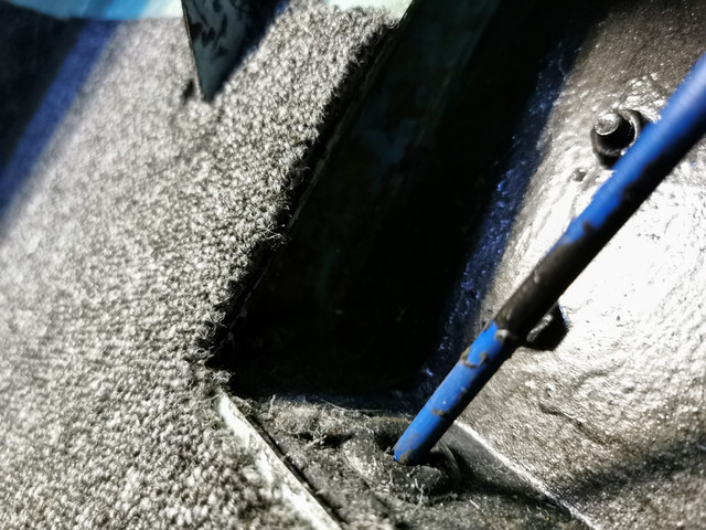

I actually did this the right way for a change, using a centre punch, small pilot drill and progressively drilling out to 8mm (which is pretty much spot on what the original hole was measured at).
Tidying up from doing this and getting ready to reassemble things, I then dropped the pin from the clevis and lost it.
Or rather I *thought* I had dropped the pin and lost it.
Can you see it?
How about now I've turned the flash on?
I wasted the best part of half an hour hunting for that blighter...which I had of course actually put back exactly where I meant to, right next to where I was working.
On the plus side, while crawling around on my hands and knees I *did* find the similar pin which I lost from the gear linkage back when I did the engine swap!
So that's a bonus, I'll get that cleaned up and refitted next time I've got the rear service hatch out.

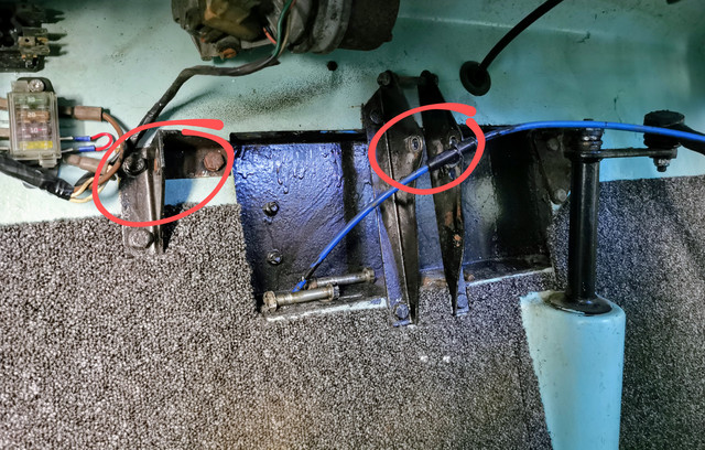

Now I had fully expected getting things back together to be a pain. Having moved the pin forward in the yoke meant that there was no longer clearance to get it into the hole it needed to go into. Eventually a combination of a bit of levering to flex the yoke to one side and loosening the master cylinder off got it in there. It was a bit of a faff, but I knew that going in. This isn't something that you're going to need to remove all that often (hopefully!) so I'm not too bothered that it's a bit fiddly.
With things reassembled I was rewarded by a much more reasonable feeling brake, and after another thorough bleeding session (turns out there was still a lot of air trapped in the front circuit) and we were rewarded with this amount of travel.
Brakes fully released:
Brakes firmly applied:
That looks (and feels) about perfect to me. I can get about another 3/4" if I really hang on it.

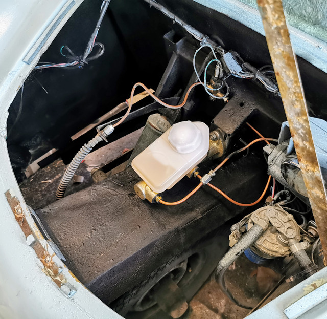

[] Offside rear wheel cylinder replaced (due to seized bleed nipple).
[] Split circuit brake master cylinder (Triumph Spitfire) fitted, requiring slight modification of yoke.

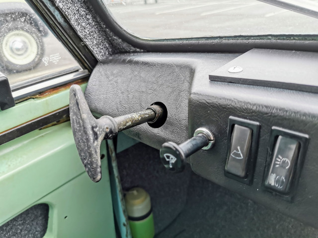

[] Sealed the bungs around both the heater/choke control cables and gear linkage.

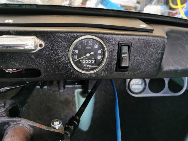

[] Cylinder head temperature gauge installed.

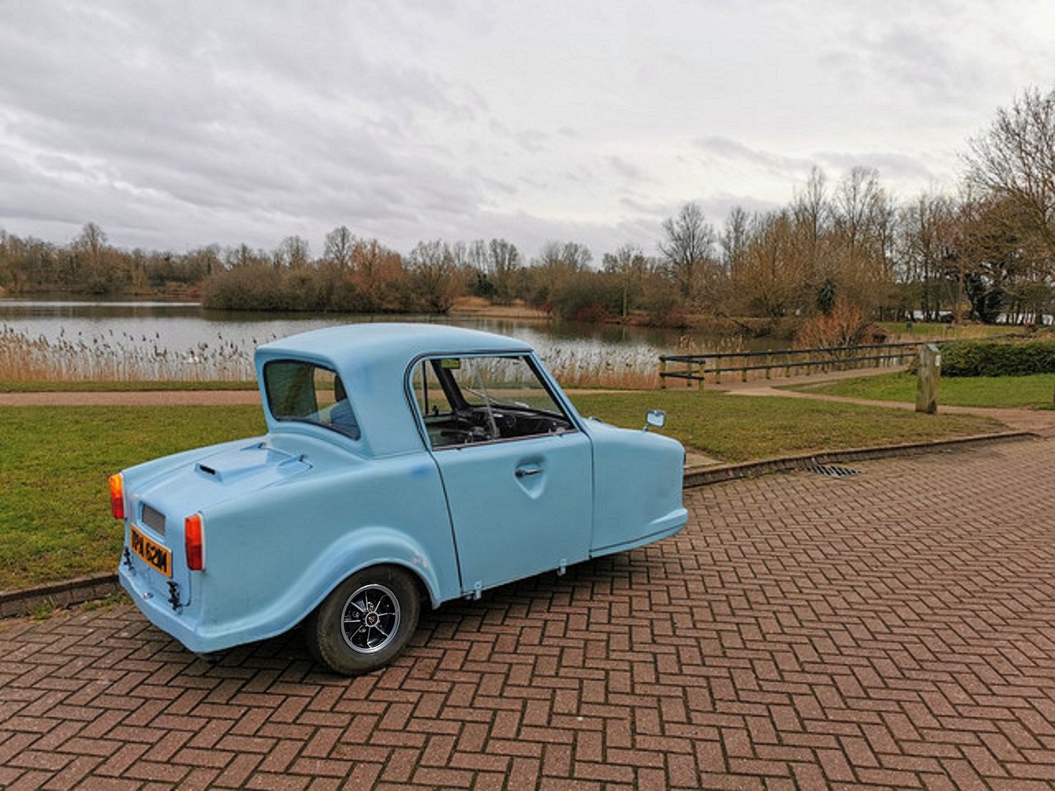

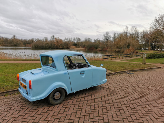

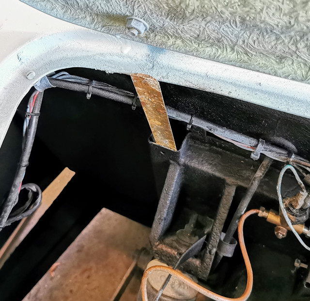

Before I could conduct a test drive of the Invacar (which involved a run out to get essential supplies) I had a couple of minor jobs to finish. Reattaching the front mud guard and draining off a bit of brake fluid as the pressure bleeder as usual left the reservoir too full.
Job done.
Mud guard is still a bit scruffy but given the location I think it's absolutely fine.
Also found an ideal stowage location for my cover prop (which is actually one of the old floor mat retaining strips).
So on to the test drive. Well, after ten minutes of car Tetris anyway. Slightly concerned by whatever on earth this is under the Jag that it left behind when moved.

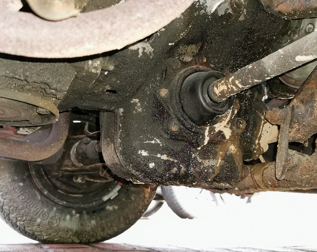

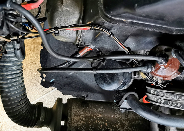

Nothing has visibly dropped, though given the capacity of most of the fluids on this thing that doesn't mean much!

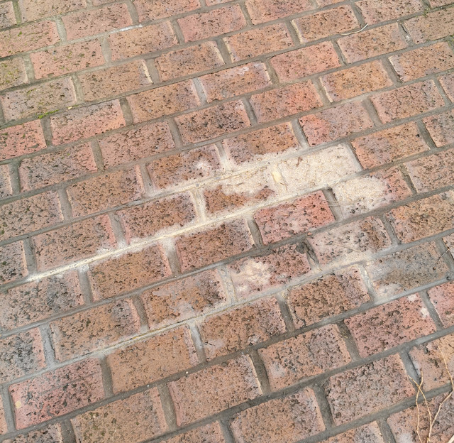

Answers on a post card? Wondering if there's just enough oil leakage that it's emulsified with the recent rain?

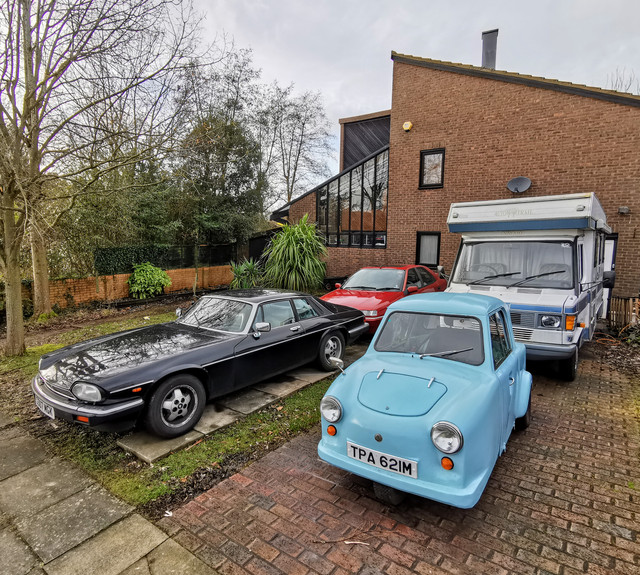

I have proven that there's ample room to park the inbound BX behind the Xantia.
If the Jag and Xantia can fit there, Xantia and a BX should have room to spare.

Really wish I'd done this sooner. The difference in braking performance really is night and day. Previously you had a degree of free travel followed by an inch or so of very firm travel where all braking effort took place.
Now there's more travel - but delivering progressive braking throughout. It used to be just about possible to lock a wheel if you absolutely threw your weight on the bars, but it took a lot of effort. Now I'd say the effort required to deliver that amount of braking force is on par with any other car that doesn't have ABS. The overall feel of the brakes is *massively* more confidence inspiring.
Regarding locking up the wheels that was something I was most concerned about, so one of the first things I did was find a deserted bit of industrial estate and do a bunch of 30mph emergency stop tests. She isn't any more prone to locking up than anything else without ABS, and there doesn't seem to be any tendency for the front to lock up overly easily. I think the forward weight shift under heavy braking helps there. I wasn't able to detect any tendency for control to be compromised at all.

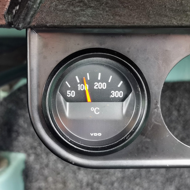

Highest I saw on a long uphill stretch was 165C. Perfectly reasonable numbers, and it seems to be pretty stable.
Interesting to see that - I'm assuming because it's bristling with cooling fins - that this engine doesn't seem to suffer the sort of heat soak issues I'm used to seeing with water cooled engines. The Xantia is particularly bad for that, the temperature on that if you come back to start it up after a brief stop can be quite alarming. This just seems to immediately start dropping in temperature from the moment the engine stops. Which being a thermocouple gauge you can actually see as it's self-powered, so doesn't shut off with the ignition.

Brake fluid level reassuringly hasn't moved at all during the journey.
Glad that fluid is staying where it belongs!

Just a thought Zel, could that stain be from washer fluid which has frozen. Maybe cracked bottle or pipe in the cold? :(
Zelandeth
Posts: 5318
Joined: 16 Nov 2014, 23:36
x 1604
Re: Zel's Fleet Blog - Xantia Activa, Jag XJ-S, Sinclair C5, Mercedes 208D, AC Model 70.
Unread post by Zelandeth »
mickthemaverick wrote: 17 Feb 2021, 06:50 Just a thought Zel, could that stain be from washer fluid which has frozen. Maybe cracked bottle or pipe in the cold? :(
Don't think so...the washer fluid is nearly radioactive looking neon yellow/green...Though I'll check to confirm if it's dropped anyway! Is about the only thing I didn't look at.
