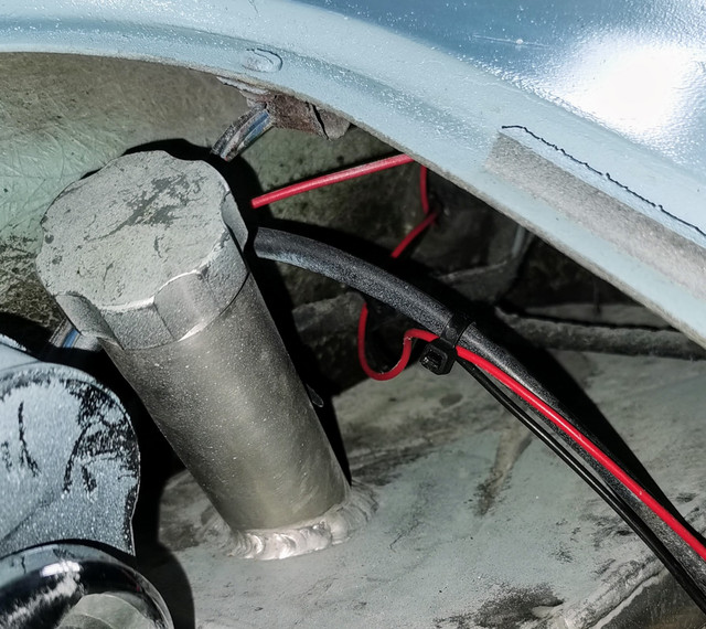

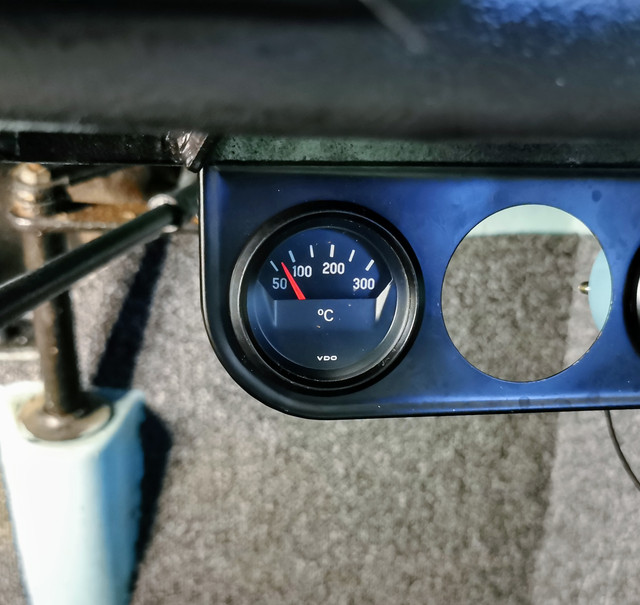

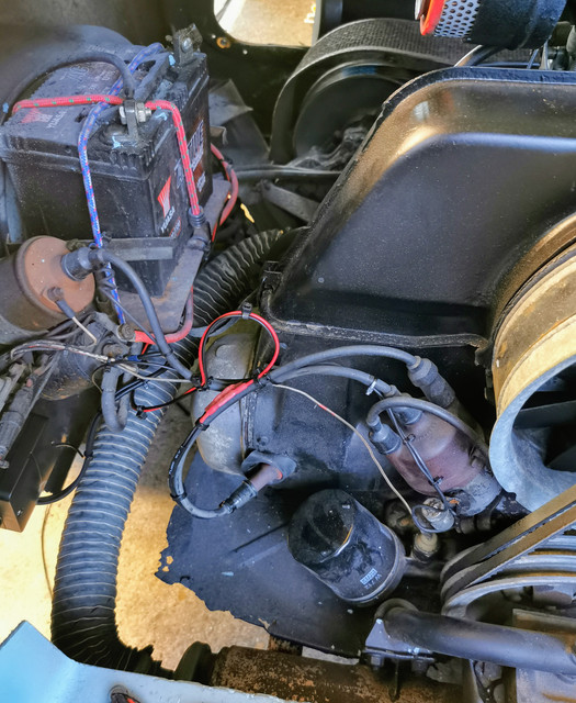

This afternoon it was far, far too cold for anyone with even the slightest shred of common sense to be outside. So of course I was crawling around on the floor in the garage feeding wiring through the car for the temperature gauge in the Invacar.
Fed it all through the car from the gauge end to ensure I had it looped through all the holes and such it needed to go through and to make sure I had enough slack to work with, then hooked up the engine end and started backwards fastening the wiring properly in place working back towards the gauge. The connections to the sender here have been done using those crimp connectors which also have heat-shrink tubing pre-fitted so hopefully should be reasonably weatherproof.
Routed it along the HT leads then jumped to the main loom that runs under the battery tray.
I really need to get around to fabricating a proper battery bracket (the original form factor of battery is now nearly impossible to get hold of unless you want to pay many hundreds of pounds for one) so I can dispense with the bungee cords. It's absolutely going nowhere, but it looks an awful mess.

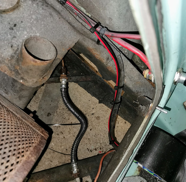

I then continued to follow the main front-rear vehicle loom where it vanishes down under the floor.
It is cable tied to the loom where it passes through grommets in the chassis braces under the floor, before popping back up following the handbrake cable and fuel lines as appropriate before rejoining the loom in this corner. I'd have preferred to follow the main loom all the way up there but that would have required removal of the fuel tank to get to...so we took the long way around.

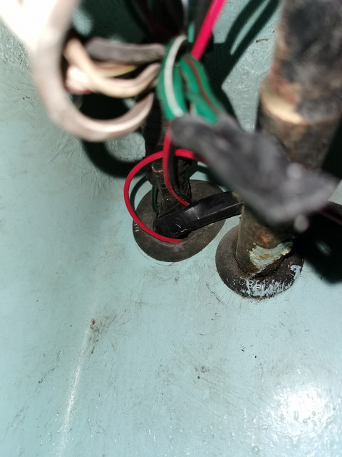

The gauge wiring enters the cabin through the convenient huge wiring grommet just to the left of the handbrake cable.
The pre-existing red wire there is the feed to the fuel pump. I'll be labelling these with cable flags to avoid future confusion...Though the wiring on this thing isn't exactly complex.

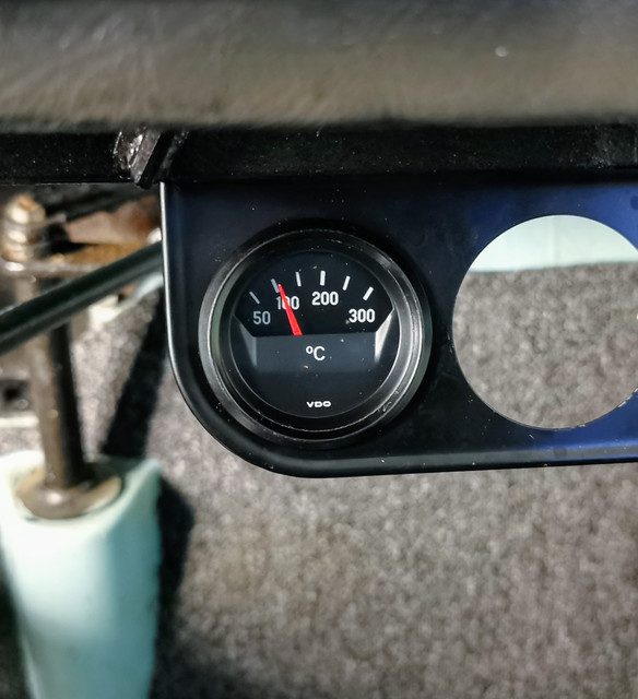

Then I spent about half an hour standing on my head finding a clean and tidy way to route it over behind the dash and hooking it up at the gauge end. Once the engine was fired up we almost immediately confirmed the gauge was working - this photo was taken literally about 30 seconds after the engine started.
If ever you needed a demonstration of how much less thermal mass you have to play with on an air cooled engine, there you go.
After running at a fast idle for about 25 minutes while I put things back together and tidied up the gauge had settled here.
Quite curious to see how it behaves under normal driving conditions...As I've said the actual numbers I'm not particularly worried about really unless they're massively out of the correct ball park, I just want to draw up a picture in my head of what's normal for this car, and it's if we suddenly see a departure from that I know I need to investigate something. It will be interesting to see how scary the numbers I see during sustained high speed driving are though, given that's really not what this car was designed for! Between the size of the oil cooler and the fan though I don't think we should have too much trouble really.

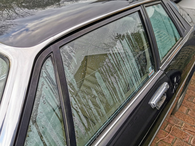

After being on the charger overnight the Jag decided that it would actually start today so I was finally able to rearrange the fleet to all be pointing the same direction. The van being the wrong way around was something I'd been meaning to fix for ages.
Please ignore the Audi in the background...That's nothing to do with me! Especially in grey...Nearly as unfashionable a colour as what I've got on the way...
Annoyingly the interior of the Jag is absolutely soaking wet again.
I think I have sorted most of the major sources of water ingress, though there are still some minor ones. Not least the doors - the weather sheet in both of them is wrecked. I've recently got some thick polythene sheet in stock which should be perfect to make replacements out of. Hopefully that will stop most of this problem. I'm currently waiting on the arrival of a new fan for my dehumidifier...though with it being on a slow boat from China summer will probably get here first. At least I had the sense to take the carpets out when I first saw it was getting damp again though so they're not in there to just act as giant sponges like last time.

Excellent work there Zel though I do have one slight concern. Tied to the HT leads, your guage sensor wire will be subject to induction as the HT pulses generate rapid build and decay of current. The higher the revs the more rapid changes which will alter the inductive interference and possibly affect the readings. It may be a constant effect but I would be aware that increased revs will increase the effect to either boost or subdue the guage reading. I'd suggest routing it away from the HT altogether! :)

I agree with Mick there. I have had a couple of occasions where EPoS equipment has had random failures, and it turned out that all of the cables were bundled together, causing induced interference. Once the cabling was tidied up the failures stopped.

I can't really route it too far away from the HT side of things given that the sensor is bolted around the end of the spark plug...It's a valid point though and I'll definitely keep an eye on it.
I did make a point of ensuring it was only running parallel to the lead rather than wrapping around it to form what would essentially be a current transformer. In theory as the signal + and ground lines are running parallel along that section and induced voltage on the lines should cancel out...in theory. If there was just a signal line on its own I'd be more worried about it causing issues.
It shouldn't be too difficult to do a bit of shuffling around, run it along the oil pressure switch line instead if needed - tethering it to the HT lead just seemed logical at the time given where it's going.
Long term there will be a point where I pull the tinware off the engine properly, when that happens I'll probably reroute it so that the line is inside the cooling shroud - but thanks to how that lot is attached to the engine, it's an engine out job to remove the shroud.
