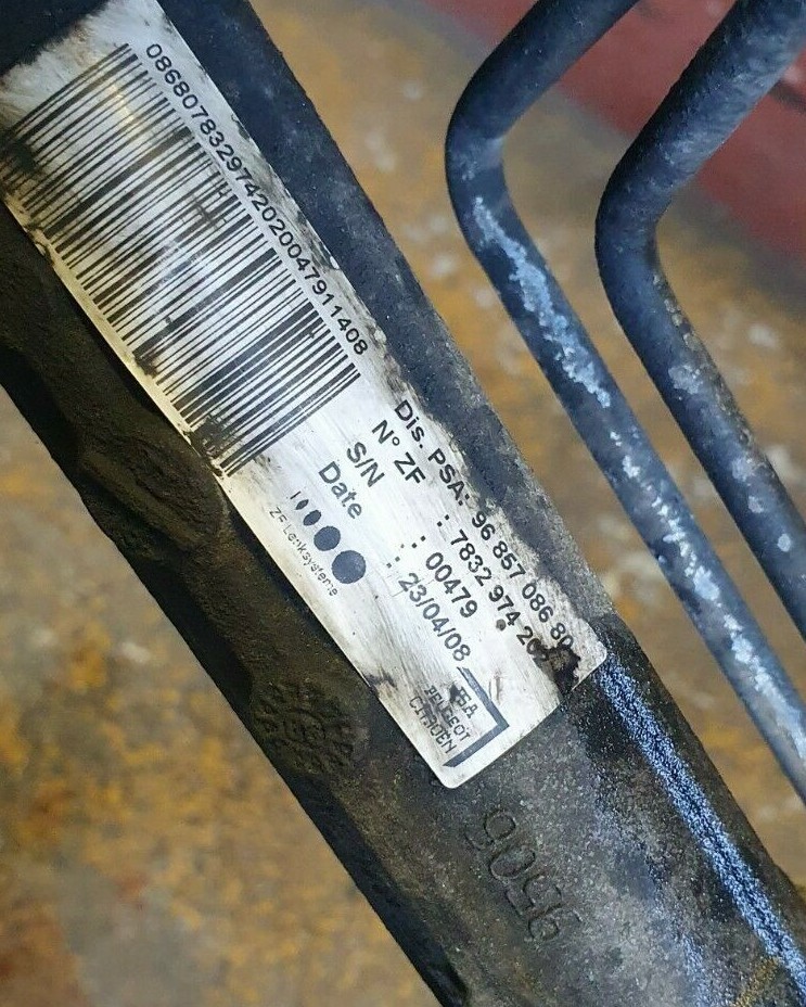

The numbers 9685708680 7832974202 are on the sticker and stamped on the rack so both can't be wrong. Not taking any chances so will leave that one.

PSA’s part numbers are very rarely marked on the components themselves, the numbers found on components are normally the manufacturers part number this will be a ZF (or whoever it is that makes the racks) own part number. The numbers i gave you from the VIN are Citroen’s part numbers for the racks.

Yep, those are the component manufacturers numbers. Like i said citroen very rarely put thier part number on the component itself, the Citroen part no will be on the box or packaging the part comes in. In some cases of parts that cant really be packaged (eg large body panels) you will find the same type of sticky label that you find on the parts boxes stuck on the part.
If you went into a dealers with any of those numbers they wont tie up to looking the part up by VIN.

My question is about the number on the rack I have posted. It looks like a PSA number to me so wasn't sure what Wheeler meant by
Like i said citroen very rarely put their part number on the component itself, the Citroen
as the format of the number is similar.

I understand the confusion as the number on the rack is in a similar format to the (superseded) part number that a citroen dealer parts department would use to order the part. Some part numbers are only 5 digits long but may have much longer numbers printed/ stamped on the component.
