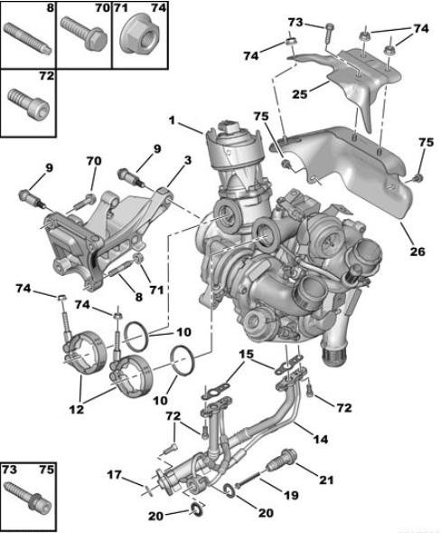

Your Turbo, for which there are no internal parts listed separately James. This engine has 2 fixed geometry turbos, with the first low inertia kicking in at low engine speeds and the second turbo kicks in at 2700 RPM, so collectively covering the entire engine speed range.
0375P1 (new OEM) is £2341.39
An Exchange Turbo is £1987.40
Both the above have an additional refundable surcharge of £260.40 when the old turbo is returned should you go down this route.

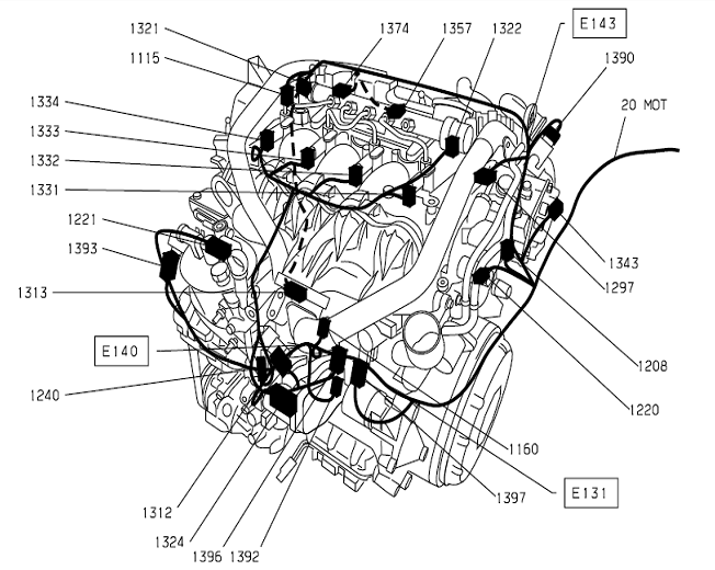

Here are the Injection System Components:

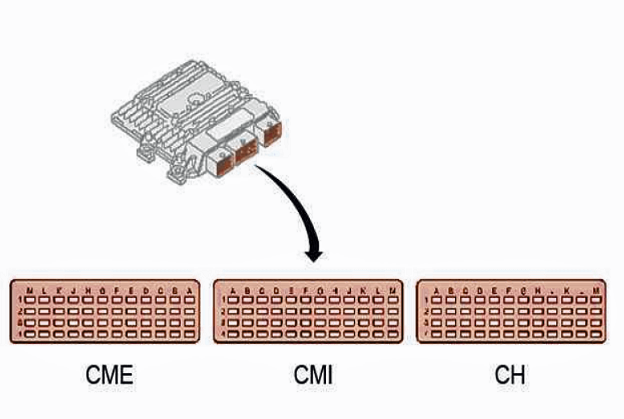

As for the Proportional Electrovalve (VT2) control, you need to be checking on the 48 Pin GREY plug (CME) of the engine ECU as shown below. It is pin E4.
Wire 1446 goes from the VT2 electrovalve (1393) on Pin 2 to Pin E4 of the engine 48 pin Grey ECU CME Plug as noted above.
Here is the location of the electrovalves (1393 in your case):

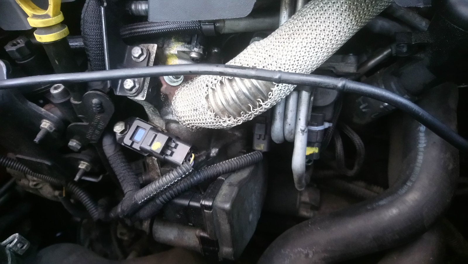

Well, time for a bit of an update, She passed her MoT yesterday (with advisories, which I am now working on), so that is OK. With reference to the turbo issue I found that (on the vacuum control block (or whatever it is called)) the latch moulding for one cable had become deformed, so the latch on the cable plug does not hold it in place. By using a cable tie around the latch clip it is now staying in place. It is safe to say the turbocharger is now fully operative, as her performance has definitely got more spirited, especially when the Sports button has been pressed! Yay! (Oh, and my Lexia went from showing a permanent, unclearable fault to a temporary, clearable one (and running the tests again after it was cleared showed there were no faults found in the Injection section)). Without the diagram from Marc I would not have known where to start looking (as the turbocharger is on the back of the engine and the vacuum control block is on the front!).

That's interesting. Have you got any pics James I know of another 2.2 hdi with a simmilar problem that may be the same thing.Hell Razor5543 wrote: 12 Jan 2022, 06:47 Well, time for a bit of an update, She passed her MoT yesterday (with advisories, which I am now working on), so that is OK. With reference to the turbo issue I found that (on the vacuum control block (or whatever it is called)) the latch moulding for one cable had become deformed, so the latch on the cable plug does not hold in place. By using a cable tie around the latch clip it is now staying in place. It is safe to say the turbocharger is now fully operative, as her performance has definitely got more spirited, especially when the Sports button has been pressed! Yay!

Paul, the vacuum control block is on the front right of the engine, hidden under the second air intake. The plug with the cable tie (behind the three silver pipes) is the one that controls the V2C compensator valve.
