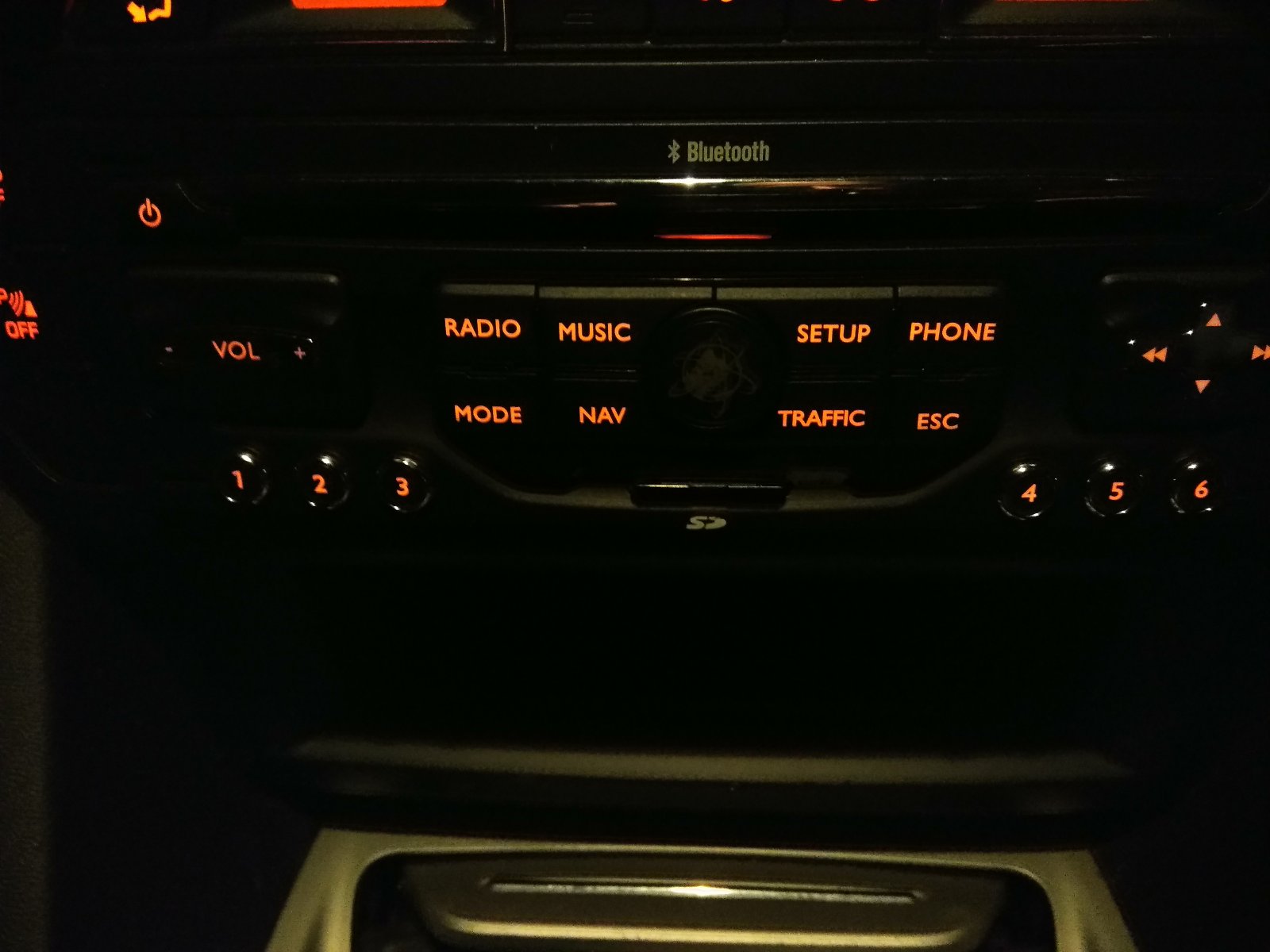

GiveMeABreak wrote: 09 Nov 2017, 16:55 Ok, can you show me the front of the new unit please? I suspect you are trying to replace an RNEG (MyWay) with and RT6 (eMyWay or RNEG2) system. This will help confirm.

Ok, so you are replacing the same unit so have you VIN coded the unit to the BSI? There should not be anything else to do as they are the same units. Don't be tempted to enable any additional options that are there as they won't be relevant to your car and may not mean what you think they do. This can have an adverse effect on the vehicle. Also you should always write down what values are there already - just in case.

Is it damaged, or is this unit from some other model??

Yes it looks like the dial is broken off or missing for a start - you may have been sold a bad replacement that also isn't working...
There's nothing else to code apart from the VIN, as there are no differences in the units.

Thanks for the replies. I really appreciate it. done vin code to stop beeping. additional settings are on/off as per equipment present. I hadn't noticed the central dial until it arrived. Was sold as same C5 year and model. Navigation position, front/rear sensors, radio working. I just can't select menu items. i.e. change time. On the head unit there's up down left and write keys. When I press the down key, rather than moving down one, it jumps a page. If I can get it to move one by one the whole system will work fine. Can lexia change it?

After searching for images of the new head unit ive discovered its used in Citroen c8.
http://www.ewallpapers.eu/63294-citroen-c8.html
The central dial has been removed and replaced by a larger remote on the central console.
Id guess my only option is to try to sell this one and pay more attention finding a replacement. Don't have a clue on how to fit the remote or if it's even possible.

Right - must of been a late C8 as MyWay didn't come into being until 2009. The C5 X7 is a full CAN vehicle, the C8 was available in both VAN-CAN and Full CAN -
so maybe it isn't fully compatible. I must admit I don't ever recall the C8 getting MyWay - I only remember it having RT3 / 4/5 telematics systems....
